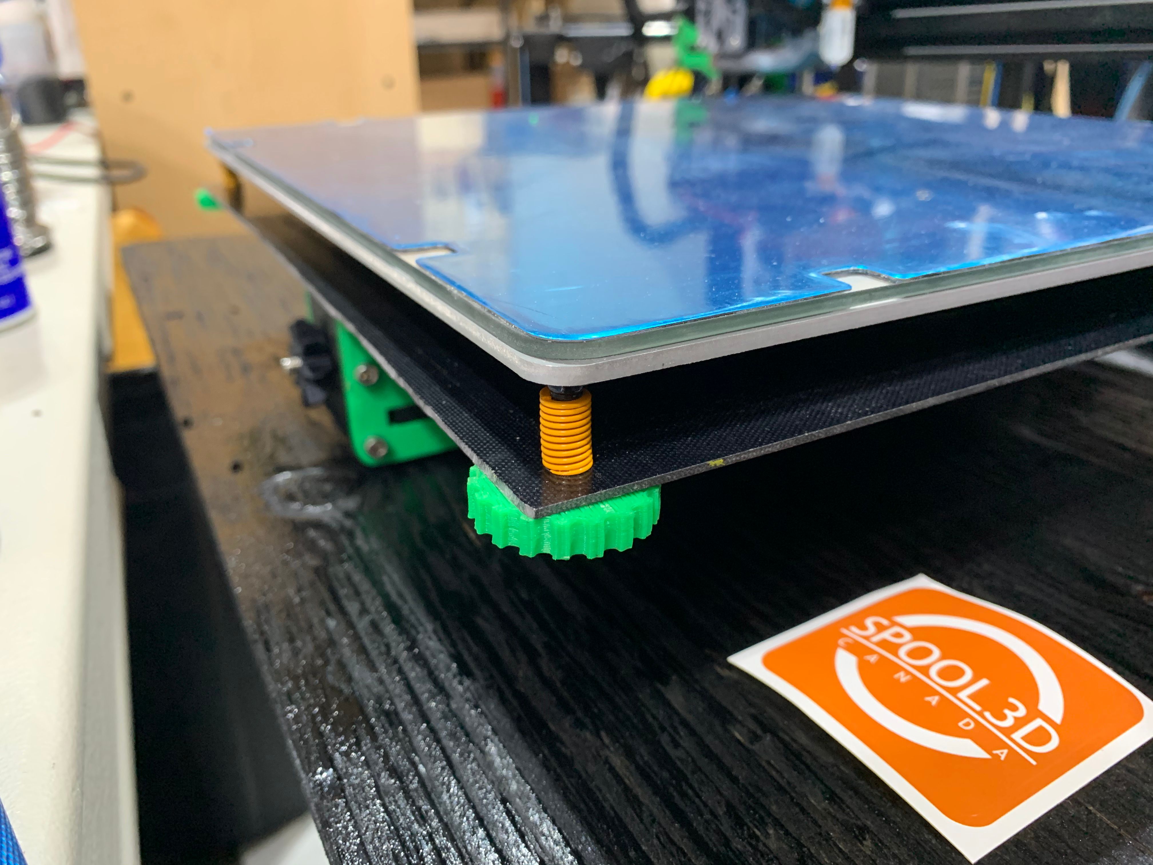

      I bought a filabase kit 400x400 print bed for my Blackwidow Cartesian printer 400x250.
      The new bed is a heavy duty bed and it maybe would better fit for a core XY but the blackwidow is what I have to work with.
      Now to the question..
      I need to make a complete new undercarriage and it will be supported by two linear rails.
      The print bed is heavy so acceleration will need to go down and a new undercarriage should be as light as possible.
      As I see it I have two options, aluminum plate or carbon fiber. In both cases I see that a plate should be cut with profile/holes to reduce weight.
      Will 6 millimeter carbon sheet be as rigid as a 6 mm aluminum sheet or will it flex more...?

        6mm CF twill weave is overkill in my opinion.
        5mm is more than enough. I'm quite certain that 4mm would be enough.
        I'm using 1.5mm G10 on a 300x300 custom made bed with a aluminium bracing underneath and it works fine.

              @Thalios ok thats good feedback, I have no idea so your input is helpfull. May I ask if you have a have a homogeneous board or a weight adjusted one? If you can post a picture it helps.
              • Thaliosundefined
                Thalios
                Actual bed is 330mm. Print area 300x300. It is the Wanhao bed.
