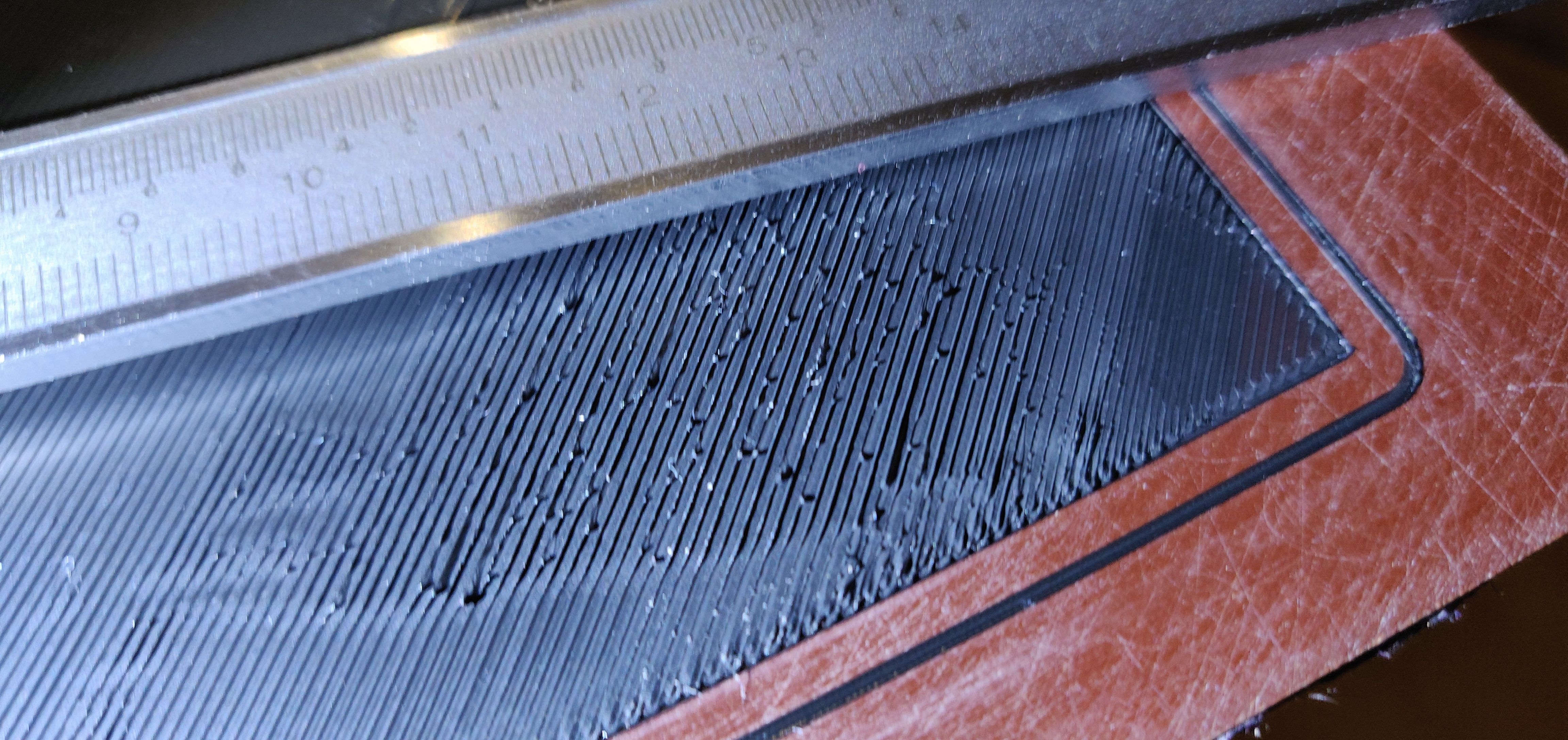

Update:
I went down till 70% till they lines separated. So I went back to 80% and the lines on the X wall where back melted but not so the wall following the Y axes.
I think that I go back to start now and calibrate X and Y first. Blimy! It seems that something is wrong there.
I did it more than 3 times now, I do not understand what's wrong with that peace of Chinese crap. -
Here is what I did:
I placed a needle on the hotend to measure the real driven way to calibrate the steps for x and y. I used 250mm for that. So I was able identify a tiny miss configurationOld:
M92 X80.16 Y80.16 Z400.00 E431.62
New:
M92 X80.14 Y80.00 Z400.00 E431.62
I printed the cube and followed Step 1, I made two pictures trough a magnifying glass. The first picture is from the right Y wall, the second from the left Y wall. Both with 100% extrusion.
I have no other explanation than: "wrong steps for X".
So I printed the XYZ-Cube which came out as
X: 20.07-20.18mm
Y: 20.21-20.25mmThat confirmed my theory, don't you think so?
Is there a better method to calibrate the steps? Needle on the hotend and a steel lineal and the longest possible travel seems to me as the best possible way.
Cheers, Chriss

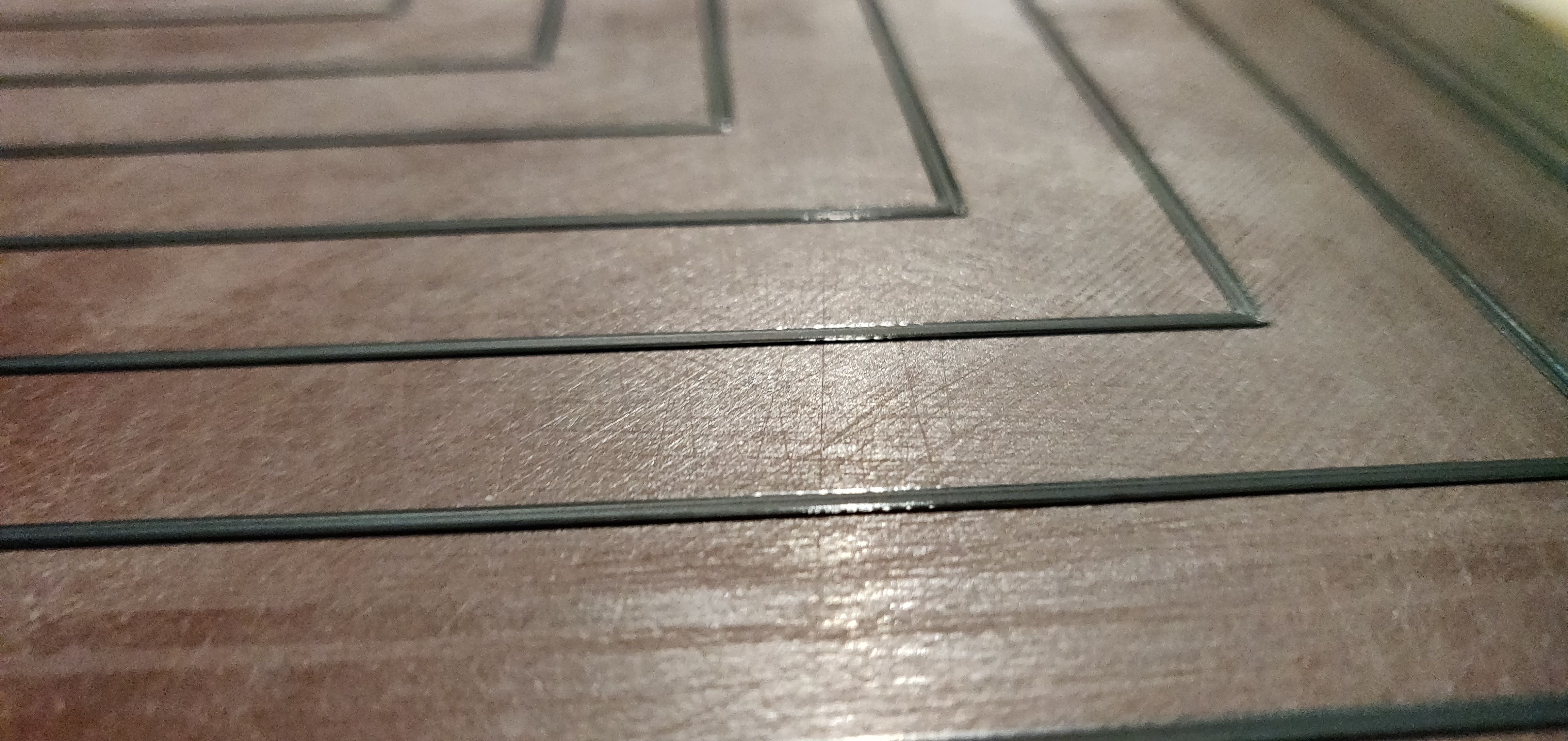

Hi...
So v-slots clean and everything is smooth. Belt tension is fine.
M92 X80.00 Y80.00 Z400.00 E431.62
PLA@210°C 100% Extrusion.
Left Ywall:
Right:
I can see that the gab between the two lines start appearing at the curve from x to y. It seams to me that there outer wall is a tiny bit longer on the X axis. But this do not make sense to me.
I will start with a fresh cura profile now.
Cheers, Chriss

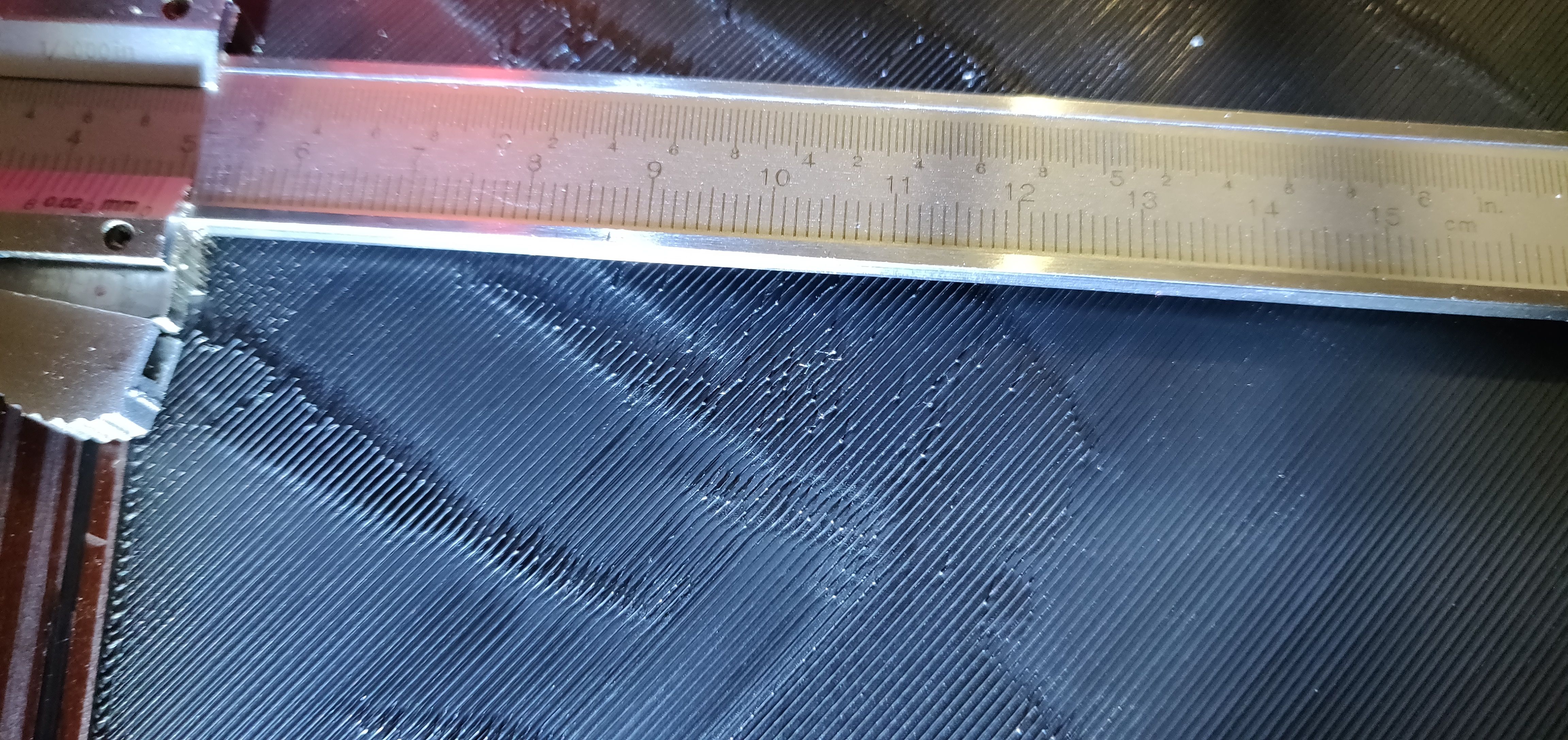

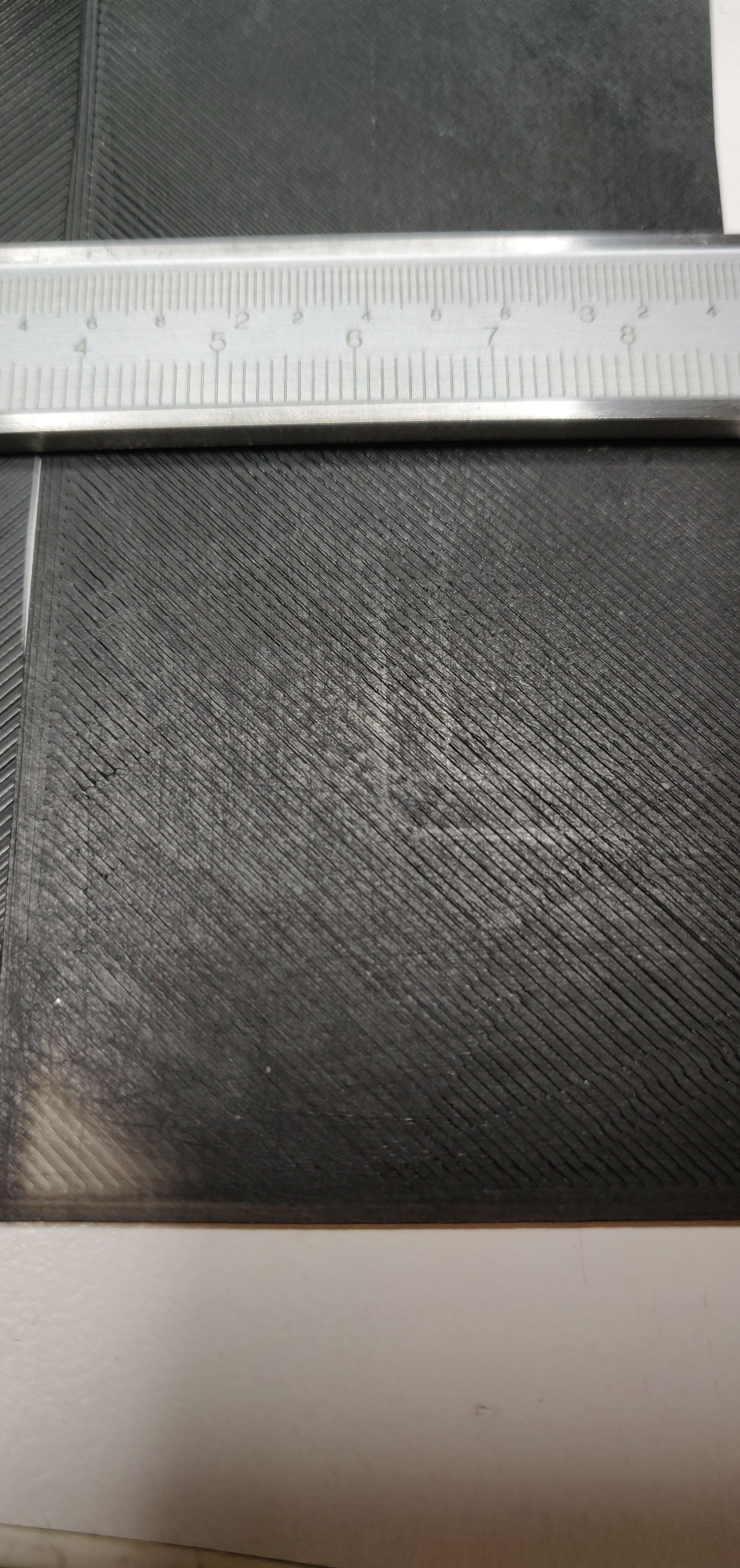

Well, I dialed in my z-offset today, for the nozzle change. I had to lift it 0.1mm, so the Elephant foot has gone now and the smaller cube was easy to remove now. I think that this will be the case with bigger object, too.
I printed a first layer which covered the complete bed. And I saw the ruff first layer appearing at the "max Y - min Y" corner:
Is that caused by an uneven bed? I saw that in the mast from time to time on my PEI sheet, too and I was not able to find the reason for it.
