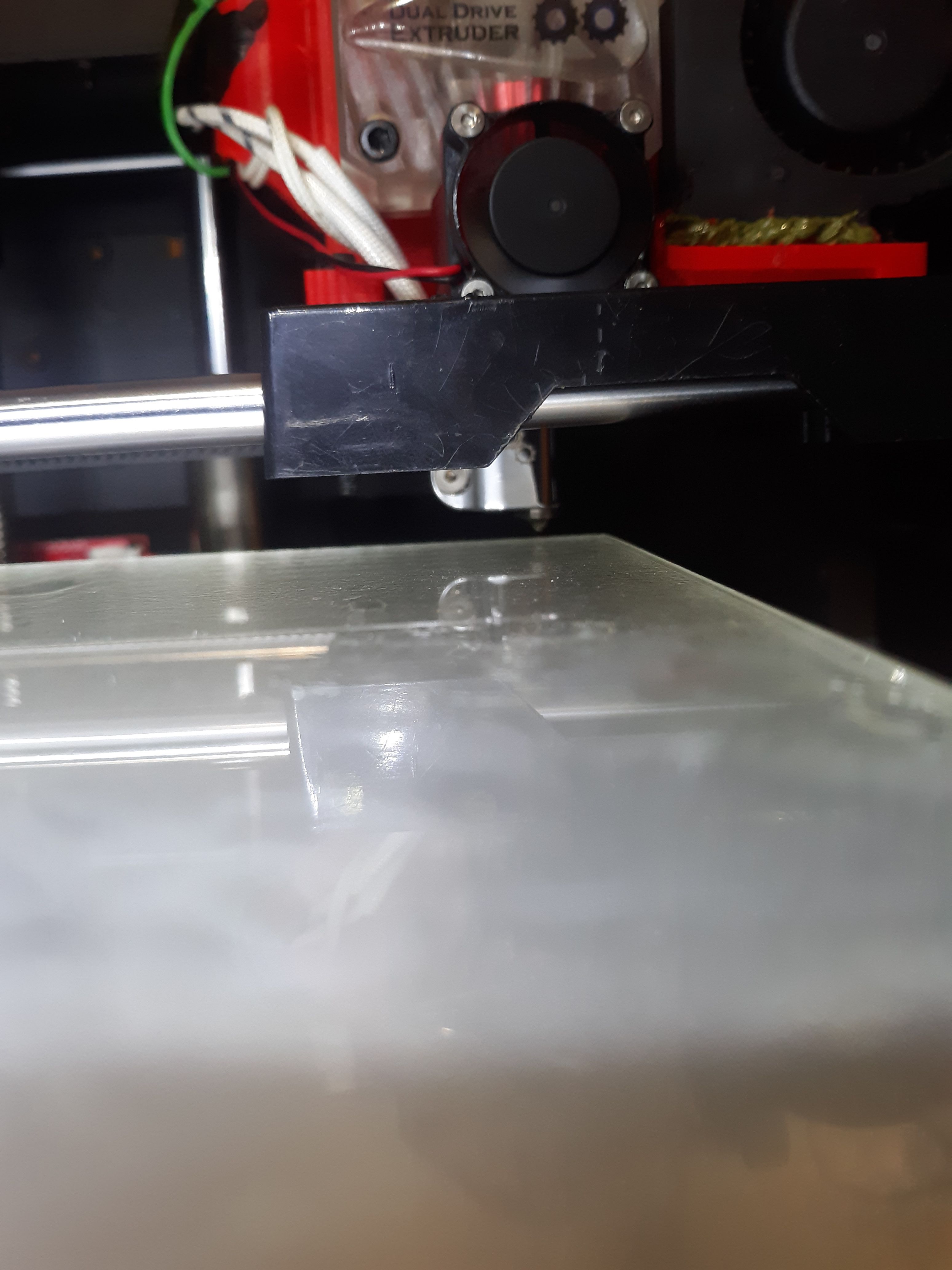

      Greetings, I have a qidi tech 1 that i modded by using a duet wifi and switching to single hot end. I am trying to set the starting print height. The process i used was the bed to touch the nozzle and used g92 z0 followed by m500. i then changed the numbers in the start script to 0 and then 0.50 but its not where i need it to be. i will be including the start script below am i doing this right or missing a step ??? I want to print !!!
      ; Startup Gcode
      G91 ; Relative Positioning
      G1 Z-1 ; Move Z down 1mm
      G90 ; Absolute Positioning
      G28 XY ; Home XY
      M561 ; Clear any bed transform
      G1 X5 Y5 ; Move Head to front left
      G92 E0.50 ; Zero Extruder
      G1 F200 E20 ; Prime the extruder
      Vetiundefined 1 Reply Last reply Reply Quote 0

                Phaedrux Moderator @dakingofhearts2003
                @dakingofhearts2003 said in Help with starting print height after modding a qidi tech 1:
                G1 H1 Z205 F1800 ; move Z up until the endstop is triggered
                G92 Z0 ; set Z position to axis maximum (you may want to adjust this)
                That doesn't make any sense. It moves to the high end of the Z axis and then sets it as Z0.
                Plus your Z endstop is defined as being on the low end.
                M574 Z1 S1 P"zstop" ; configure active-high endstop for high end on Z via pin zstop
                Where are you endstops physically located? I think you've got a motor direction wrong and maybe a homing move incorrect as well.
                You startup gcode doesn't have anywhere that it homes Z either, just X and Y. Are you using homeall or homez at all?
                M500 doesn't work that way, but touching the nozzle to the bed and sending G92 Z0 would set the height correctly.
                    G1 H1 Z205 F360 ; move Z up stopping at the endstop
                    G90 ; absolute positioning
                    Ok so if you endstop is located at Z min, then your homing move in homeall and homez is going the wrong way.
                    Should be G1 H1 Z-205 F360
                    If G1 Z205 is moving towards the endstop, then your Z axis motor is rotating the wrong way.
                    When jogging the Z axis does Z+ move the bed and nozzle farther apart and Z- closer together?
                    dakingofhearts2003undefined 1 Reply Last reply Reply Quote 0
                        Everything homes correctly but it keeps starting the prints about 5 mm above the bed if i can fix that im good.
                        After you homeall are you able to jog the nozzle down so that Z0 has the nozzle just touching the bed?

                            • dakingofhearts2003undefined
                              dakingofhearts2003
                              This is how close it is after homing
                              fcwiltundefined 1 Reply Last reply Reply Quote 0
                              • fcwiltundefined
                                fcwilt @dakingofhearts2003
                                You need to determine how far from the bed the nozzle is at that point.
                                Then you need to adjust the G92 Z0 line to specify the actual Z position at that point, and it is clearly not 0.
                                Let's say you determine the nozzle is exactly 5mm off the bed.
                                Then the line should read G92 Z5.
                                So then moving to Z0 would move down 5mm and should touch the bed.
                                Printers: a E3D MS/TC setup and a RatRig Hybrid. Using Duet 3 hardware running 3.4.6
                                  dakingofhearts2003 @fcwilt
                                  @fcwilt i did that and still this is what i get
                                  • fcwiltundefined
                                    fcwilt
                                    So you modified the G29 Z# line in the homez.g file?
                                    And the nozzle is now farther away?
                                      i assure you everything is correct
                                      And yet your nozzle is 5mm above the bed. 🤔
