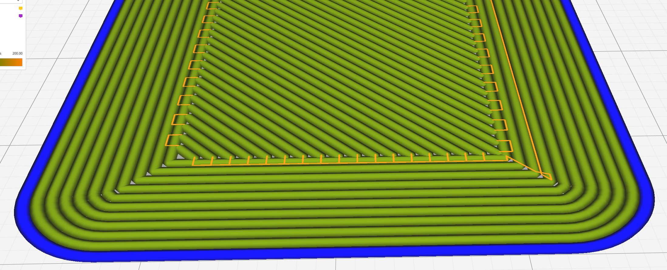

  • Mystery solved.
    I started working with @Phaedrux's suggeestion of using Slic3r, and I noticed that they didn't have a "Lines" pattern for the top/bottom layers. So in order to keep the test fair, I used "zig zag" in Cura to keep the playing field level.
    During the test print, I immediately noticed that the stepper wasn't going backwards any more - So I came back to Cura and realised that "Travel" moves were turned off. You can see in the image below, small joining moves that extend horizontally. So, the motor is going backwards, but only because of the CoreXY geometry. A Cartesian printer wouldn't see the same effect.
    Here's the same print, sliced with the "Zig Zag" pattern instead.
