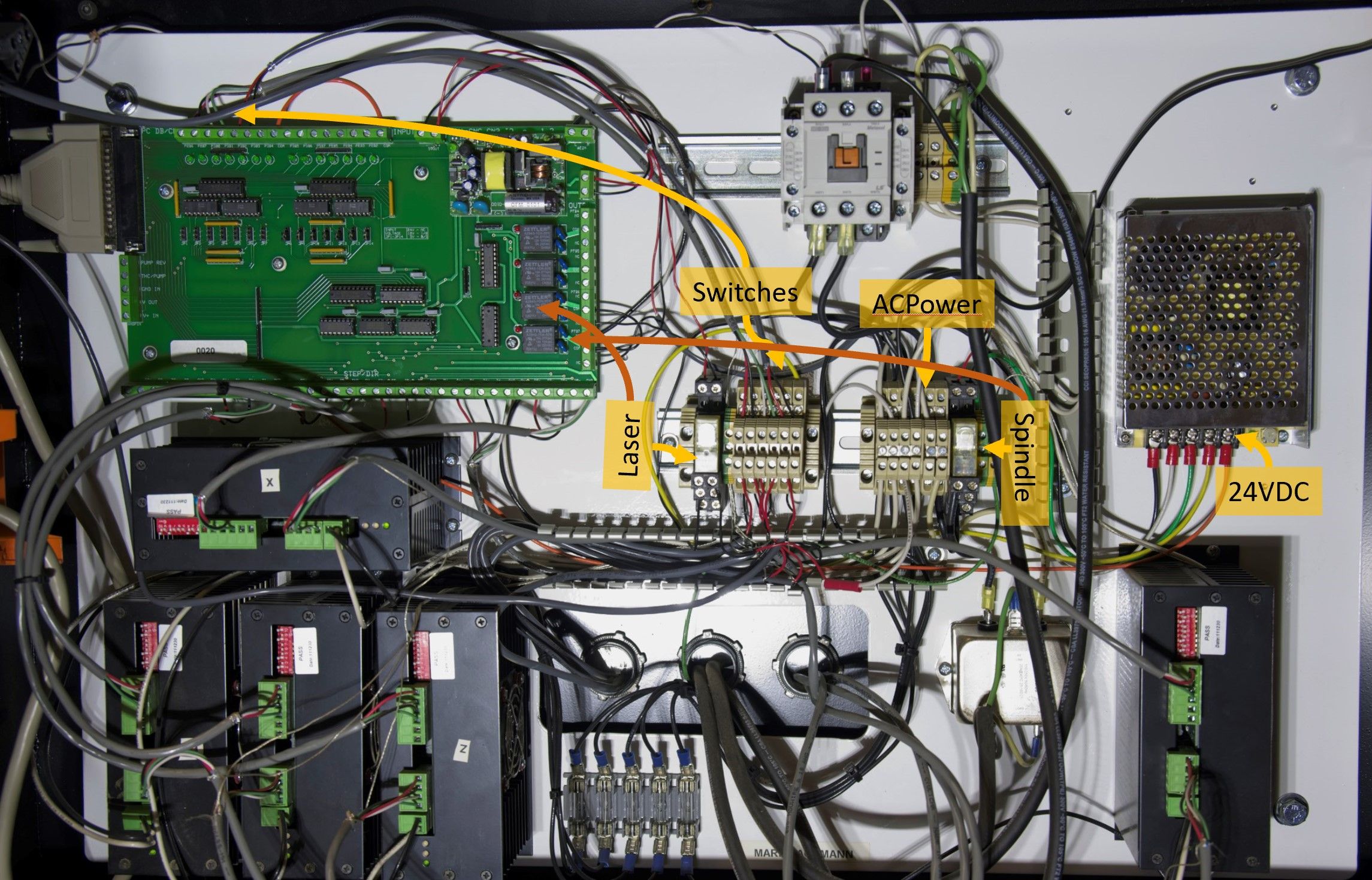

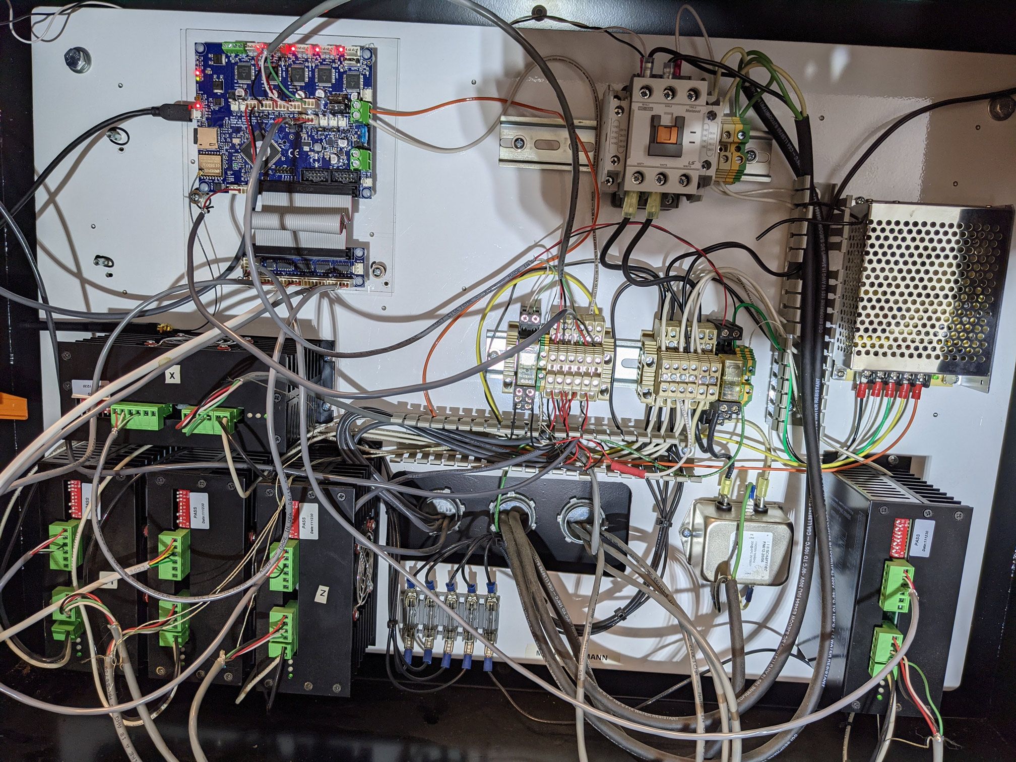

I just spent about 1.5 days swapping out the old controller in my 3'x4' Stinger to a Duet2 + hardware breakout board. It needs a little firmware mod but otherwise every feature is hooked up and working. Very nice.
Original chassis
With Duet2 wifi working fine
@markz That looks like I did the wiring!
Well, if you worked for Camaster 10 years ago, that might have been you. Overall it's been a great machine other than the controller, which worked well but suffers from a small market and the need for a plugin pc board and massive cable.
