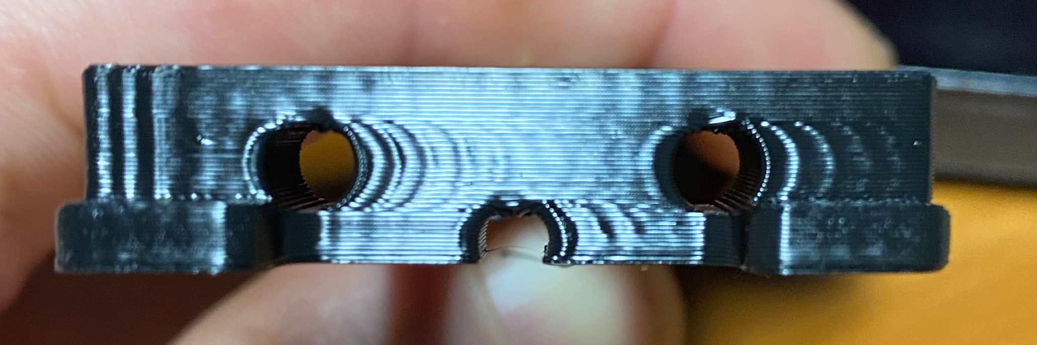

    DAA Ringing help please

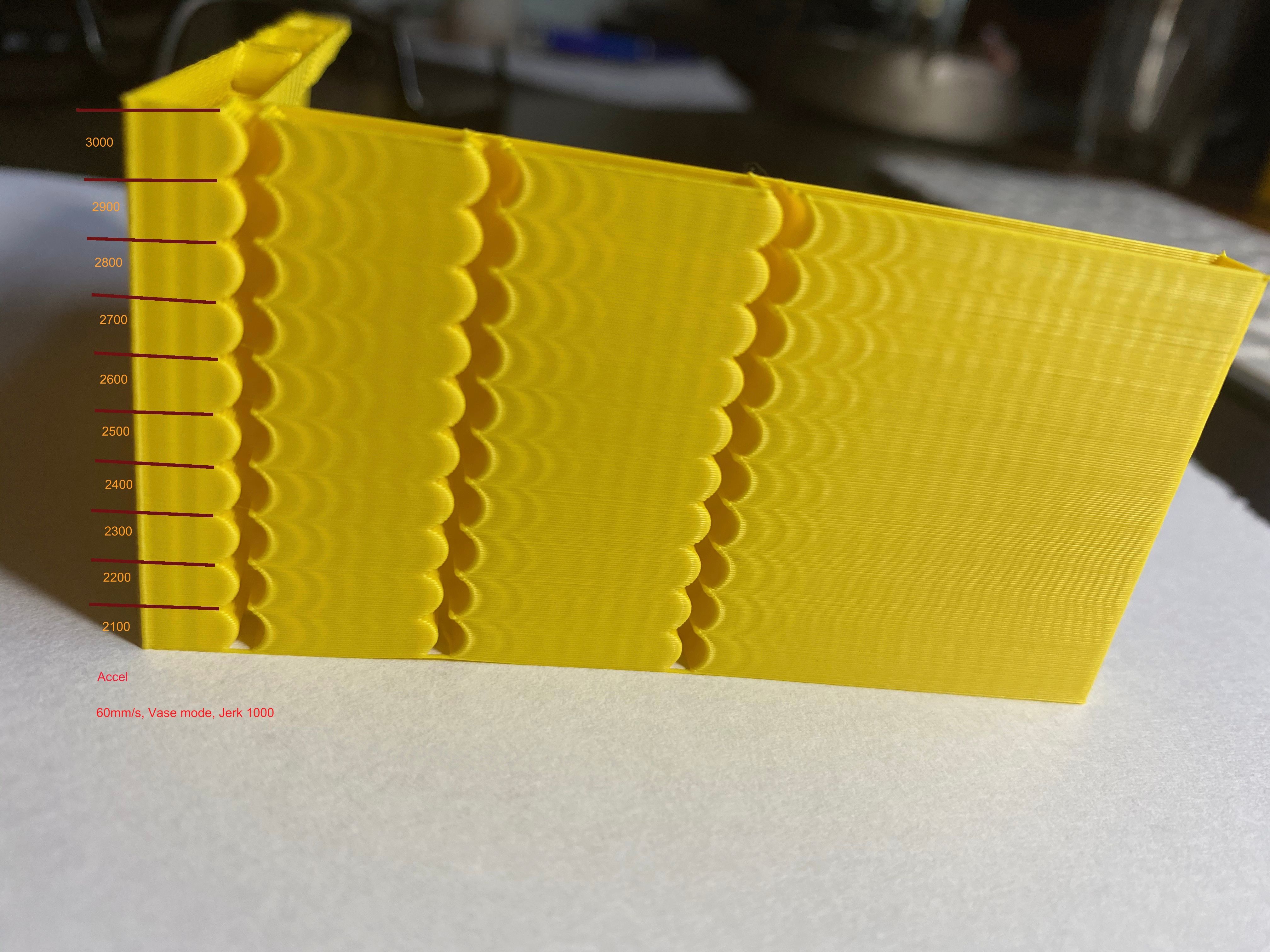

      Printing a ringing tower and modify the gcode at various z heights to change the accell/jerk/speed the values on the way up. This can be a big help for tuning out ringing like this. Similar to using a temp tower to find the ideal temp.
      The first step is to find the lowest speed settings that doesn't have any ringing and work your way up.
      If there is no speed where ringing can be eliminated then It's likely mechanical slop.
      Also, disable DAA entirely until you've determined if it's a mechanical issue or not as it could be muddying the waters.

        Did some test prints with DAA disabled.
        Accel
        Jerk
        To be honest I don't know what to do now 🙂 Not that big differences?!
          Well it definitely gets worse at the high end of acceleration.
          For my external walls if I want absolutely no sign of ringing I use 600 accel and 600 jerk (and then higher for other print moves). So maybe give that a shot.
          Though there still appears to be some additional mechanical noise that shows up in the repeating ridges on the long straight that don't seem to die down.
          Photo of your printer?

              Did a lot of test prints and found out that especially decreasing the maximum printing acceleration (M204) is having a huge impact on ringing.
              Best values for outer shells I've found so far:
              M566 X300 Y300
              M201 X6000 Y6000
              M204 P500

                Of course this will slow down the print massive but only for the outer shell. Let's see if this is something I can live with 😉 Beside of that I think I also have a Y axis issue because ringing is always a lot of "stronger" on the Y axis. X axis looks quite better.

                    I think I cracked it down and found the best compromise between ringing and accel/jerk. It turned out that my ringing frequency is as low as 4.1.
                    But bet? Now I have another problem 😲
