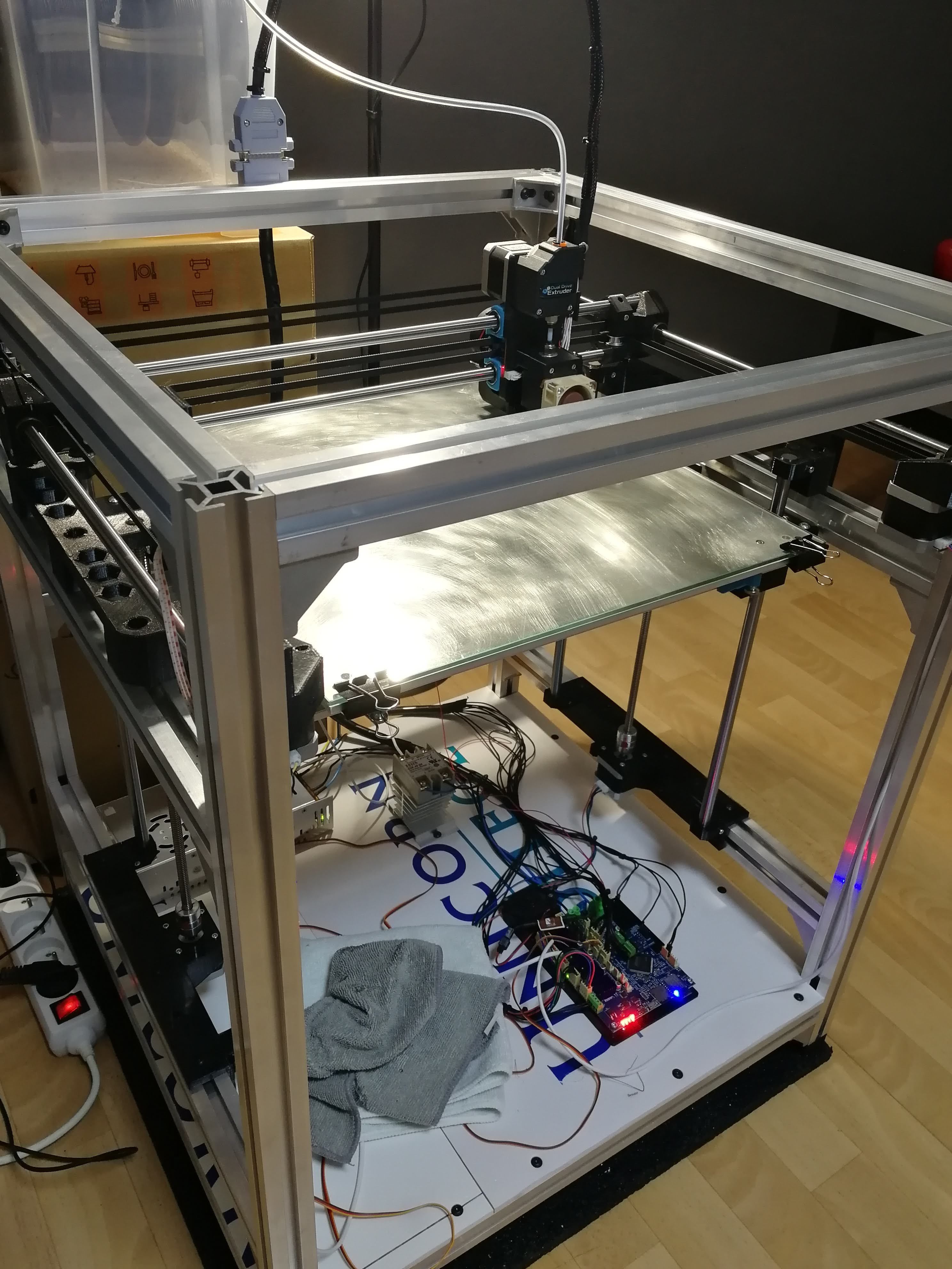

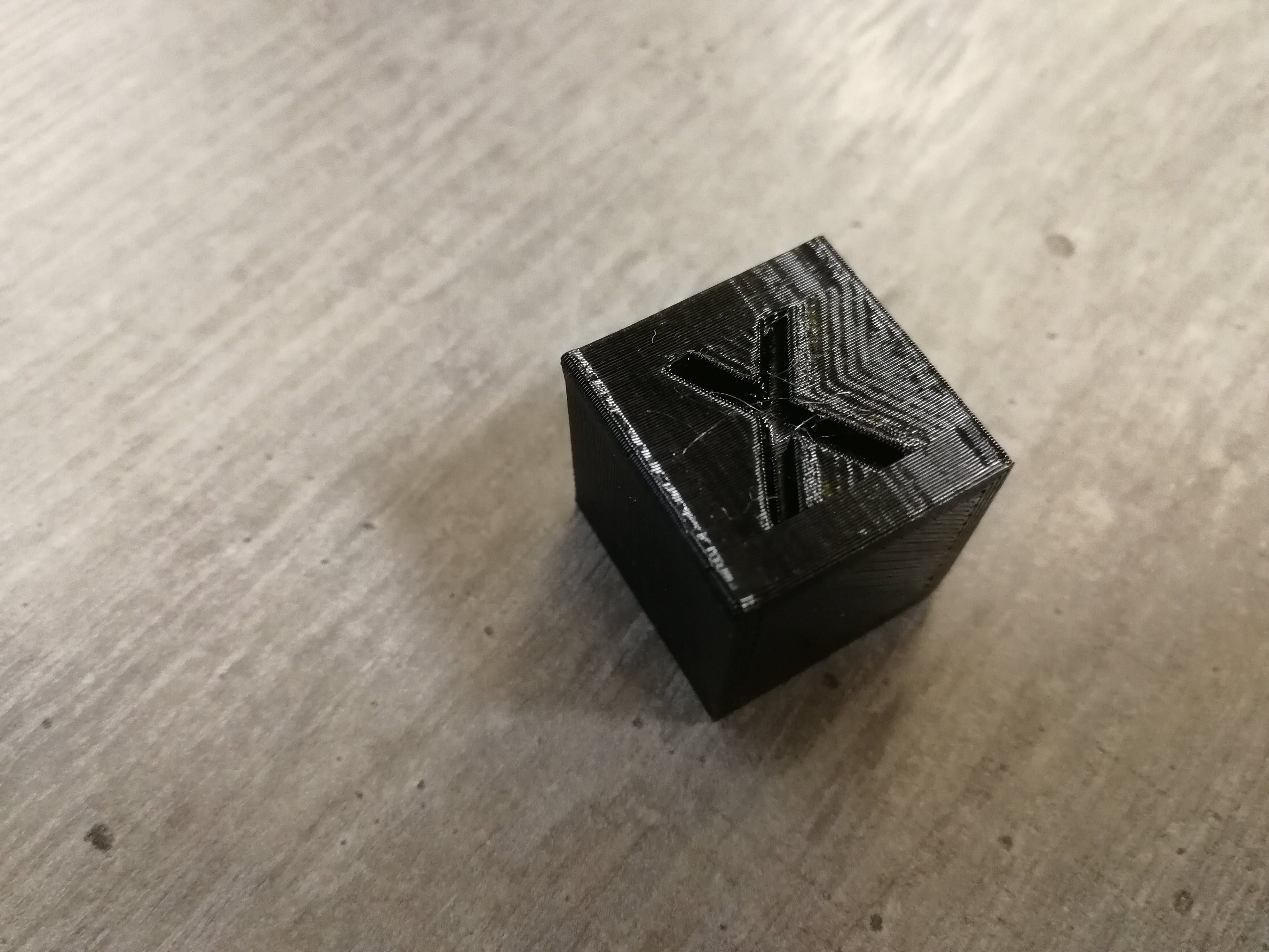

      I have a problem tuning my printer. This is a Hypercube Evolution with 17 hs4401 engines. Settings here. Hotend is E3D V6 with BMG.
      Thank you for the advice.
      config.g Config file
      IMG_20210113_213814.jpg IMG_20210113_213759.jpg IMG_20210113_213750.jpg IMG_20210113_213721.jpg IMG_20210113_213707.jpg IMG_20210113_213645.jpg

          That's exactly what I was looking at, but I don't know what the appropriate settings are for my engines and printer.
            Well no one does without some testing. In that thread there are some suggestions made on how to find good results.
            I think the hypercube design is prone to ringing due to the heavy rods. There is a lot of mass to sling around with only printed parts to hold it back, so you'll likely be limited to low jerk and accel values for external walls if you want to eliminate the ringing effect. Most slicers allow you to set separate jerk/accel values for different print moves. So you can have slower outer walls and faster for the rest where looks don't matter.
            I think a good place to start would be 600 jerk and 600 accel.
            Print a ringing tower and use various values along the way to try and find a good one.
