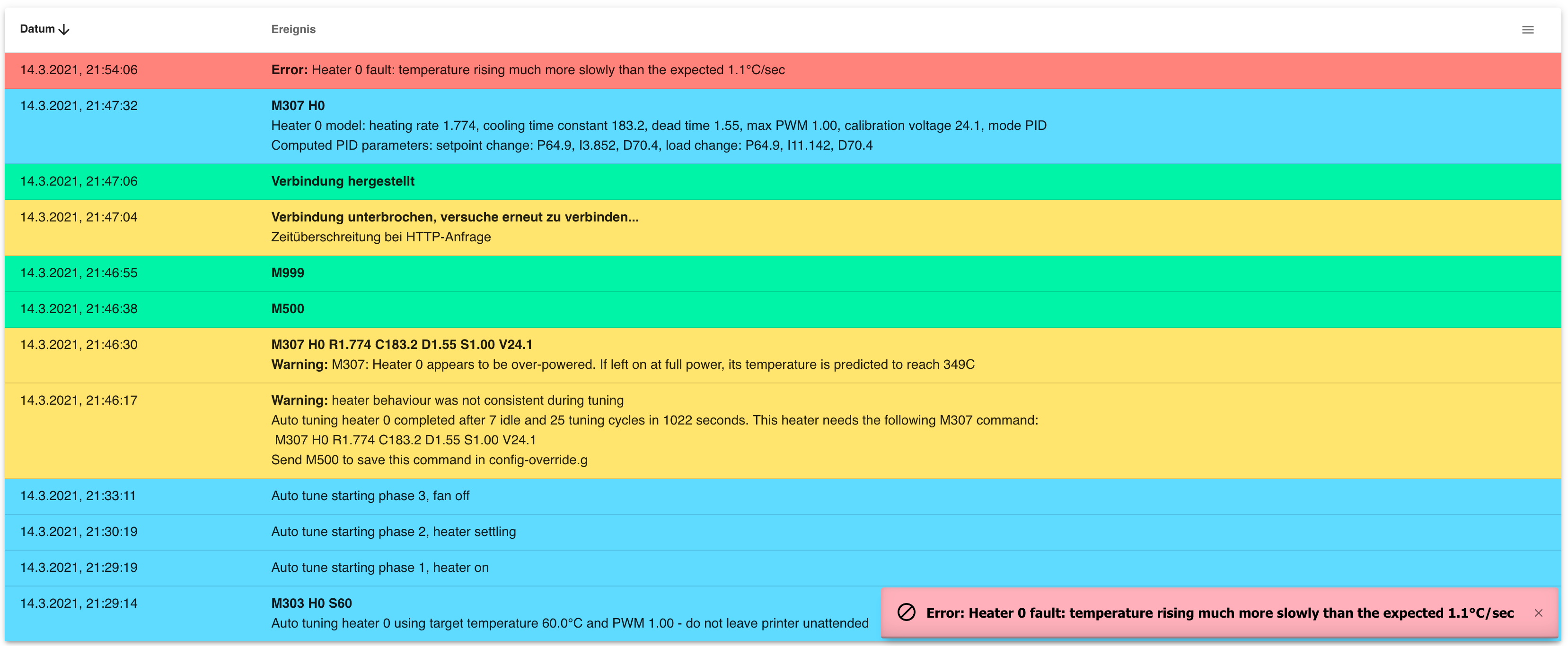

          How does your heater diagram look now?
          chuserundefined 1 Reply Last reply Reply Quote 0
          • chuserundefined
            chuser @A Former User
            @LB the temp diagram is shorter
            A Former User? 1 Reply Last reply Reply Quote 0

                                  dc42 administrators @chuser
                                  @chuser said in Error: Heater 0 fault: temperature rising much more slowly ...:
                                  @Phaedrux the Heater is this one
                                  24V ~60W
                                  https://well-engineered.net/index.php/en/90-new-kapton-heater
                                  Bild Text
                                  Is that the thermistor in the centre of the heater?
                                  If so then I think the problem is that the new algorithm doesn't work well with heaters having a large reservoir effect. Your temperature plot of the tuning supports this. By "reservoir effect", I mean that the thermistor is coupled fairly tightly to the heater, and less tightly to a large heat reservoir, in this case the bed plate. This means that the FOPDT model breaks down and there are in effect two values for the heating rate or gain: a short term value (which is what the new algorithm measures) which is the heating rate when the reservoir is close to the target temperature, and a long term value which is the heating rate when the reservoir is very different from the target temperature.
                                  The ideal solution is to use a thermistor that is coupled to the bed plate (the thing you are trying to heat) instead of the heater. This will also give you better temperature control. However, as a workaround you can reduce the R value in the M307 command. Try reducing it by 30% or if necessary 50%.
                                  I have it in mind to modify the algorithm to measure the long-term heating rate as well as the short term one, and use the long term rate when monitoring for a heater fault.
                                  1 Reply Last reply Reply Quote 3
                                    Phaedrux Moderator @chuser
                                    Then I tried to decreasing the gain, and this work.
                                    M307 H0 R1.0 C184.233:184.233 D1.53 S1.00 V24.1 B0
                                    I can't believe it.
                                    Can I leave it set like this? Or does this still need to be optimized?
                                    What does the heat graph look like with those values? If the temps are stable, you can continue to use it.
                                      Decreasing the gain or heating rate parameter will fix the "temperature rising too slowly" error. It might have the side-effect of causing the temperature to oscillate slightly. If so, then increase the dead time parameter enough to stop the oscillations.
