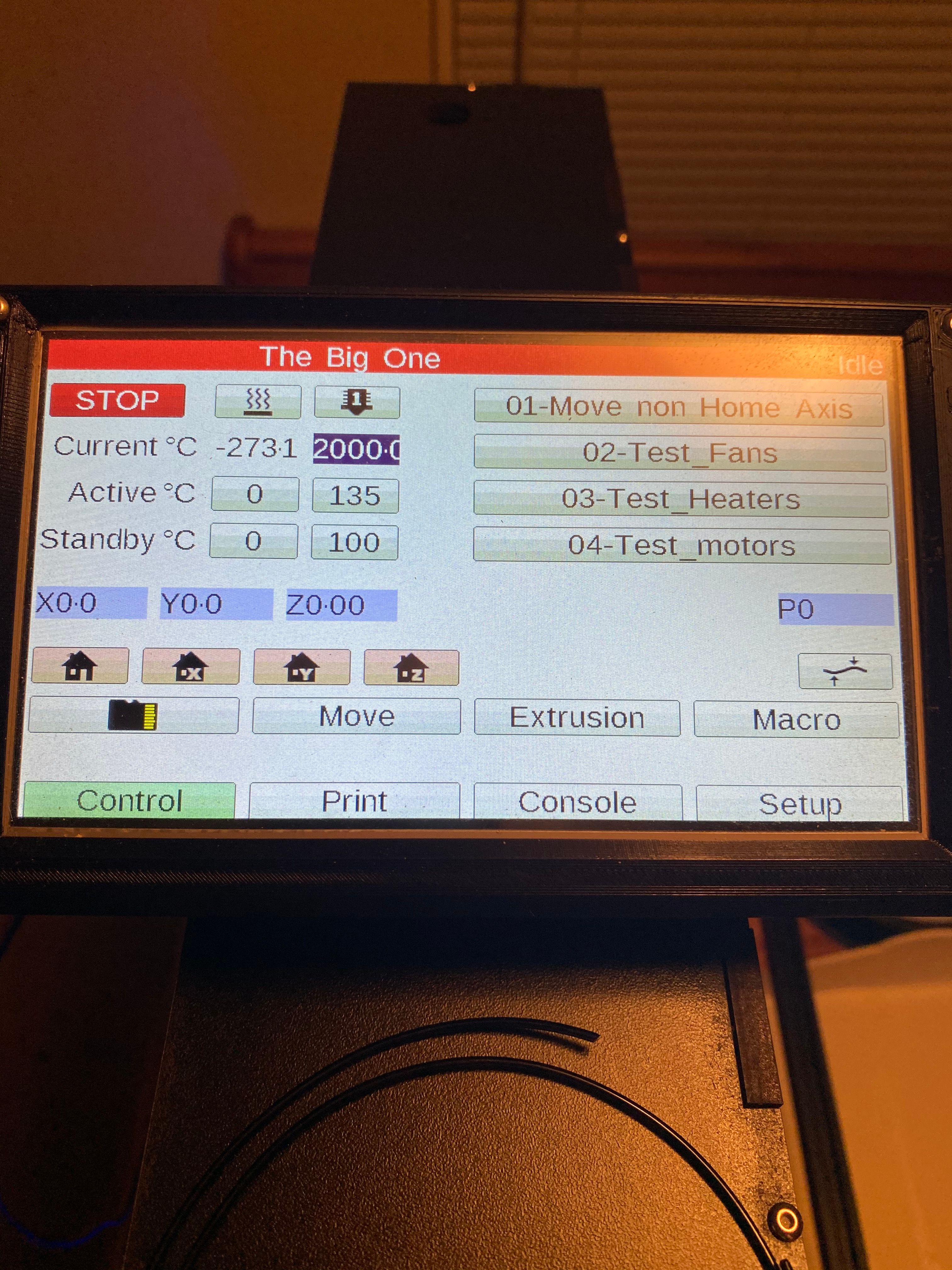

      Hello all,
      Im nearing completion of this custom build but i am having issues trying to test the extruder motor. When i try to test it to check the steps i get errors saying the tool cant be moved due to the heater and thermister settings. Can someone check my config?
      Its a E3d V6 with the stock heater and thermister. The extruder is using E1/drive4.
      Here is how my drives are layed out
      My config

        What exactly is the message you are getting?

          "warning: tool 0 was not driven because temperatures were not high enough or it has heater fault"

                          Based on the link you posted Ive set up some temps for the hotend to select from the drop down but it isnt heating up and the temp shows 2000 all the time... might need to pull out the voltmeter to make sure its getting power but why would the thermistor show 2000 at all times?
                          Highly modified FT5 R1, ATX supply, mosfet w/silicone heat pad, bmg ext, TMC2600 drivers, and my custom quad z mod with 4 lead screws and custom cut new upper panels and bed, and using the dual z endstop mod. New project is 800x500x500z printer.
                            https://duet3d.dozuki.com/Wiki/FAQ#Section_My_temperature_shows_as_273c_or_2000c
                            My temperature shows as -273c or 2000c
                            A disconnected (open circuit) thermistor shows -273C in RRF. Other temperature sensor faults give a reading of 2000C, which triggers thermal protection as a safety. In general, check your wiring first and then ensure thermistor configuration is correct and uses the right syntax for your firmware version. i.e. RRF2 vs RRF3.
                            What is your thermistor? Your config says it's connected to E1temp. Do you have it maybe connected to E0?

                              As mentioned in my first post its a e3d v6 with the stock included thermistor. The gcode for that thermister was copied from the dozuki list for rrp3 for the e3d v6
                              I will check the wiring again.

                                I checked for continuity from the connector at the thermistor through the breakout board, through the cat cable, through the next breakout board, and to the connector at the duet and it all checks out. As i powered the machine back up i noticed another error saying it was an unknown sensor... so i checked my gcode against the wiki again and im fairly certain i have it correct...

                                I am using the E1 heater slot and the Thermistor 2 slot on the Duet as you can see:
                                http://puu.sh/HpWHZ/6701529966.jpg
                                  Yes that looks correct values for the E3D thermistor.
                                  Can you send M98 P"config.g" in the console and report the results?

                                      @wingtip said in Need help with reprap 3 Gcode (extruder):
                                      M950 H1 C"e1heat" T2
                                      I think that should be M950 H1 C"e1heat" T1

                                        really? i was going by this diagram which says for the e1 hotend the corresponding thermister is #2... but i can try your suggestion

                                          E0 is my x motor, not the hotend

                                            It's maybe a little confusing..

                                            T Temperature sensor number, required only when creating a heater. See M308.
                                            M308 S1 P"e1temp" Y"thermistor" T100000 B4725 C7.06e-8 ; define E1 temperature sensor
                                            M950 H1 C"e1heat" T2                           ; create nozzle heater output on e0heat and map it to sensor 1
                                            M307 H1 B0 S1.00                               ; disable bang-bang mode for heater  and set PWM limit
                                            M143 H1 S280                                   ; set temperature limit for heater 1 to 280C
                                            The T1 in the M950 command refers to the sensor you've created in M308 which is S1.
                                            That's why it's giving the "error sensor number 2 has not been defined." Because it doesn't exist yet. ie been defined with an M308 command.
