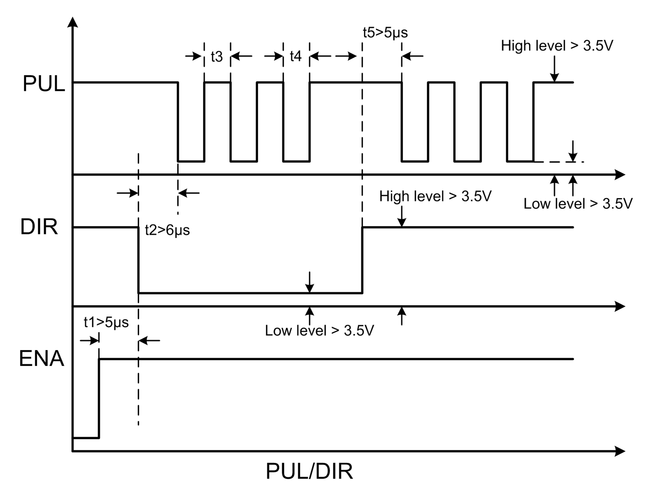

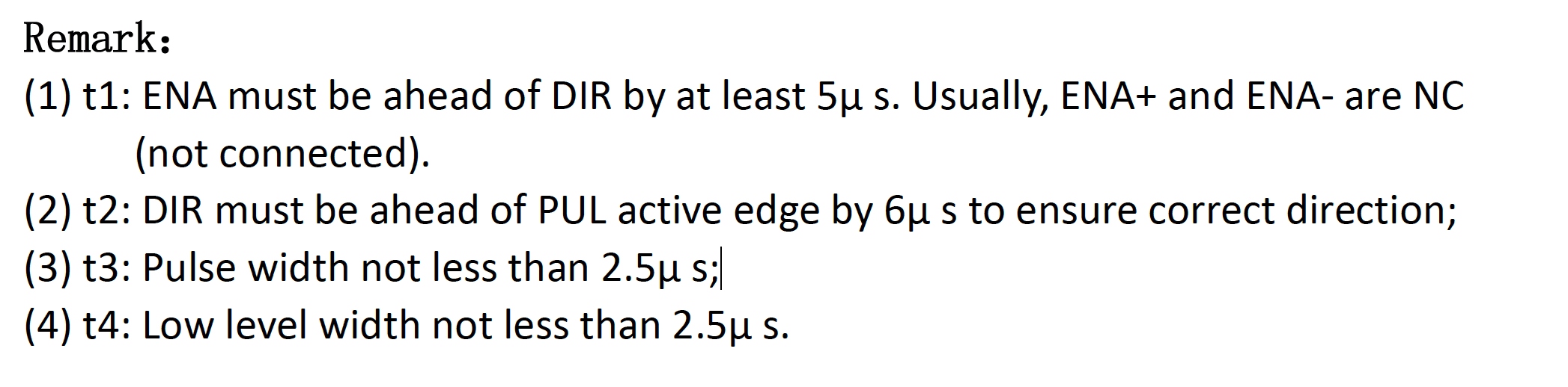

        3. My timing could be off. This seems likely, except that I am using the same timing values that I successfully tested these motors with the MKS SGEN controller board. Copied from the servo manual:
          t1: ENA must be ahead of DIR by at least 5μ s. Usually, ENA+ and ENA- are NC
          (not connected).
          t2: DIR must be ahead of PUL active edge by 6μ s to ensure correct direction;
          t3: Pulse width not less than 2.5μ s;
          t4: Low level width not less than 2.5μ s.

                  1. Use 5V logic by connecting the PUL+, DIR+ and ENA+ for all three tower servo motors to the +5V pin on the H6_PMW header of the Duet Expansion Breakout Board.
                  2. Use 'R1' to invert the enable signal (although this may be accomplished by switching the ENA+ and ENA- wires).
                  3. Increase timing values. The tricky part here is that the values stated in the servo motor manual did not work! I had to increase the values well above what they stated was necessary. More details below:
                  Screen Shot 2021-03-20 at 3.39.09 PM.png Screen Shot 2021-03-20 at 3.39.01 PM.png
                  Based on these figures, I believed that setting the timing to T3:3:6:6 using the M569 command would be sufficient. HOWEVER, after testing I found that the minimum values I can use are T4:4:10:6 meaning a 4 microsecond step pulse width, 4 microsecond step pulse interval, 10 microsecond direction setup time and 6 microsecond direction hold time. To be safe, my final values are as follows:
                  M569 P5 S1 R1 T5:5:12:6 ; physical drive 5 goes forwards (x-tower), enable signal inversion, timing:3,3,6,6
                  M569 P6 S1 R1 T5:5:12:6 ; physical drive 6 goes forwards (y-tower), enable signal inversion, timing:3,3,6,6
                  M569 P7 S1 R1 T5:5:12:6 ; physical drive 7 goes forwards (z-tower), enable signal inversion, timing:3,3,6,6
                  droftartsundefined 1 Reply Last reply Reply Quote 2
