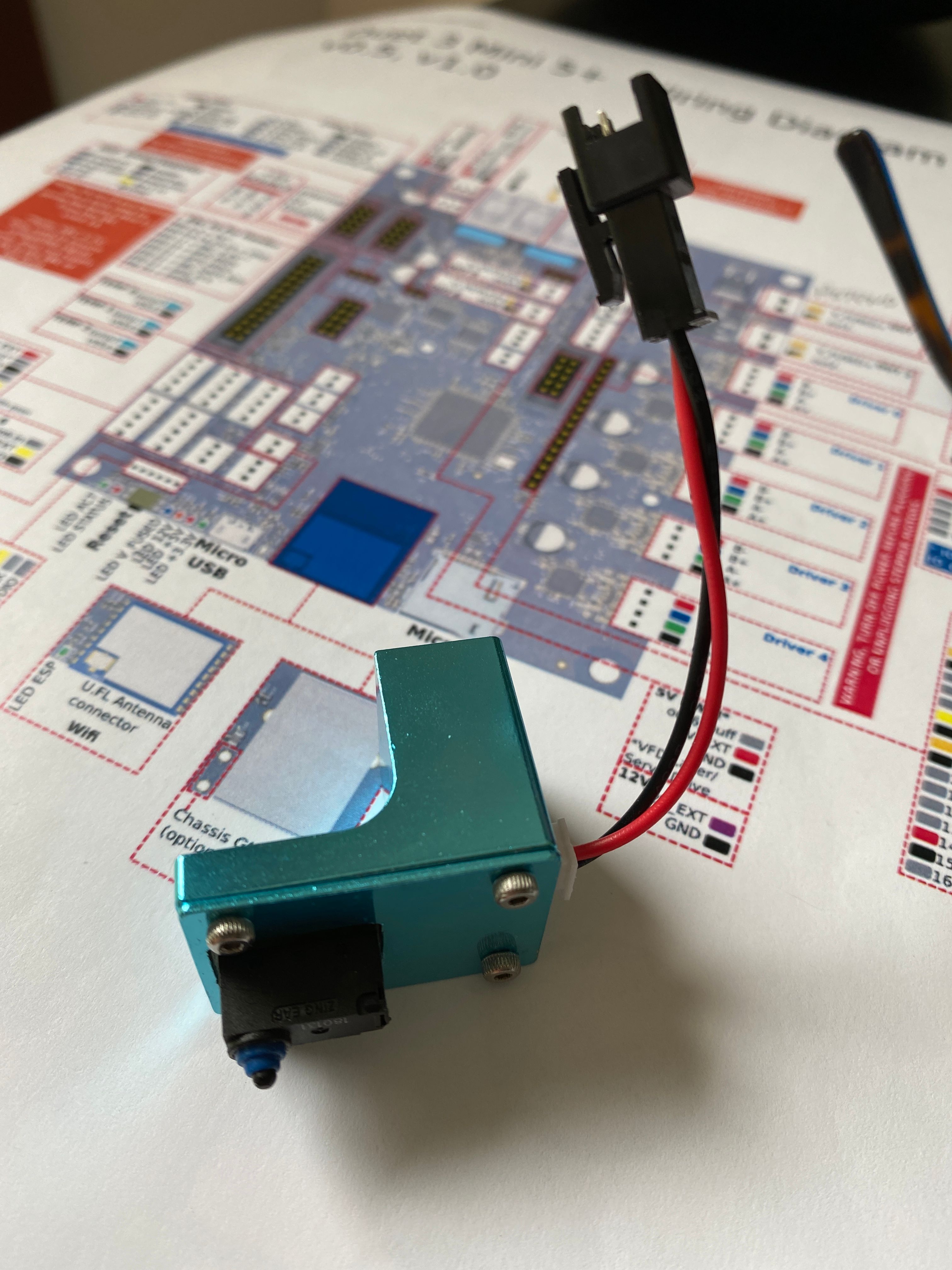

      I have an Anycubic Kossel LP w/Mini 5+ with the stock Z probe. RRF guide lists 10 different types of probes. Which is the Kossel's?

        @norwestie I chose type 5 but I get Z probe already triggered. It is wired to io3.out on out+gnd (tried in+gnd also). This is how it is set up in config.g: M558 P5 C"^temp2" H5 F120 T6000

          That's a good question. What is the stock Kossel probe? what does it look like? What wires does it have? Photo?
          norwestie 1 Reply Last reply Reply Quote 0
          • norwestie
            norwestie @Phaedrux last edited by
            It is a 2 wire connection and feels like a microswitch

            • Phaedrux
              Yes that looks like a microswitch.
              Try P8 instead of P5.
              If it's showing triggered all the time, invert the signal by adding ! to the front of the pin name in M558.
              M558 P8 C"^!zprobe.in" H5 F120 T6000
              Are you really wanting to use temp2 pin? Why not the zprobe.in pin?

                • Phaedrux
                  Phaedrux Moderator @norwestie last edited by
                  @norwestie said in Z probe type?:
                  w/Mini 5+
                  Sorry, my bad. For some reason I thought you had a Duet2, but you mentioned you had a mini5 + which means you have more generalized io pins.
                  But still, why temp2 instead of an io port? Choosing an io port as shown in the bottom left of the board in this image would make more sense. Same as you'd use for an endstop.

                    • Phaedrux
                      If you're using io_3 your M558 line should look something like this..
                      M558 P8 C"^io3.in" H5 F120 T6000
                      Also ensure that you are connecting your switch to the io3.in and gnd pins on the connector. It doesn't matter which goes to which.
