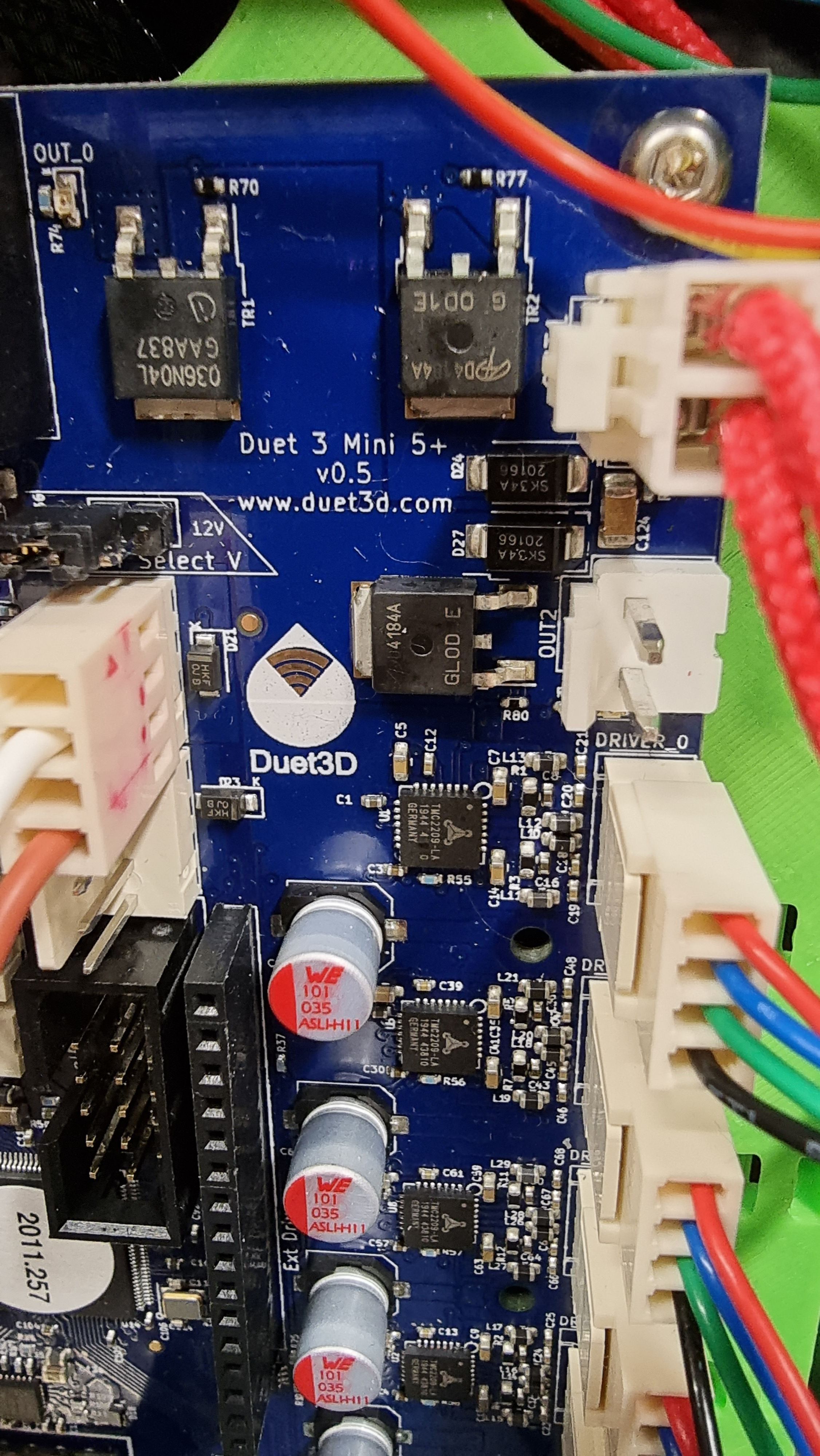

@paulhew ok yes 0.1A '24V for both together is fine. I see its a 0.5 board and we did have some issues with mosfet soldering on those boards so it could be that (although odd it was working before).

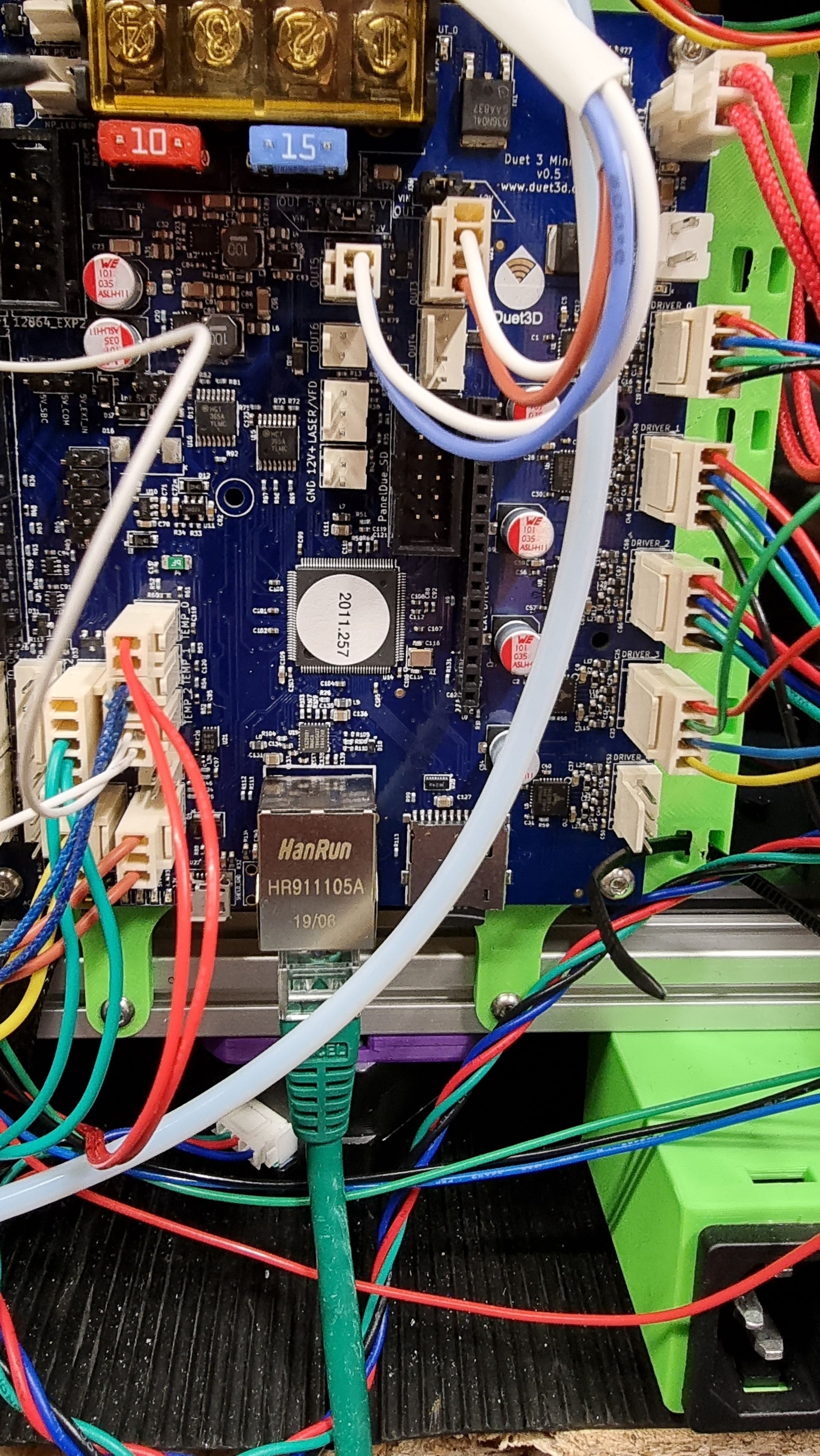

It did get hot in that little chamber so am going to go through the wiring to make sure all is good. It was hot enough to shrink the heat shrink cable labels near the extruder!

@t3p3tony Sorry to intrude, but does the Driver 0 TMC2209 look odd to you? Looking at 2 separate photos, the text line above GERMANY looks odd on that one driver.

I took the time last night to remove the Mini 5 from my printer so I can send to Tony. Thanks @T3P3Tony
Whilst at it I checked the fan cabling and found a melt spot on one of the cables. There was also a mark on the brass where i realize now it had shorted, me being inquisitive wiped it to see what it was!
As per the LDO part number and spec sheet which is above in this thread, 800ma is way too much for this little motor, even though they say it is rated for 1amp
The motor was that hot it burnt my fingers when checking the issue, in turn had heated the brass standoffs which then melted the sheath of the fan cable that was resting on the brass. (The whole lot is in a chamber)
Also you can see the heat shrink has been shrunk by the extreme heat. I put them on loose!All the printers I have built and used the 80% rule, i have never had this.
However lesson learnt, replace chinese cable with silicone or use a protective braid.
For those who think I did not RTFM, I did and always do! Hence how I got into this mess!
@paulhew Thanks for the update. I think its likely that the melting + short fried the Out3 mosfet but will take a look when I get your board. The stepper driver "black spot" though we will see!
