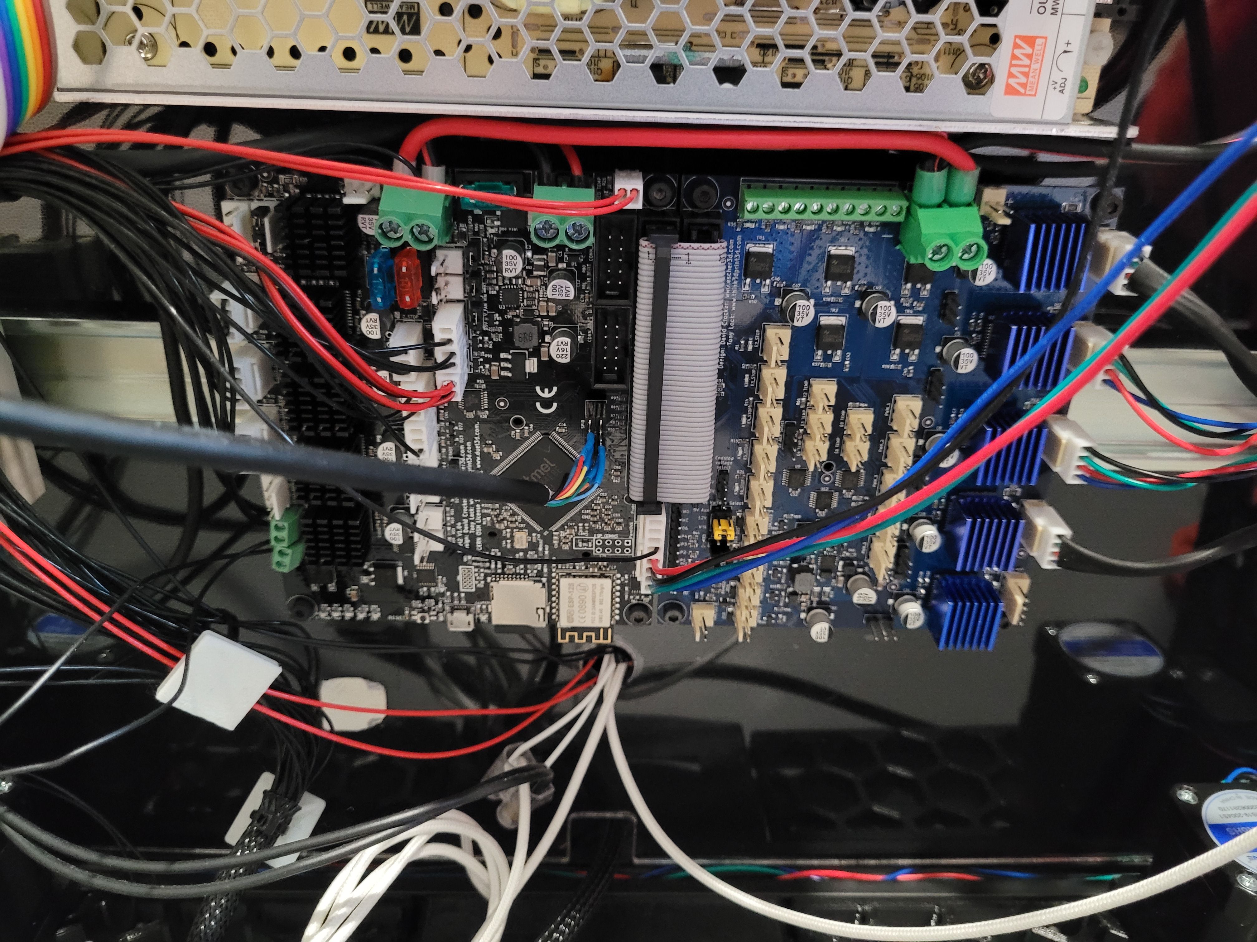

      i'm struggling getting LIS3DH working on my setup (duet2+duex5). I connected the accelerometer on the daughter board connector of the duex5. These are the cross wiring i made with a cat5 cable:
      On webui i get:
      M955 P0 C"spi.cs5+spi.cs6"
      Error: M955: Accelerometer not found on specified port
      Cable is barely long enough to reach the bottom of the printer to the toolhead not crossing power or motor cables. Am i doing something wrong? thank you.undefined

          @siam So 1k resistor did not fix it. My wiring is correct? is it possibile to use the daughterboard connection on the duex? if so i will try changing the cable with an usb3 one.

          Edit2: Also tried to disconnect the PT100 board on CS1 and connect the accelerometer on CS1 and CS2 but without luck...also with 1k resistor in series with SDO pin at accelerometer end. Here's a photo of one end of the wiring..the other is the same without the 1k resistor:
          dc42undefined felekundefined 2 Replies Last reply Reply Quote 0
            dc42 administrators @MikeS
            @mikes please post a photo of the Duet end of the wiring too.
            MikeSundefined 1 Reply Last reply Reply Quote 0
            • MikeSundefined
              MikeS @dc42
              @dc42 sorry for the delay but the board is under the printer and i need some help for moving it.
              Wirings are not tidy as i would but they seems ok to me. Also the accelerometer now is connected to CS1/CS2 on duet2wifi, no need to print at the moment so i disconnected PT100 and remove it's gcode in config.g

                I also bought this board from Aliexpress and I wasn't able to run it. After investigation I realized that it is LIS3DSH chip which has different registers than LIS3DH.
                AFAIK RRF3 doesn't support LIS3DSH right now.
                Take a look on the chip. There is DSH instead of DH.

                  @felek thanks for the feedback. Actually i did the same mistake and had to buy the correct one from local amazon (it) .Just looked at the chip and it actually really says DSH instead of DH. Damn!
                  @dc42 thanks for the help. Any chance that this DSH version will be implemented in the future?
                    @mikes I have a LIS3DSH board already and I do plan to add support for it, but it isn't the priority right now.

                        @mikes I now have my LIS3DSH accelerometer working with RRF. Support for it will be included in a forthcoming RRF 3.4beta release.
