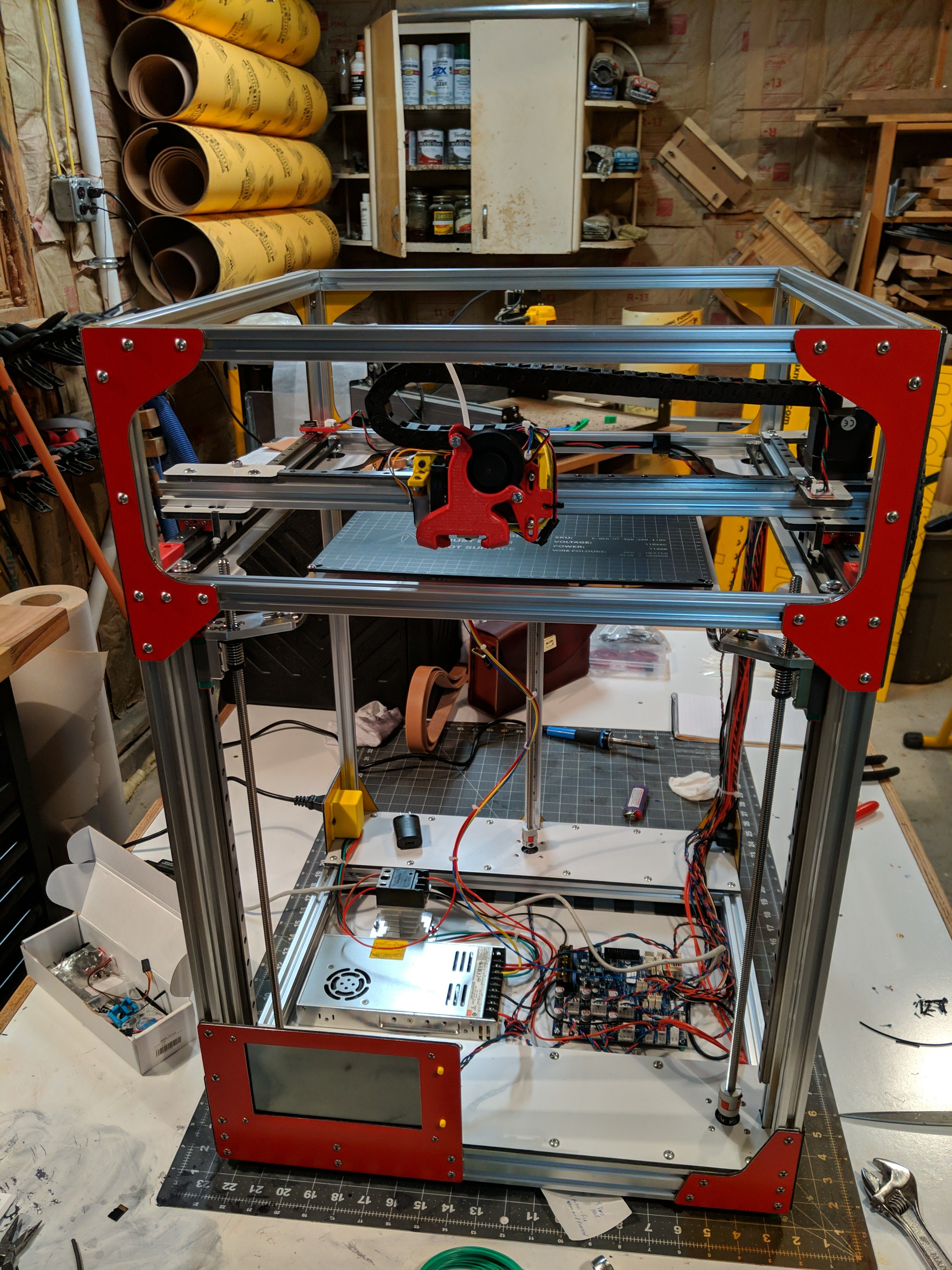

      Hello! I designed and built this printer and it uses a Duet 3 6HC controller with 3 Z motors. It's Cartesian, I wanted direct drive and was concerned about weight on a core XY.
      Well, it works, sort of. It homes XY, and G30 works with the Z. The motors work fine, it heats, it extrudes, even the paneldue works.
      HOWEVER....I cannot for the life of me get the autolevel to work and am VERY new to duet and reprap. Lots of experience with Marlin and building standard direct drive and bowden cartesian printers.
      THE PROBLEM - G28 cannot find the endstops, even though I never specified endstops for the Z in the configuration tool. The BL Touch works absolutely fine, like I said G30 works great. Can someone point me to an explanation of homeall.g and homez.g? I think this is where it is having troubles.
      I HAVE....seen the link in the wiki on how to do 3 independent motors....it does not work. I have seen other articles and descriptions....no luck. I have even tried to bogart Jubilee code....still nothing.
      Any suggestions are appreciated.

        Do you have an endstop sensor installed for each Z axis or do you want to home using the Z probe?
        Printers: a small Utilmaker style, a small CoreXY and a E3D MS/TC setup. Various hotends. Using Duet 3 hardware running 3.4.6
        austiniousundefined 1 Reply Last reply Reply Quote 0
        • austiniousundefined
          austinious @fcwilt
          @fcwilt no endstops for the z, just the BLTouch. Not sure why I get the error, "G28 Z endstop not enabled". I didn't define an endstop in the config tool, just the probe. And G30 works like a charm.
          fcwiltundefined engikeneerundefined 2 Replies Last reply Reply Quote 0

            Please copy-and-paste your configuration files here using the </> - one file per one </>.

              @austinious ^config.g and homing files

                  One thing just hit me....I'm not sure the G30 P#'s in the bed.g correspond to the driver assignments in config.g, could it be that simple?

                    @austinious both homeall and homez use a G1 H1 move to home so expects and endstop, not a G30 probing move. Thats the source of your error.
                    Also, don't load your heightmap til after you levels the bed in bed.g. otherwise your levelling measurements will be based on a compensated bed and the two will fight each other
                    The order of the probe points in the bed.g don't matter. I use six points in mine in different parts of the bed. What matters is the M671 coordinates are in the same order as your z drives

                            Success! Sort of...
                            G28
                            Error: Some computed corrections exceed configured limit of 0.50mm: -0.599 -1.480 -2.324
                            Error: Height map file 0:/sys/heightmap.csv not found
                            I assume there is a setting to determine how much adjustment. But hey! Progress!

                              @austinious yes, it's the S parameter in M671
                              https://duet3d.dozuki.com/Wiki/M671
                              You are then calling G29 S1 which loads the heightmap (with the default name). Looks like you don't have one made already so you need to create one with G29 or G29 S0

                                  G28
                                  Leadscrew adjustments made: -0.591 -1.472 -2.315, points used 3, (mean, deviation) before (-1.019, 0.476) after (0.000, 0.000)
                                  WooHoo!
                                  Thanks for the help, I really appreciate it! I increased my M671 to 3mm, reading up on the mesh.

                                    @austinious if your mechanism can take it, there's no real reason not to set it higher. Just bear in mind if uou did have two of the motors swapped, it could unlevel the bed by that much.
                                    Might want to run G32 a few times as any slight errors in leadscrew positions etc mean it won't get it 100% first time. I only run it once before each print, but do it a few times if I mess with anything. Some more clever people use conditional gcode to repeatedly run it until the adjustments are below a threshold. One for if you're feeling fancy when it's yp and running - then you can show me how to do it 😛
