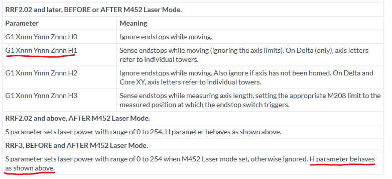

      I am running a Duet 2 Wifi, with RRF 3.
      I am trying to run a G1 Z15 H1 command. It is my understanding that it should move the Z axis in the positive direction until either one of the conditions are met, I.E. move the Z axis until it hits the endstop, and only move it a maximum of 15mm.
      From the documentation, it seems that is what this section is detailing
      However, what I am encountering is that the axis will continue to move until it hits the Z endstop, and will completely ignore the Z value, whether it is 100mm, or 0.01mm, it will continue to move until it hits the endstop. Is this the expected behavior?

          dc42 administrators @Surgikill
          @surgikill said in Behavior of G1 command with H parameter:
          To achieve that for certain, you need to be in relative movement mode, i.e. send G91 before the G1 H1 command. Send G90 to revert to absolute mode.

            @dc42 said in Behavior of G1 command with H parameter:
            This worked. Thank you very much.
