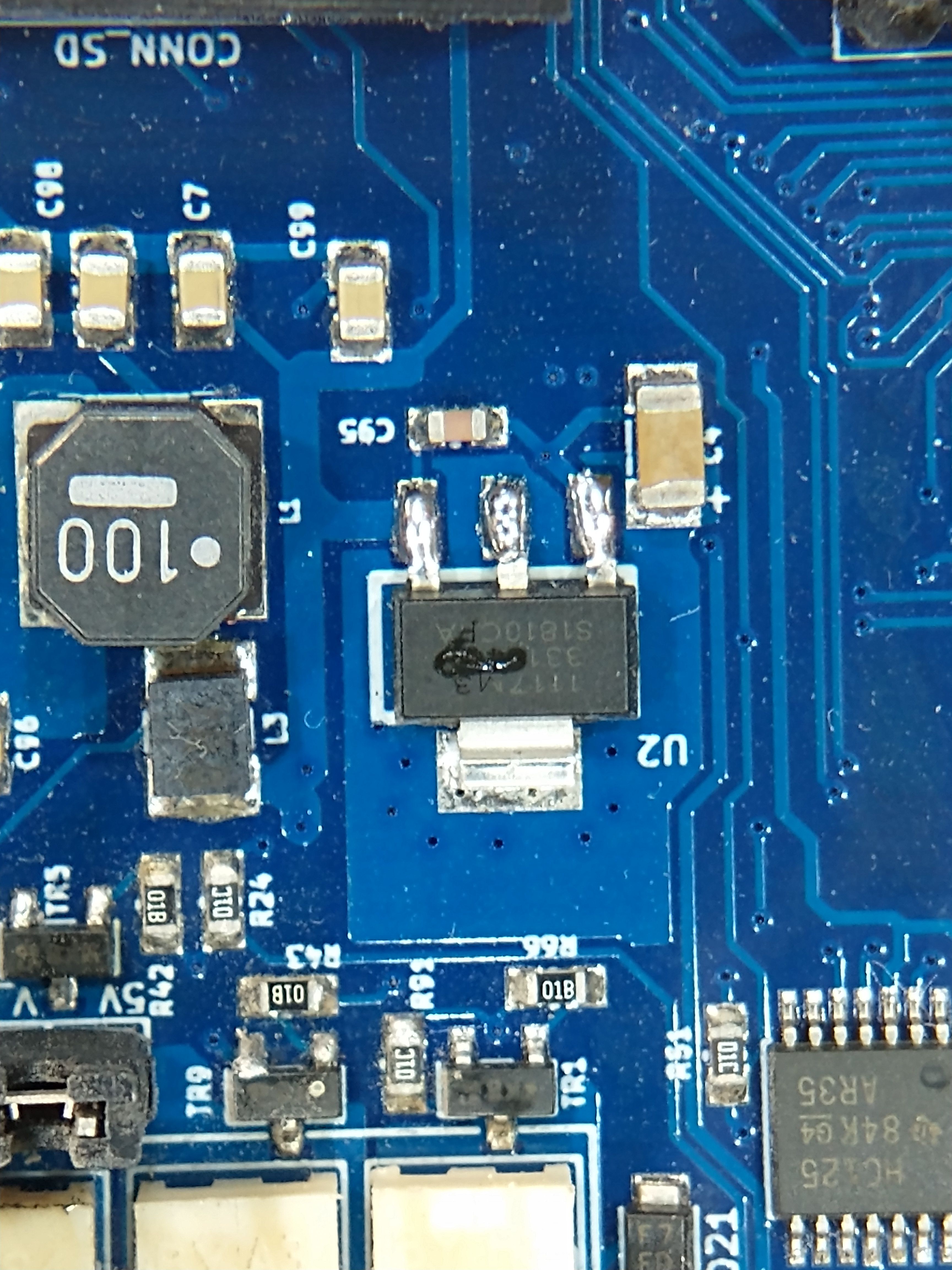

                      @phaedrux Argh. While waiting for a response I cleaned up my wiring. Something shorted I think. USB power works. 24 volt doesn`t but not the power supply.
                      U2 what does it do and does it looked fried to you? Is it repairable?
                      undefined 1 Reply Last reply 19 Mar 2022, 14:53 Reply Quote 0
                      • undefined
                        droftarts administrators @damaged_goods
                        @damaged_goods 3.3v regulator. A relatively easy fix. See https://docs.duet3d.com/User_manual/Troubleshooting/Parts#voltage-regulators-1
