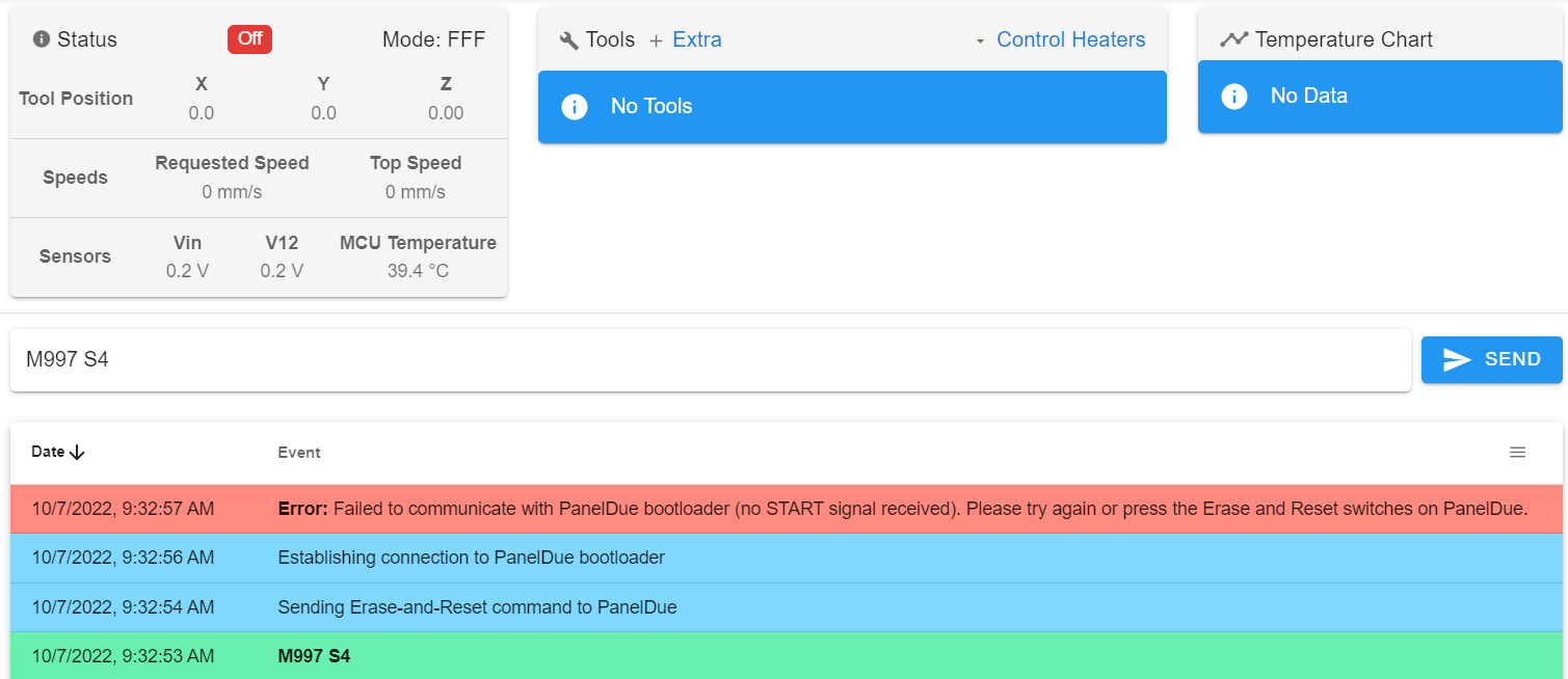

      I tried reflashing the firmware using bossa, and i got the screen back, back it doesn't connect to the duet board. I'm new to this, trying to just install this board, and so it may be a simple solution. I tried installing the firmware manually on DWC using M997 S4 but then get this error: "Error: M997: Aux port 0 is not enabled or not in PanelDue mode". Could someone help me get in the right path with this screen setup?

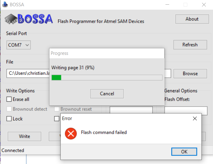

        oliof @CHRISTIAN_LANDRY 0
        @christian_landry-0 if you hit the erase button, flashing firmware from the printer likely won't work. You will need to flash over USB (see https://docs.duet3d.com/en/User_manual/RepRapFirmware/Updating_PanelDue#firmware-update-via-usb).

            dc42 administrators @CHRISTIAN_LANDRY 0
            @christian_landry-0 try sending M575 P1 B57600 S1 (although you should already have that command in config.g) and then M997 S4 again.
            CHRISTIAN_LANDRY 0undefined 1 Reply Last reply Reply Quote 0

              • CHRISTIAN_LANDRY 0undefined
                CHRISTIAN_LANDRY 0 @oliof
                @oliof tried that, it fails at 31%, don't know why
                  CHRISTIAN_LANDRY 0 @CHRISTIAN_LANDRY 0
                  @christian_landry-0 the only way I get it to work is if I have "erase all" checked while also having "boot to flash" checked

                      CHRISTIAN_LANDRY 0 @dc42
                        @christian_landry-0 I just did it a second time, and it's now successful lol

                          Phaedrux Moderator @CHRISTIAN_LANDRY 0
                          @christian_landry-0 said in paneldue 7.0i accidentally pushed the "erase" button:
                          Yes, exactly. Just like the instructions show.
