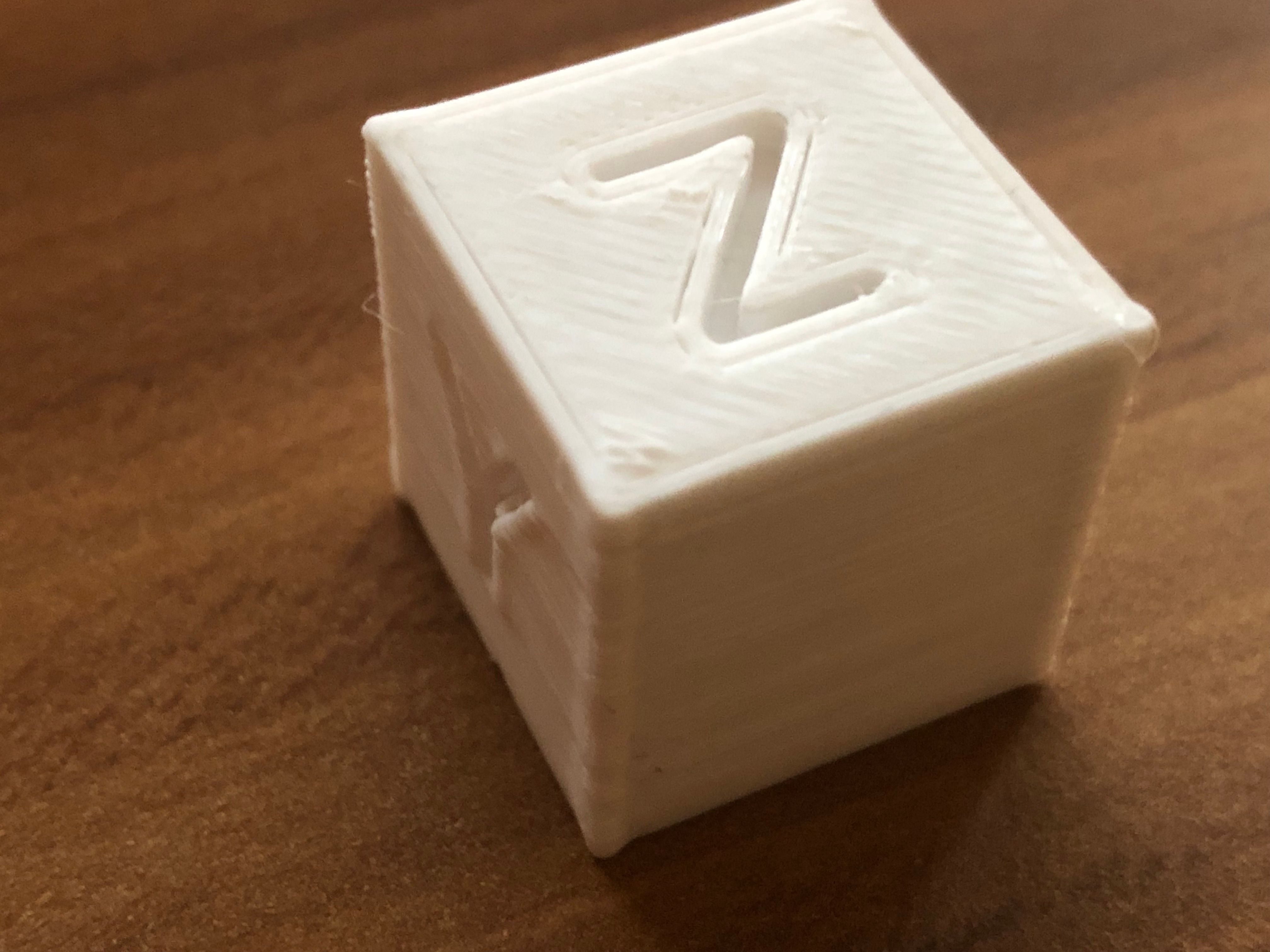

      I have issues to get accurate corners, even if I activate pressure advance (RRF 3.4.0). The first cube is without pressure advance, the second with activated pressure advance. My printer has the classic setup with bowden extruder.
        Without PA, the result looks better.
        This doesn’t tell us how "classic" your printer really is. Depending on the mechanics, your speed and acceleration settings can be way too high. How does a cube look at max. print speed of 30 mm/s (without PA)?
        To try that, set "Maximaler Vorschub" to 30 and "Maximale Beschleunigung" to 100 in your slicer. I'm curious to see what kind of cube you get with these settings 🤓

          my prints also have bulging corners which has been present for a few months. I followed the other topic thread about pressure advance issues which has many responses and discussion but no definitive resolution. I have luck by printing much faster than i normally would and the corners are better.
