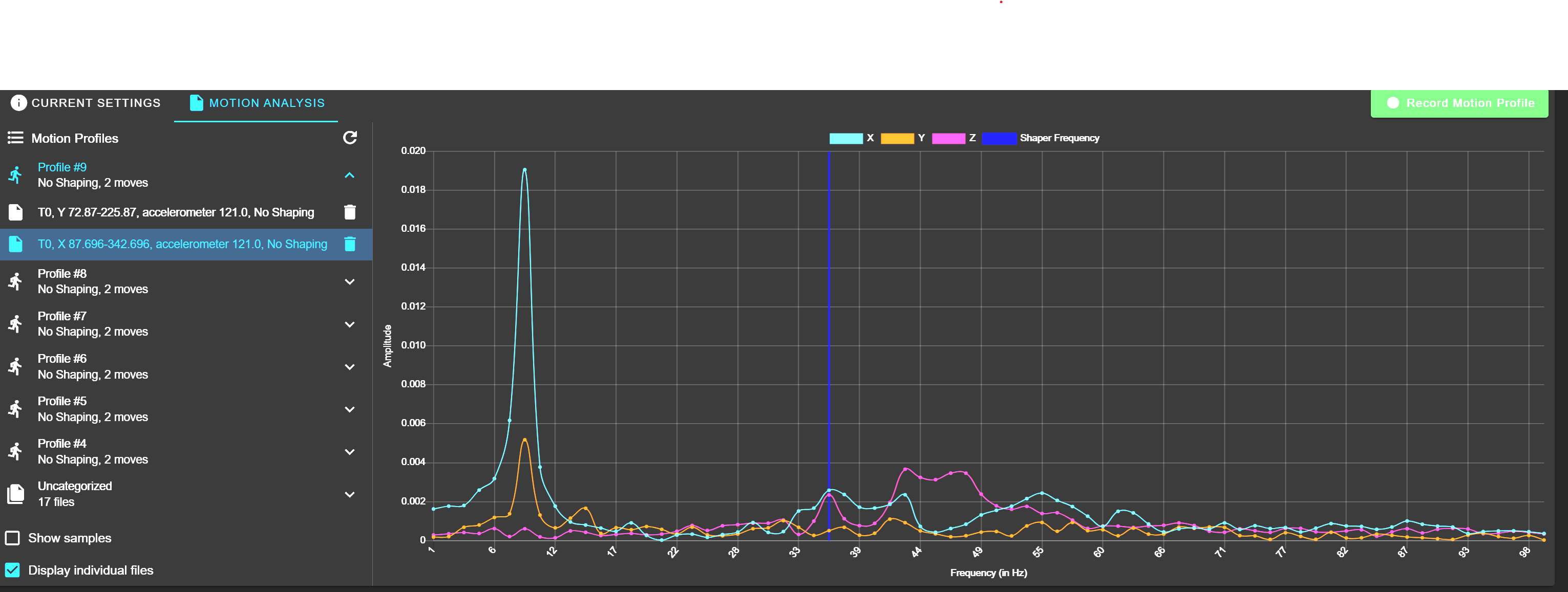

    Based on this graph, do I even need input shaping?
    19
    991
    • gnydickundefined
      gnydick
      What units is the amplitude measured in? At around 1/1000th between 33Hz and 66Hz, should anything even be noticeable?
      Am I interpreting this graph correctly?
        dc42 administrators @gnydick
        @gnydick the units are (acceleration in units of 1G) per Hz. However, it's possible that it it missing a scaling factor. If that's the case, then changing the sample time will also change the apparent acceleration/Hz. I'll do some tests when I have time to check whether the scaling factor is being applied.
        Do you have any ringing/ghosting apparent on your prints? What sort of printer is it?
        gnydickundefined oliofundefined 3 Replies Last reply Reply Quote 0

              @gnydick which axis did you move to get that plot? Please submit a plot when the other axis (out of X and Y) is moved.
              gnydickundefined 1 Reply Last reply Reply Quote 0

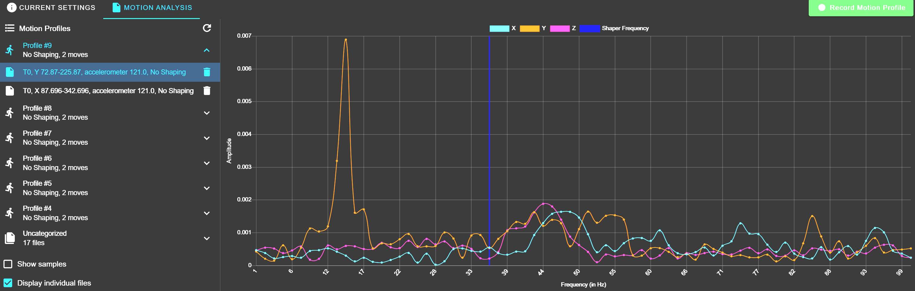

              • gnydickundefined
                gnydick @dc42
                @dc42 the input shaping plugin presents 1 graph for multiple moves. Not sure how it combines them. I'll switch to "individual files" and attach below. The first one is X, the second one Y
                  @gnydick the peaks at 10Hz and 14Hz look odd to me. The frequencies are too low to be resonances unless you have a very heavy hot end and very slack belts. My guess is that they are artefacts from the shape of the move.
                  What X and Y acceleration have you configured? You could try repeating those moves with double the acceleration, to see if those peaks move. Higher acceleration will also make the ringing stronger and easier to see in the plot.
                  You could also take a print that exhibits ringing and estimate the ringing frequency, by dividing the speed at which the perimeter was printed in mm/sec by the wavelength of the ringing in mm. Then we can see whether that frequency matches something that the accelerometer has picked up.

                    gnydick @dc42
                    @dc42 I'm not worried about the 10 & 14Hz peaks. My original post mentioned that I'm looking at the local maxima between 33 and 66Hz.
                    I have a very heavy hot-end, but I don't have slack belts, at least as far as I know.
                    If I tighten them any more, I suspect I'll start damaging bearings, threads, or something else. The RailCore doesn't have fully constrained bolts on the pulleys.
                    Oh, and the fact the number are so small, should they even be noticeable?
                    dc42undefined deckingmanundefined 2 Replies Last reply Reply Quote 0
                      @gnydick I asked what accelerations you have configured because not only could low accelerations account for those low frequency peaks, they might also account for why the values are so low.
