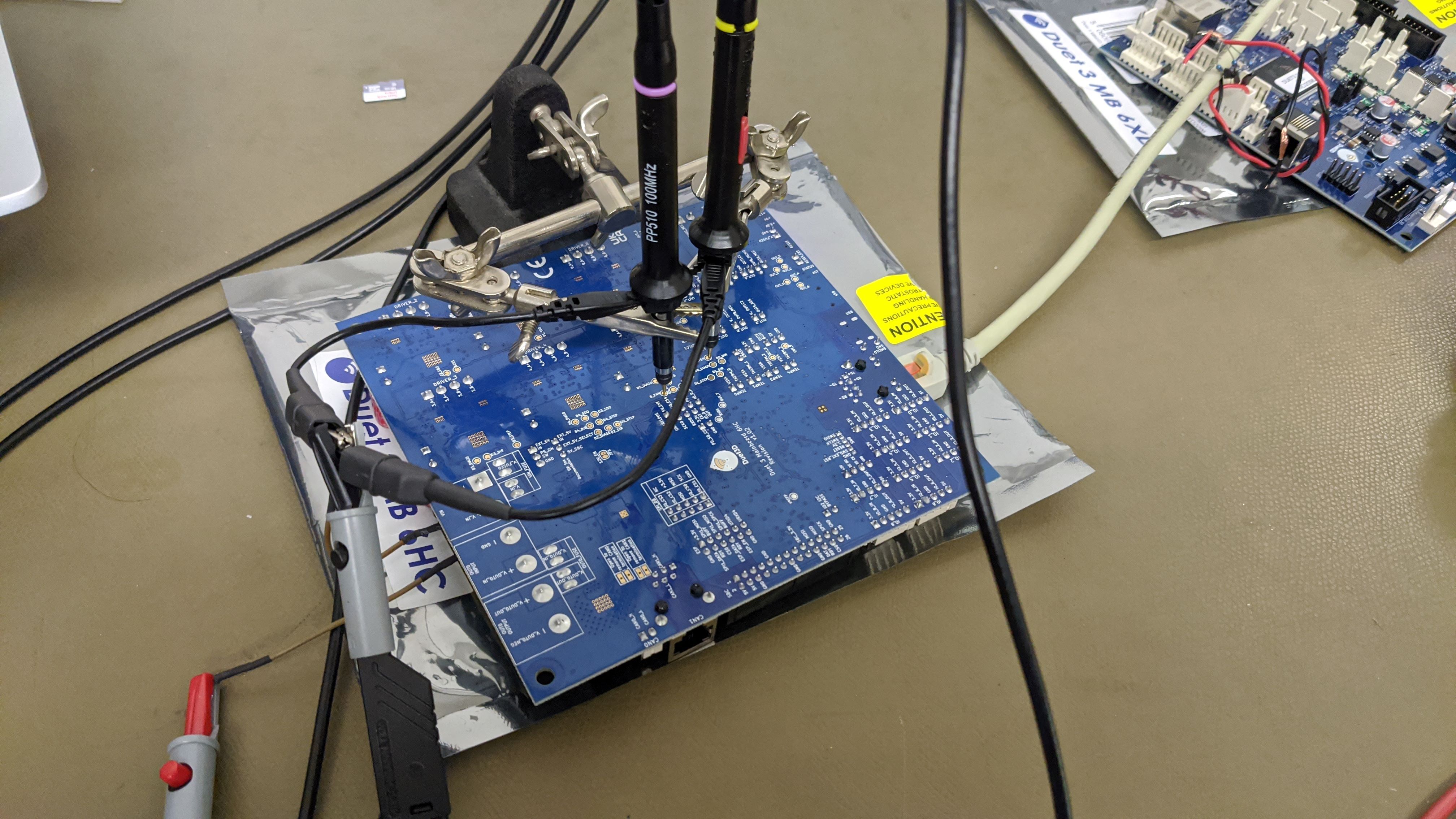

@dc42 the missing MB6HC test.
MB6HC in standalone mode
following config
; Enable network M552 P0.0.0.0 S1 ;CNC Mode M453 ; Select CNC device mode M669 K0 S2 T1 M584 X5 Y0.0:0.1:0.2:0.3 Z4 ; set drive mapping M92 X160.00 Y320.00 Z640.00 ; set steps per mm M566 X1800.00 Y180.00 Z120.00 ; set maximum instantaneous speed changes (mm/min) M203 X15000.00 Y12000.00 Z5000.00 I5 ; set maximum speeds (mm/min) M201 X400.00 Y200.00 Z200.00 ; set accelerations (mm/s^2) ;M564 H0 ; Allow stepper movement before homing ; Axis Limits M208 X0 Y0 Z0 S1 ; set axis minima M208 X600 Y1200 Z170 S0 ; set axis maxima ;Machine Initialization ;M18 ; disable all steppers ;M17 ; enable z stepper so it doesn't fall no delay.
with the following config (added stepper driver timings)
; Enable network M552 P0.0.0.0 S1 ;CNC Mode M453 ; Select CNC device mode M669 K0 S2 T1 M569 R0 P0 S0 T3:3:6:0 M569 R0 P1 S0 T3:3:6:0 M569 R0 P2 S0 T3:3:6:0 M569 R0 P3 S0 T3:3:6:0 M569 R0 P4 S0 T3:3:6:0 M569 R0 P5 S0 T3:3:6:0 M584 X5 Y0.0:0.1:0.2:0.3 Z4 ; set drive mapping M92 X160.00 Y320.00 Z640.00 ; set steps per mm M566 X1800.00 Y180.00 Z120.00 ; set maximum instantaneous speed changes (mm/min) M203 X15000.00 Y12000.00 Z5000.00 I5 ; set maximum speeds (mm/min) M201 X400.00 Y200.00 Z200.00 ; set accelerations (mm/s^2) ;M564 H0 ; Allow stepper movement before homing ; Axis Limits M208 X0 Y0 Z0 S1 ; set axis minima M208 X600 Y1200 Z170 S0 ; set axis maxima ;Machine Initialization ;M18 ; disable all steppers ;M17 ; enable z stepper so it doesn't fall the delay is there again. I think it will fill the following struct (slowDriversBitmap and slowDriverStepTimingClocks), and will cause IterateDrivers to send can messages.

G90 G21 G1 Y0 F60 G1 Y3 F60 G1 Y0 F60 G1 Y3 F60 M112 G1 Y0 F60 G1 Y1 F60 G1 Y0 F60 G1 Y1 F60 G1 Y0 F60 G1 Y1 F60 G1 Y0 F60 G1 Y1 F60 G1 Y0 F60 G1 Y1 F60 G1 Y0 F60 G1 Y1 F60 -

I think it is a success!
without the IterateDrivers fix there is a small delay 1.34s in the step generation shut down, but the drivers are not re-enabled.
