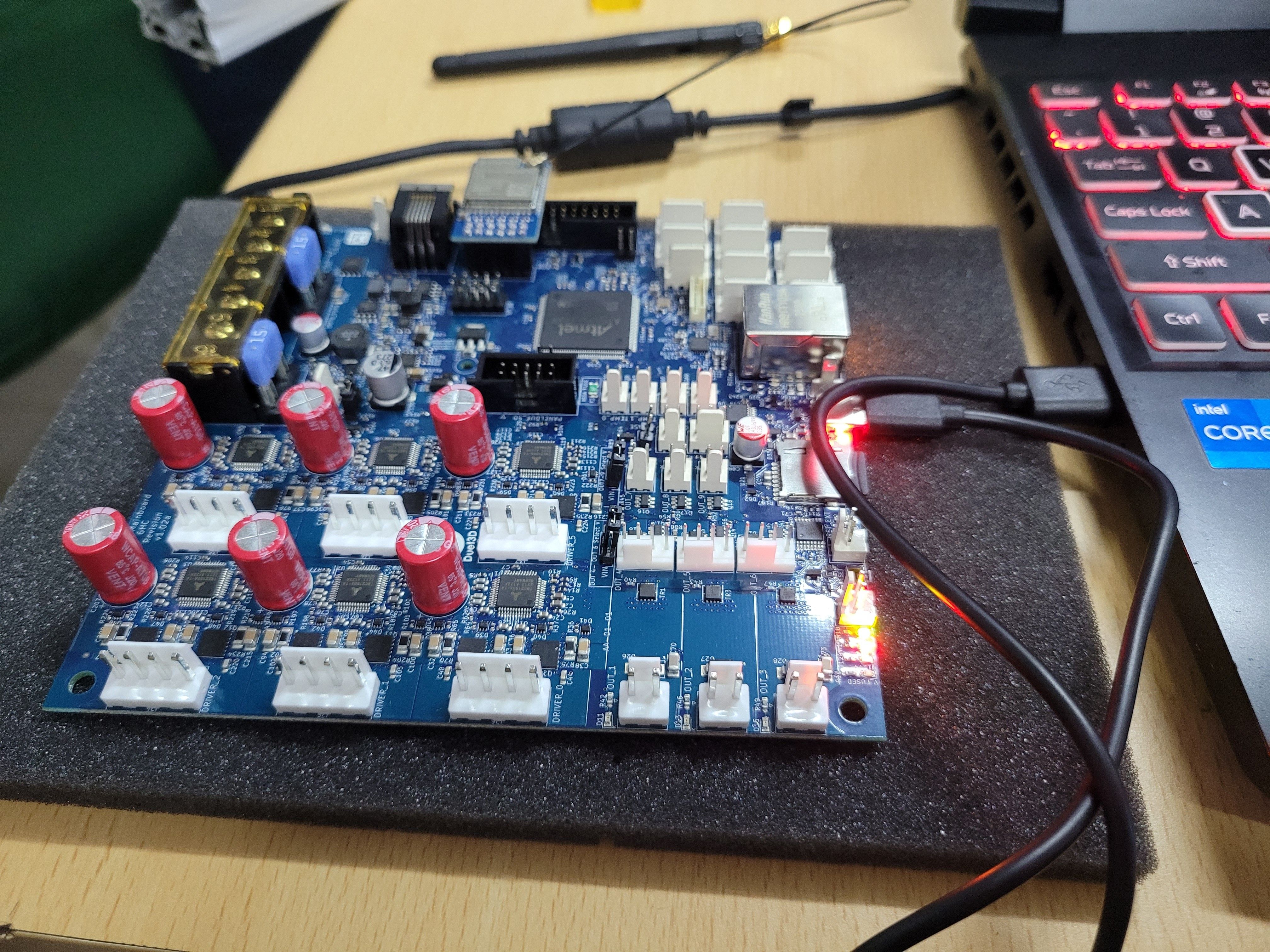

      We recently purchased a duet 3 mainboard 6HC and Duet 3 Wifi module. I tried to connect the wifi module with the board and I used YAT to connect my wifi module. This is the output in the YAT,
      M552 I1 S0
      ok<LF>WiFi module started<LF>
      m552 I1
      WiFi module is idle<LF>ok<LF>
      M587 S"GravityeX" P"123456789"
      ok<LF>
      M587
      Remembered networks:<LF>GravityeX IP=0.0.0.0 GW=0.0.0.0 NM=0.0.0.0<LF>ok<LF>
      M552 I1 S1
      ok<LF>Error: WiFi module reported: no known networks found<LF>WiFi module is idle<LF>
      But when I type M552 it returns,
      M552
      Ethernet is enabled, configured IP address: 192.168.1.14, actual IP address: 0.0.0.0<LF>ok<LF>
      What is the problem and what should I do?

                      I have not used any router, this is the connection of my setup.

                            droftarts administrators @AndrewStaines
                            @AndrewStaines
                            For some reason the WiFi reports it is changingMode, and the WiFi status was not retrieved, so I don't know what version of the WiFi firmware you have installed. Make sure the WiFi module is in idle mode before sending M122, ie after sending M552 I1 S0. My Duet 3 Mini 5+ WiFi reports the WiFi section of M122 as:
                            === WiFi ===
                            Interface state: active
                            Module is connected to access point
                            Failed messages: pending 0, notrdy 0, noresp 0
                            Firmware version 2.1beta4
                            MAC address f4:cf:a2:6f:be:62
                            Module reset reason: Power up, Vcc 3.39, flash size 2097152, free heap 39632
                            WiFi IP address 192.168.1.182
                            Signal strength -66dBm, channel 6, mode 802.11n, reconnections 0
                            Clock register 00002001
                            Are you trying to connect the Duet to your laptop's WiFi, and running the laptop as an access point? Check the network name, password and band (click Edit to set the band) are set correctly in Mobile hotspot (assuming Windows). I would tend to not force the IP address, gateway and mask; the access point should do this for the Duet. You will need to delete the existing 'Remembered network' if you want to set up a new one, as it will default to trying to connect on the first, so send M588 S"*" and then add the SSID and password again with M587.
                            You can test if the WiFi sees any WiFi network by getting it to do a scan, as you are on RRF 3.5.0-rc.1. Enable the WiFi with M552 I1 S0, then send:
                            M587.1
                            wait 10 to 15 seconds for it to perform a scan, then send
                            M587.2
                            It should report the WiFi networks it can find, for example this is mine, :
                            24/11/2023, 13:12:59 	M587.1
                            24/11/2023, 13:13:08 	Connection interrupted, attempting to reconnect...
                            HTTP request timed out
                            24/11/2023, 13:13:09 	Connection established
                            24/11/2023, 13:13:29 	M587.2
                            Network Scan Results:
                            ssid=DIRECT-87-HP ENVY 5540 series chan=6 rssi=-37 phymode=n auth=WPA2-Personal mac=XX:XX:XX:XX:XX:XX
                            ssid=BT-3HATHX chan=6 rssi=-66 phymode=n auth=WPA2-Personal mac=XX:XX:XX:XX:XX:XX
                            ssid=EE WiFi chan=6 rssi=-67 phymode=n auth=Open mac=XX:XX:XX:XX:XX:XX
                            ssid= chan=6 rssi=-67 phymode=n auth=WPA2-Personal mac=XX:XX:XX:XX:XX:XX
                            ssid=BT-ZJCJ3G chan=11 rssi=-78 phymode=n auth=WPA2-Personal mac=XX:XX:XX:XX:XX:XX
                            ssid=EE WiFi chan=11 rssi=-78 phymode=n auth=Open mac=XX:XX:XX:XX:XX:XX
                            ssid=EE WiFi chan=1 rssi=-80 phymode=n auth=Open mac=XX:XX:XX:XX:XX:XX
                            ssid= chan=1 rssi=-80 phymode=n auth=WPA2-Personal mac=XX:XX:XX:XX:XX:XX
                            ssid= chan=11 rssi=-81 phymode=n auth=WPA2-Personal mac=XX:XX:XX:XX:XX:XX
                            ssid=Tenda chan=6 rssi=-90 phymode=n auth=WPA/WPA2-Personal mac=XX:XX:XX:XX:XX:XX
                            ssid=EE WiFi chan=6 rssi=-91 phymode=n auth=Open mac=XX:XX:XX:XX:XX:XX
                            ssid=TALKTALK73BA90 chan=6 rssi=-91 phymode=n auth=WPA2-Personal mac=XX:XX:XX:XX:XX:XX
                            (I have obscured the mac address)
                            If it reports any error message for any of the above, please post it.
                            • fcwiltundefined
                              fcwilt @AndrewStaines
                              @AndrewStaines
                              If you don't have a router what does your laptop connect to? Something must be serving as a WiFi Access Point.
                              Thanks.
                              Printers: a small Utilmaker style, a small CoreXY and a E3D MS/TC setup. Various hotends. Using Duet 3 hardware running 3.4.6
                              AndrewStainesundefined 1 Reply Last reply Reply Quote 0
                              • AndrewStainesundefined
                                AndrewStaines @fcwilt
                                @fcwilt
                                Thank You for the clarification. Now I get it. I have tried it via router and now it works fine.
                                • AndrewStainesundefined AndrewStaines has marked this topic as solved
