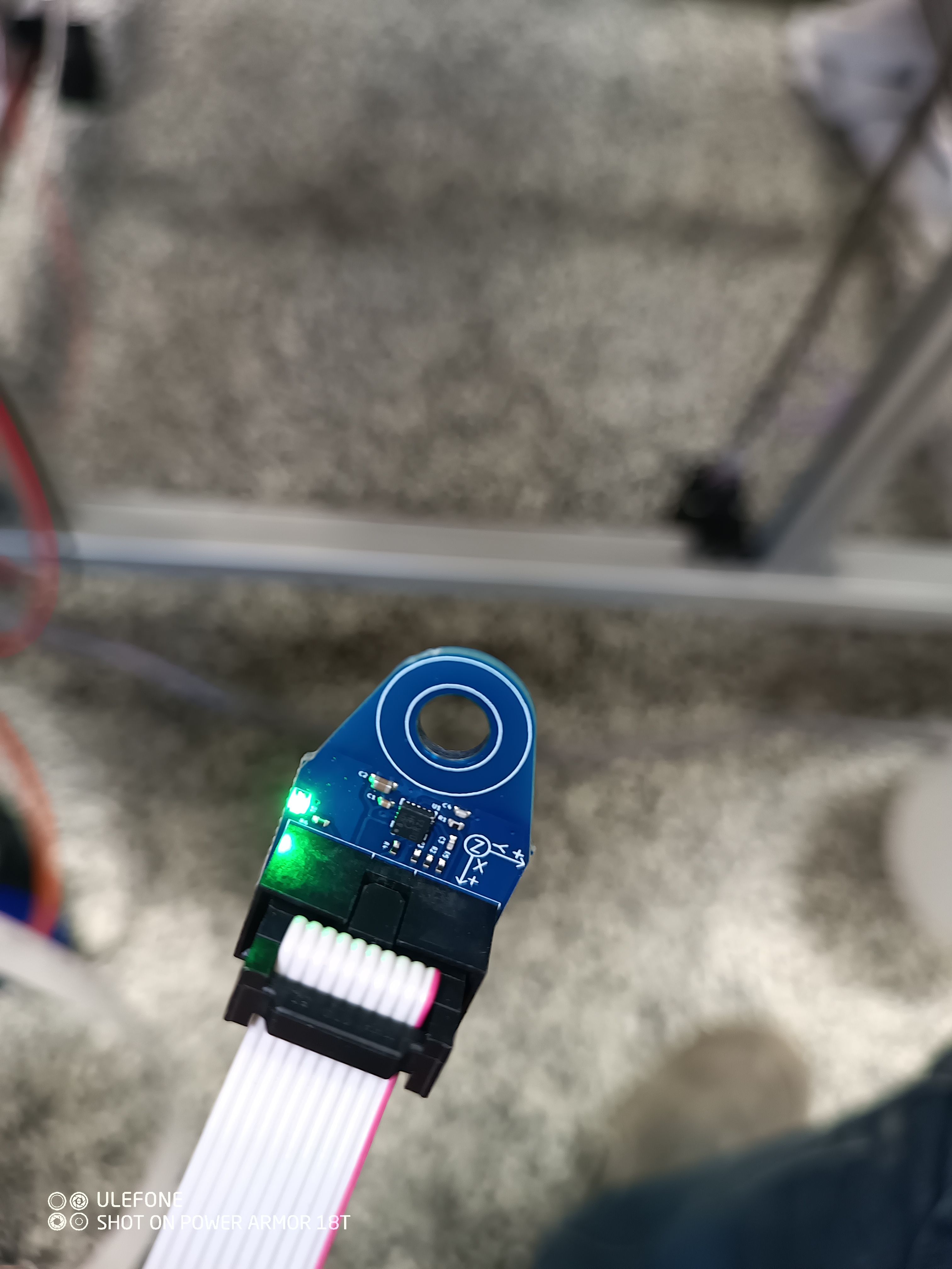

      Hello, As the title says I'm having issues with an accelerometer (Duet3D).
      Electronics Diagnostics
      Product Short Name Version
      Duet 2 WiFi 2WiFi 3.5.0-rc.3
      Duet WiFi Server n/a 2.1beta7
      Duet Web Control DWC 3.5.0-rc.3
      M955 P0 C"spi.cs6+spi.cs5" I61
      Wiring connected to Duex5 Temp Daughter Board with no daughter board and supplied ribbon cable. I have tried different cables same length and shorter. Tried the 1k resistor. Short of making a USB3 cable ( I will do this tonight) I think I have crossed everything off the list I have found on this forum. I do get a green light on the accelerometer board. Any help will be appreciated
      jay_s_ukundefined droftartsundefined 2 Replies Last reply Reply Quote 0
        jay_s_uk @myersm1234
        @myersm1234 can you post some photos of your installation?
        myersm1234undefined 2 Replies Last reply Reply Quote 0

              • myersm1234undefined
                myersm1234
                Here is what I have.
                M115
                FIRMWARE_NAME: RepRapFirmware for Duet 2 WiFi/Ethernet FIRMWARE_VERSION: 3.5.0-rc.3 ELECTRONICS: Duet WiFi 1.02 or later + DueX5v0.11 FIRMWARE_DATE: 2024-01-24 17:56:24
                Tried on Duet 2 board with daughter board removed
                M955 P0 C"spi.cs2+spi.cs1" I61 .
                No Luck!

                                      droftarts administrators @myersm1234
                                      @myersm1234 I have replicated your setup on my bench, with a Duet 2 WiFi and Duex, using RRF 3.5.0-rc.3 and a copy of your config.g
                                      I tested with the accelerometer plugged into the Duet directly first, then the Duex. I plugged in a PT100 board and a thermocouple board, and tested with the accelerometer in those, too, updating the accelerometer configuration in all positions:
                                      18/04/2024, 13:54:43 	M115
                                      18/04/2024, 13:55:19 	M955 P0
                                      Accelerometer 0 type LIS2DW with orientation 61 samples at 1600Hz with 14-bit resolution, SPI frequency 2000000
                                      18/04/2024, 13:59:40 	M955 P0 C"spi.cs6+spi.cs5" I61
                                      18/04/2024, 13:59:45 	M955 P0
                                      18/04/2024, 14:00:32 	G92 X0 Y0 Z0
                                      18/04/2024, 14:00:41 	G4 S1
                                      Error: Attempt to move motors when VIN is not in range
                                      18/04/2024, 14:03:56 	M955 P0 C"spi.cs4+spi.cs3" I61
                                      18/04/2024, 14:04:01 	M955 P0
                                      18/04/2024, 14:04:14 	M955 P0 C"spi.cs2+spi.cs1" I61
                                      Error: M955: Accelerometer not found on specified port
                                      18/04/2024, 14:05:08 	M955 P0 C"spi.cs8+spi.cs7" I61
                                      18/04/2024, 14:05:14 	M955 P0
                                      As you can see, it was recognised when plugged in in all places! I was able to record motion profiles in the Input Shaping plugin in DWC and view them; these are the 'Error: Attempt to move motors when VIN is not in range' messages, as obviously I don't have any motors connected. I could wave the accelerometer around and it picked up the movement.
                                      So I don't think this is a firmware or configuration issue, and looks like a hardware fault. I think the chances of both your Duet and Duex Temp_DB inputs failing is remote, especially as you have run temperature daughterboards in the past, and that either the cable or the accelerometer is faulty. If you have a multimeter, you could check the cable for continuity of each wire.
                                      However, I think it would be best to swap your accelerometer for a new one. Where and when did you purchase it?
                                      Please send an email to warranty@duet3d.com and CC your reseller. Include a link to this forum thread and the details of your original purchase. You'll receive a reply with a form to fill out.
