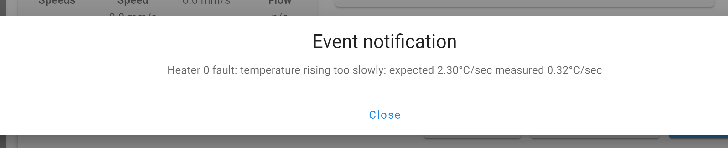

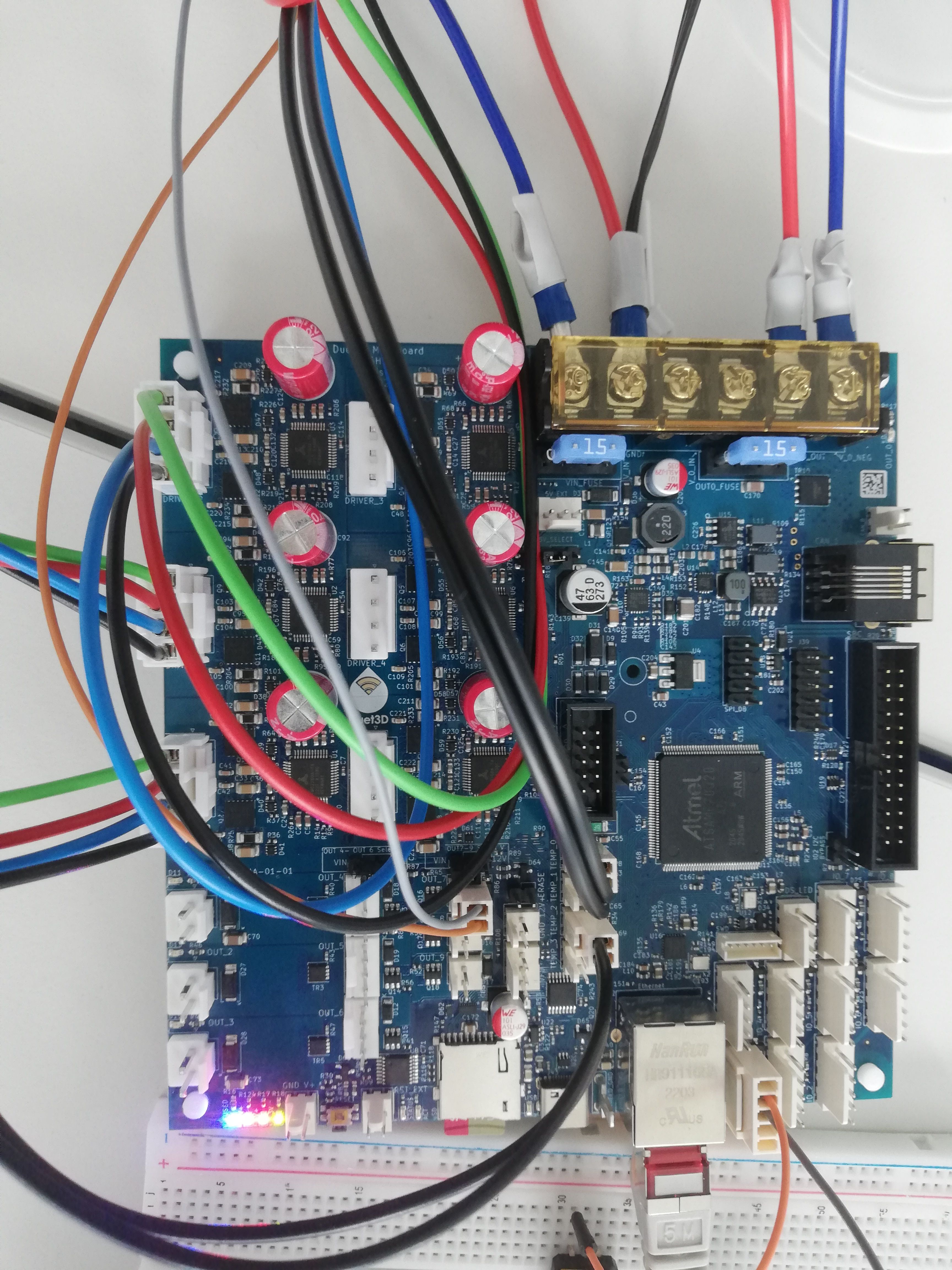

      Can you please help me debug what might be the issue when my heating bed is not heating? When I send the M140 S55 command it activates the bed heater but the current temperature does not change and then it gives an error (as in the image). I cannot acces the bed thermistor, but I believe that it works well, because it shows the same room temperature as my chamber thermistor.

        @qlqlo you have no power in for the out0 connection
        no power in = no power out

          @jay_s_uk Omg, you are right. Now it works but I still get this error. How can I fix it?
