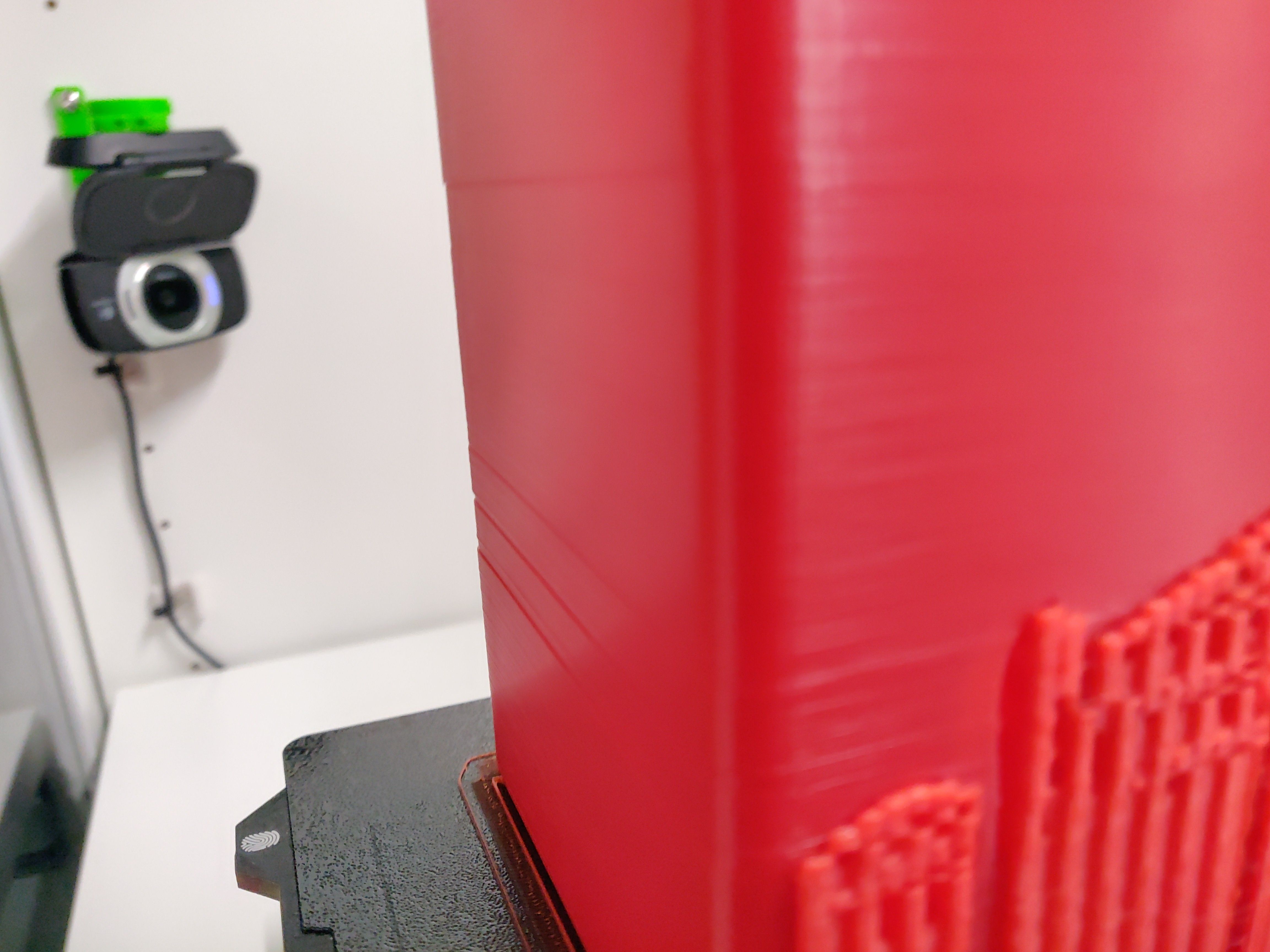

      Hello together,
      I have a little bit of a weird problem with layer shift only in Y-Direction.
      First of all the 3D-Printers details:
      Model: Caribou Duet 320
      Board: Duet2 Wifi
      Firmware Version: 3.5.3
      Filament: Sunlu PLA (Hotend @195°C, Bed @55°C)
      Slicer: Caribour Slicer 2.8.0 (based on PrusaSlicer)
      This is my first 24h+ print job.
      The part is also so far my biggest and heaviest one.
      With all print jobs before I do not have a issue like this.
      Some layers are shifted toward the back side, but comming back after a couple of layers to the original value.
      I do not see this shifts when checking the g-code with g-code viewer.
      So far I have checked belt tension recently, it is within tolerance.
      On the Y-Axis I use a MT-1704HSM168RE (also known as MT-1704HSM168A) stepper with the following values in config.g:

      IMG_20240924_060123.jpg IMG_20240924_060033.jpg IMG_20240924_060015.jpg IMG_20240924_055820.jpg
      Should I raise the motor current a little bit or what might be the solution here?
      Thanks a lot,
      Regards Kubunter

        @Kubunter I think, the motor current isn't the problem as the layer shift is coming back.
        Are these shifts also visible on the other side of the part? Or only at one side?

          @cosmowave Thanks for your reply.
          The shifts are visible through the complete layer.

            @Kubunter Could it be a mechanical problem? When you print another model with that height, do you also have layer shifts?

                droftarts administrators @Kubunter
                @Kubunter It's interesting that it goes back to the original position after the shift. Skipped steps don't usually do that. I'd think this is more indicative of a very slightly loose belt pulley on the Y motor, though I'd expect more shifts than just a couple.

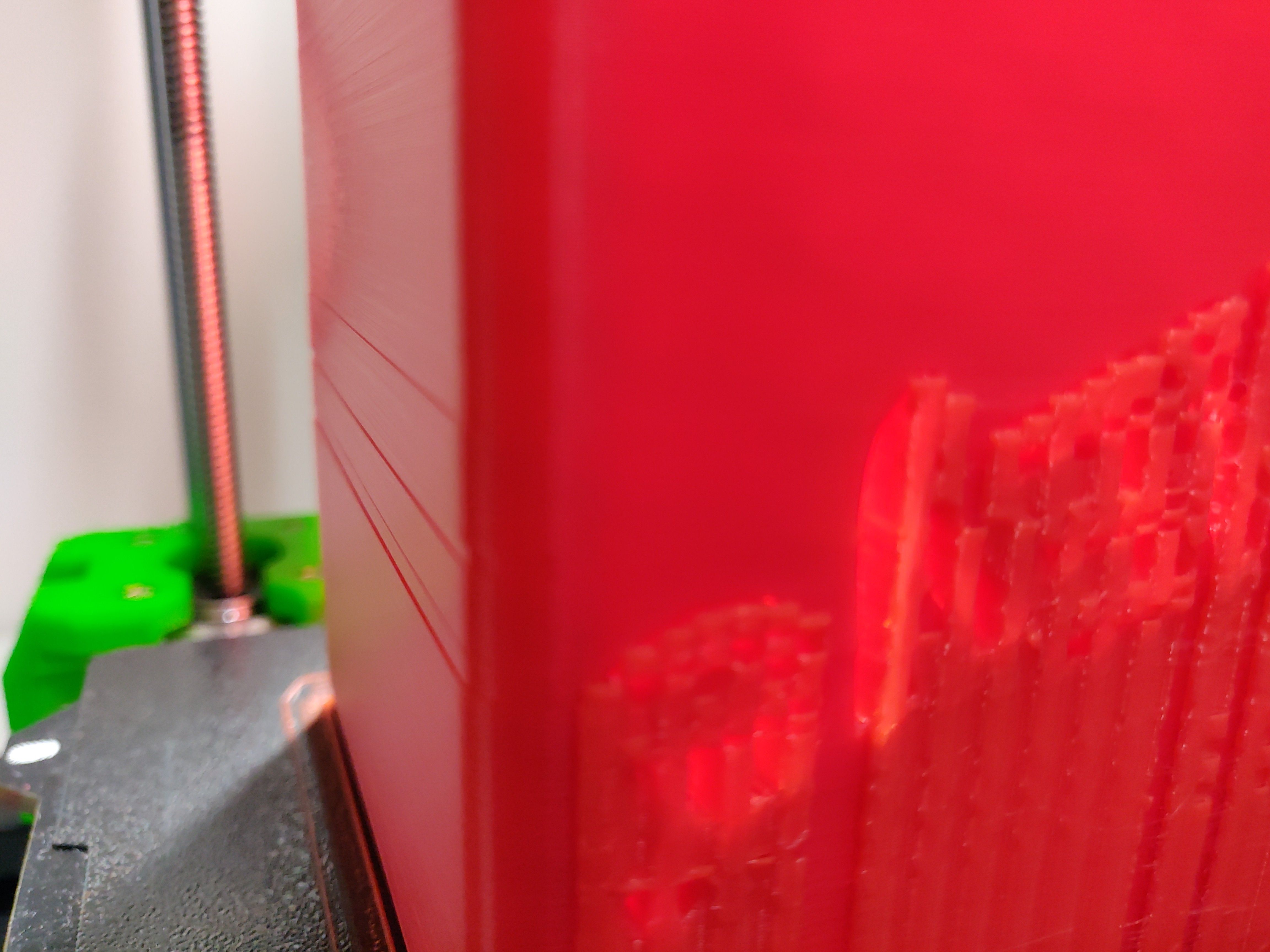

                  @droftarts Thats what I also think about after my test print yesterday.
                  But so far I was able to reproduce the shift.
                  The test print was shorter on the Y-Axis (that is maybe why the shift is not that noticeable than on the print before).
                  IMG_20240925_055639.jpg IMG_20240925_055614.jpg IMG_20240925_055608.jpg IMG_20240925_055532.jpg
                  Additional the Z-Axis position when it appears was lower.
                  This time it looks like the shift remained.
                  But so far I do not understand why it needs a couple of mm (on the last print 32.2mm) to appear.
                  Maybe it depends on the weight of the printed part, leading to the conclusion that pulley might be slightly loose.
                  I will check belt tension and pulley assembly on the stepper motor shaft, then I will repeat the last testprint.
                  Thanks a lot,
                  Regards Kubunter

                    so yesterday I checked the pulley, both worm screws were absolutely tight, no movement of the pulley on the motor shaft at all.
                    I reduced the Y-Axis belt tension a little bit from 115 to 90Hz.
                    I printed a test part, the same layer shift in 2 layers appears.
                    But then I recognized, that the layer shift happens in a layer where some letters are extruded through the part and at exactly the layer where I see the shift, the extruded letters have a damage.
                    After this i started up Fusion and removed the letters from the test part.
                    The next test part without the letters comes out absolutely smooth without any layer shift.
                    So is it possible that the nozzle collides with small printing errors, leading to a shift of the Y-Axis?

                      @Kubunter said in Weird partial layer shift:
                      That can be. But normally when that happens, the shift isn't "comming back" and remains for the rest of the print.
                      But nice, that you've found the problem!
                        If that's the case, I would think that it is an extrusion issue, possibly with the nozzle slowing down when it prints the letters, and when it speeds back up there's a lag in extrusion. If that's the case, try tuning pressure advance.
                        It could also be a slicing problem. Maybe there's hole in the mesh so the Gcode is generated incorrectly, or the text is messing up the Gcode generation in another way. Can you see the shift in the Gcode preview?
