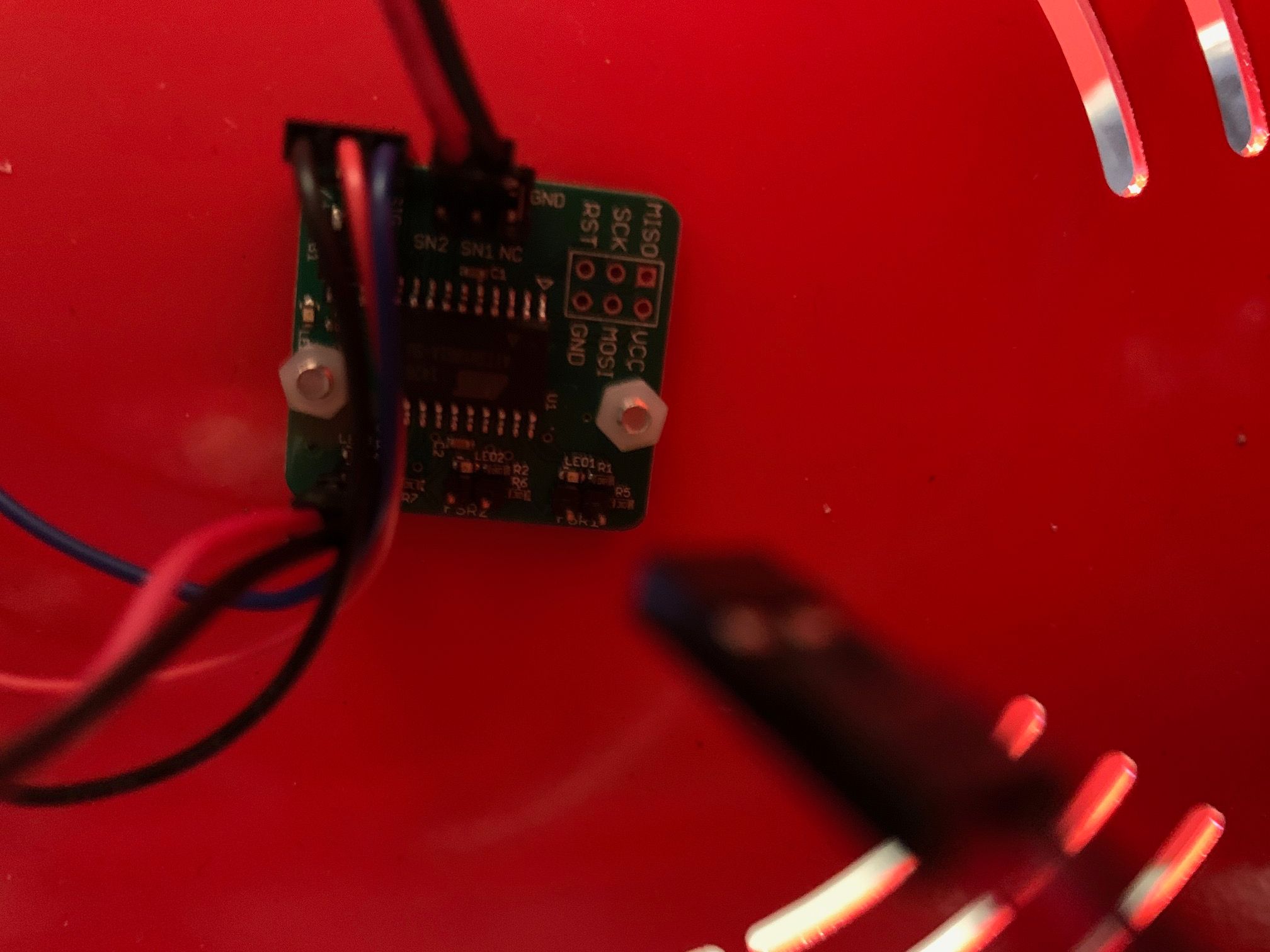

                      Do you know how I set this right in the config.g?
                      Please help me to get the calibration right. Every time I push "delta calibration" my previous (G92 Z0) is changed to something else (Z=0 but nozzle is about 6mm above bed).

                          I think that's probably a bed attached piezo probe. It detects the nozzle contact tap.
                          You won't be able to print anything until you have the probe configured and are able to complete a delta calibration and bed mesh. Without an accurate mathematical model of your delta nozzle positioning won't be accurate enough.
                          Can you get a clearer shot of that little PCB? As well as a photo and description of where the wires from that PCB are connected to your Duet? With that information I can hopefully guide you in configuring it.
                                The 3 wires go to the E0 Endstop on the board.
                                The stepper for extrusion and retracting is attached to E0 Stepper

                                        Phaedrux Moderator @thomasvanderwal
                                        @thomasvanderwal said in Duet 2 v1.02 not responding:
                                        @Phaedrux
                                        bed.g config.g homedelta.g
                                        ;G31 Z-0.700
                                        You'll want to configure the probe offset. In your case the X and Y distance is zero, because the nozzle tip is the probe point. The Z value will need to be calibrated. -0.7 may be accurate. The value is negative because the nozzle is pressing into the surface of the bed slightly.
                                        G31 K0 X0 Y0 Z-0.7
                                        The steps for testing and calibrating a probe are here: https://docs.duet3d.com/en/User_manual/Connecting_hardware/Z_probe_testing
                                        thomasvanderwalundefined 2 Replies Last reply Reply Quote 0

                                          • thomasvanderwalundefined
                                            thomasvanderwal @Phaedrux
                                            @Phaedrux It's still not clear to me what kind of probe I have got. If I have the configuration right for the probe I have declared now (see history). Something is not right. Also mesh compensation is doing strange things. I think I declared it right for my Delta : M557 R100 S10. But the nozzle goes down and to the x axis and off the bed.
