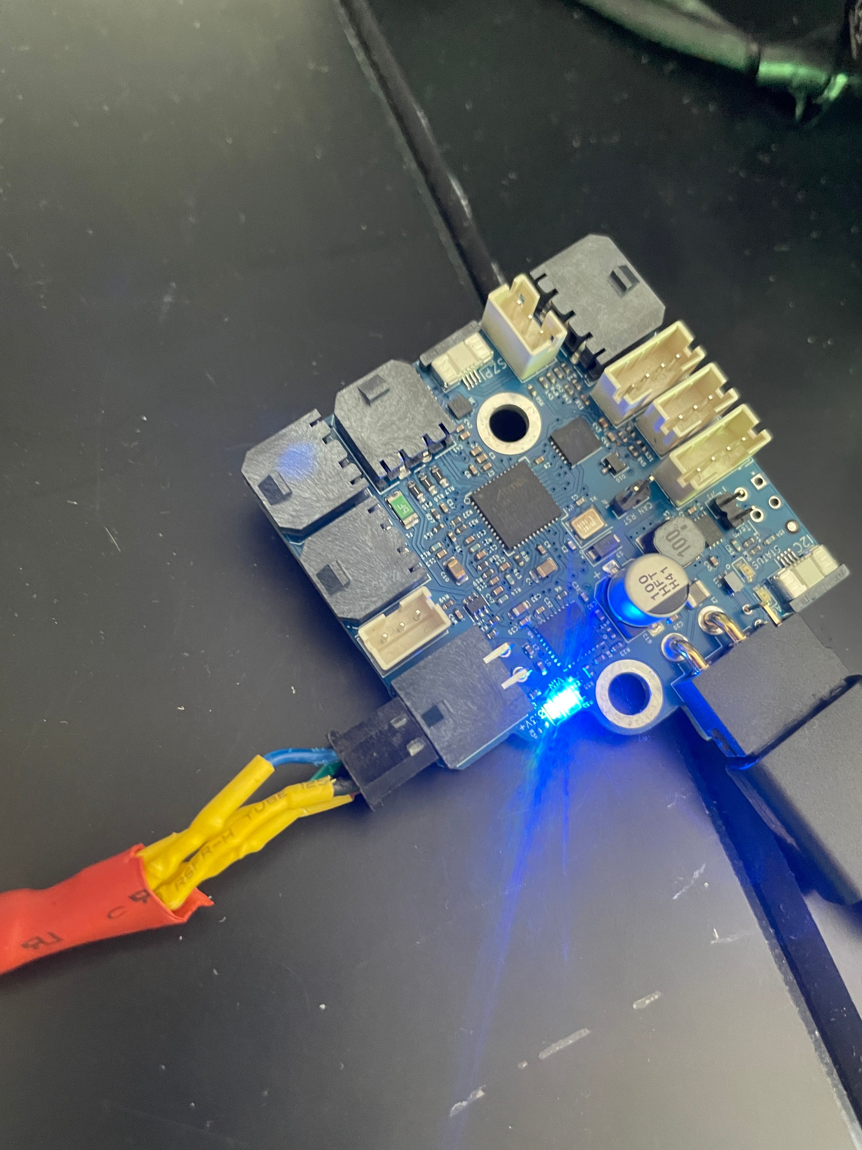

      Does this mean it is supposed to be working the way I initially wired it?
        droftarts administrators @Timothee Leblond
        @Timothee-Leblond You need a 5V supply, and a separate 5V PWM signal to activate the probe. Currently you're using io0.out, which has a 3.3V signal level. Using the 5V PWM header (red arrows) for 5V, servo control (out6-buff) and GND, use IO6.in for the signal wire.

          Hallelujah! The probe is now working with this wiring! THank you!

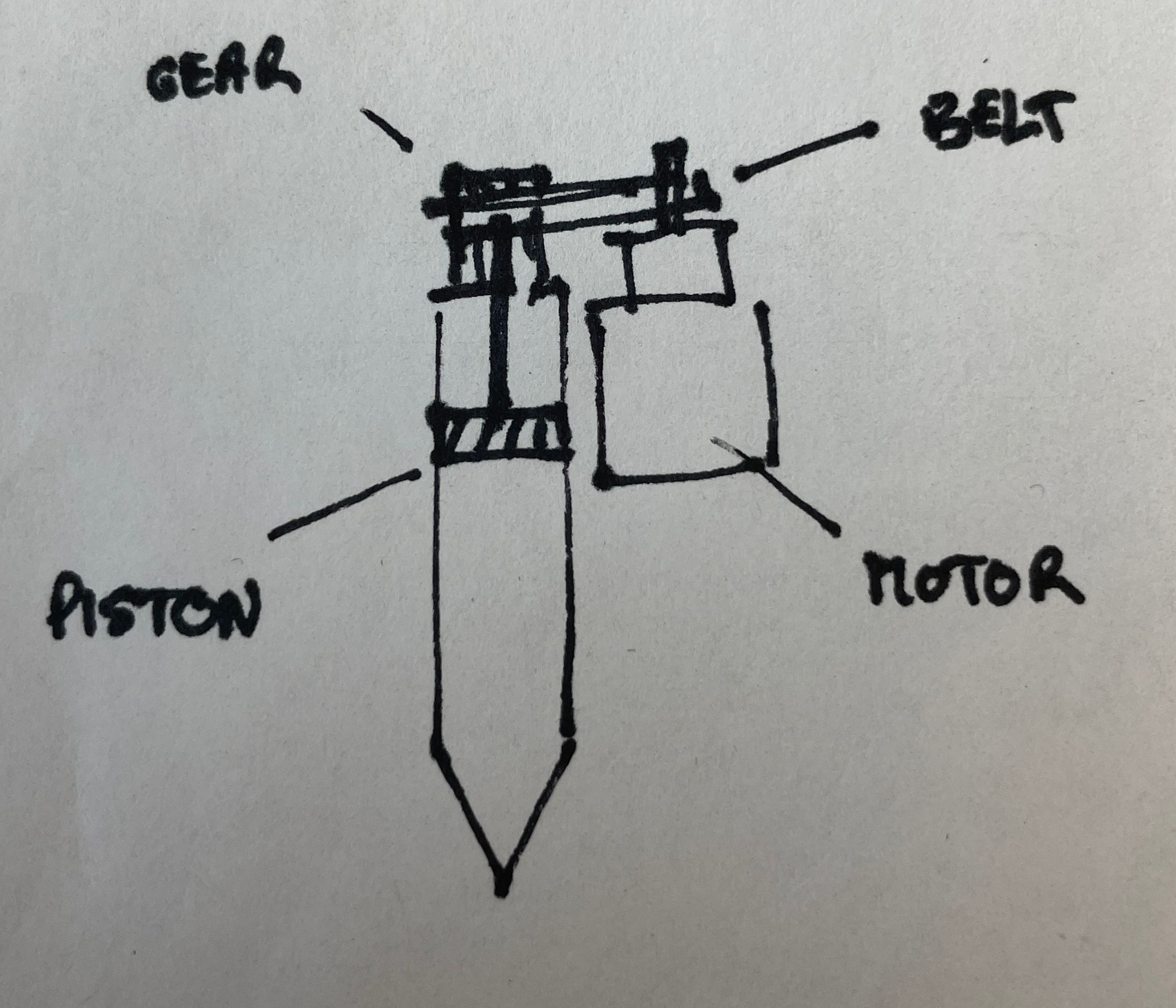

                  My tool is a bioprinter (cold extrusion) so I cannot really follow the guide infortunately. The system is as follows:
                  I actually don't know how am I suppose to configure the firmware for this.
                  Thank you,
                  Tim
                    @Timothee-Leblond You probably want to set it, at least to start with, as the number of steps for 1mm movement of the piston. It will be based on the size of the pulleys driving the belt (though if they are the same, can be ignored), and the thread pitch of the nut that drives the piston.

                      So I have a T5 200mm (pitch of 5mm) belt. The pulley driving the piston has 20 teeth and diameter of 29.5mm. The pitch of the belt is 5mm which is the same as the pulley's pitch. The motor has a step angle of 0.35 with a gear box reduction of 5.18:1. So I end up with the following calculations:
