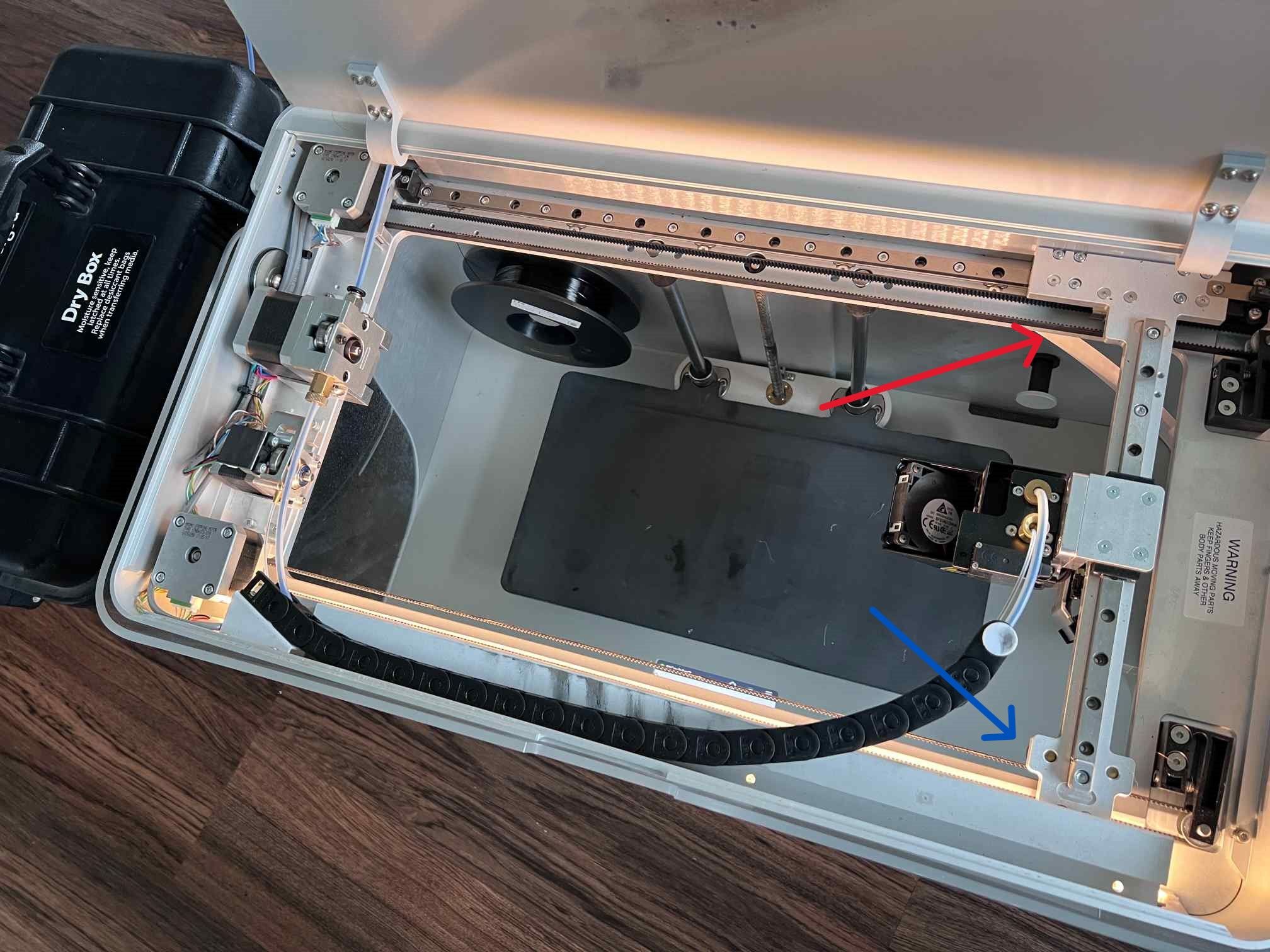

Does Duet support this kind of Kinematics?
Apologies all, This is the Markforged Kinematics. Next time ill look before i post!

I'm currently debating how to add an additional horizontal axis to my printer.
I am slightly nervous about pulling the Y axis from one side - as per the kinematics you are investigating - as I wonder if the gantry will stay straight - so will probably go for double y axis belts (as per Ratrig VCore4 Idex) - but that does mean two motors for one additional axis.
I guess with your kinematics the Y gantry will get pulled slightly from the left side too due to the friction from the 3 idlers and the print head bearings.

@dwuk I also have a minor concern about driving the Y Axis from one side. However I don't think that this motion system is subjected to the same kind of "Racking" forces as an H-Bot. Depending on your build volume you can probably get away with adding just making your XY motion system sufficiently rigid and appropriately dimensioned for the task as MarkForged seems to have done here.
Notice on the Y drive side (Red Arrow) they are running two guides. A single guide would behave like an axis of rotation when subjected to moment loads while using two guides leads to more lateral loading of each guide which they are much more capable of handling while minimizing deflection. This is a small detail that makes a big difference.
The other side (Blue arrow) only has one guide. You could have a belt driven rotary shaft drive both Y axis belts eliminating the need for the third motor.
If you decided to follow the route that MKFG did here be mindful that adding a second guide to your rail could cause binding or non-smooth motion if your mounting surfaces to the rail mount or X-Axis member are not sufficiently flat.
My next build will be 350x350 so for the sake of overkill I'm just going to use two guides on each Y rail and drive both ends of the X- Axis member.

It is amazing how well those linear rails work - for short things like little extra Z Axis' I am putting in my printer - without a linear rail they need a lot of lifting force, but when you add in a linear rail and push from quite a long way off the to side they still work quite well.
Mine build surface is currently 350x350 - but I would like to go at least 100mm larger - so I suppose I should stick to two belts - just a shame as that means two extra motors per extra axis on a flying gantry.
