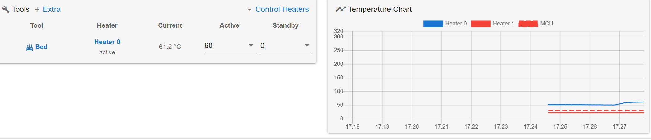

      Using the M140 documentation, if you have 2 or more bed heaters, you start to run into issues if you want to heat up both bed heaters
      https://docs.duet3d.com/User_manual/Reference/Gcodes#m140-set-bed-temperature-fast-or-configure-bed-heater
      Using M140 S60, only the first bed heater heats up
      Using M140 H0 S60, followed by M140 H1 S60, it only heats up the second bed heater
      You have to use M140 P0 S60, followed by M140 P1 S60 for it to work properly
      Sadly M140 P0:1 S60 doesn't seem to work

          At the moment, using M140 P0 H0:1 doesn't seem to work very well. If I then send M140 P0 S60, it will only heat it up on heater 0, not on heater 0 and heater 1
          I'm using the above code, but now with M140 P0 H0:1 instead of the two separate lines
          With that, M140 P0 S60 only heats up H0, and M140 S60 does the same
            droftarts administrators @ComedianTF2
            @ComedianTF2 I'm checking with @dc42, but that was the way I thought it should work, that you define a bed with the heater 'zones' that you want to use. Unfortunately M140 P0 doesn't report the bed heaters that are assigned to it.
            What firmware version are you using? Please send M122 and post the response.
