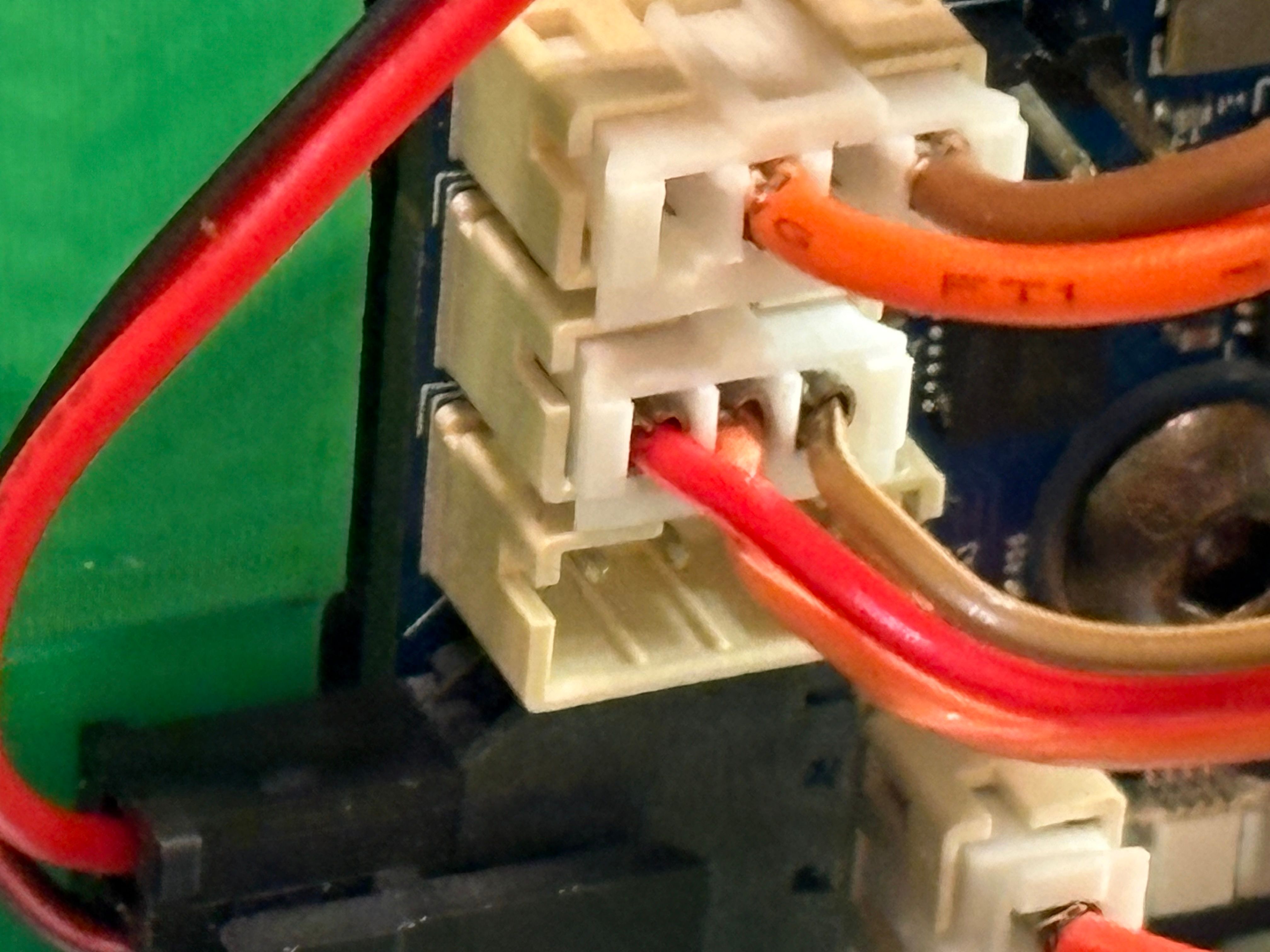

                      it sounds like you're not getting anywhere. I would suggest that you do the following:
                      • post your full config.g
                      • try to get a good picture of the wire connections at the pz probe pcb and the toolboard pcb to show how it is wired (and post it here)
                      • verify that when you tap the nozzle, the triggered light on the pz probe flashes
                      • verify that when everything is idle that the probe status shows 0
                      • verify that when you tap the nozzle, the probe status flashes to 1000
                      If one of those things don't work, that's the first problem you need to fix.
                      if all that works, then I would manually (or via a G92 Z0 G1 Zxx) make sure that you have a large space between your nozzle and your print bed and then run G30 S-1. Let the probe run a for a couple of seconds to make sure it isn't false triggering and then tap the nozzle. If it doesn't stop, hit emergency stop.
                      If you want to try those steps and report back along with your full config.g, I (or someone else) may have a suggestion.
                      SpeedyDadundefined 1 Reply Last reply Reply Quote 0

                            OK, Here are the results of above:
                            My connections to the Roto toolboard are as follows. Red from the PZ Board = io1 +3.3v. Orange from PZ Board = io1.in. Brown from PZ Board = GND. I have verified continuity at both ends of the signal wire.
                            I get a power LED on the PZ Board.
                            I get a flash of the amber LED when I tout the nozzle end.
                            Probe shows as 0 on the panel when idle.
                            Probe does not flash to 1000 during trigger
                            Running a G30 S-1 and tapping the probe does nothing.
                            My config.g

                              @SpeedyDad said in Revo Voron PZ Probe firmware configuration?:
                              Your wire connections look correct. The PZ PCB is reading the piezo probe correctly. But the firmware is not correctly reading the triggered value. That would most likely be a bad crimp or a misconfiguration. I think it's the misconfiguration because you have:
                              M558 P8 C"!^io1.in" A5 R1 H5 F400 T24000
                              which would be the io1.in pin on the main board. The toolboard would be xxx.io1.in where "xxx" is the canbus address of the board. From the comments around the zprobe and previous posts you've made, I'm guess that it should be:
                              M558 P8 C"!^121.io1.in" A5 R1 H5 F400 T24000
                              • SpeedyDadundefined
                                SpeedyDad @crpalmer
                                @crpalmer said in Revo Voron PZ Probe firmware configuration?:
                                Ah, good catch. It was set to 121 but I changed it and forgot the 121. Now, it does register a 1000 when the probe is touched and I was able to run G30 S-1 once. After that, trying to run it again got the error:
                                "G30 S-1
                                Error: G30: Probe was not triggered during probing move"
                                Some leftover stuff from trying to probe with the BLTouch I'd imagine. Progress is being made though.
                                  SpeedyDad
                                  Success! After restarting the printer, I was also getting errors "G90: Probe was not triggered during probing move" after it finished its homing moves. I looked in homeall.z and it ended in a G90. That really shouldn't have impacted it so I commented it out and ran it again. This time, no errors. To test it again, I removed the ; to comment it out and it still ran fine. No errors. Go figure. I am now able to get it to home properly, do a 4 motor gantry level and run mesh compensation. Mesh compensation takes forever now because it probes the bed twice at each point and, over a 400mm square bed, that takes a lot of time. I'll tweak its settings.
                                  Thanks all for the help. This forum is one of the best out there for solving issues.
