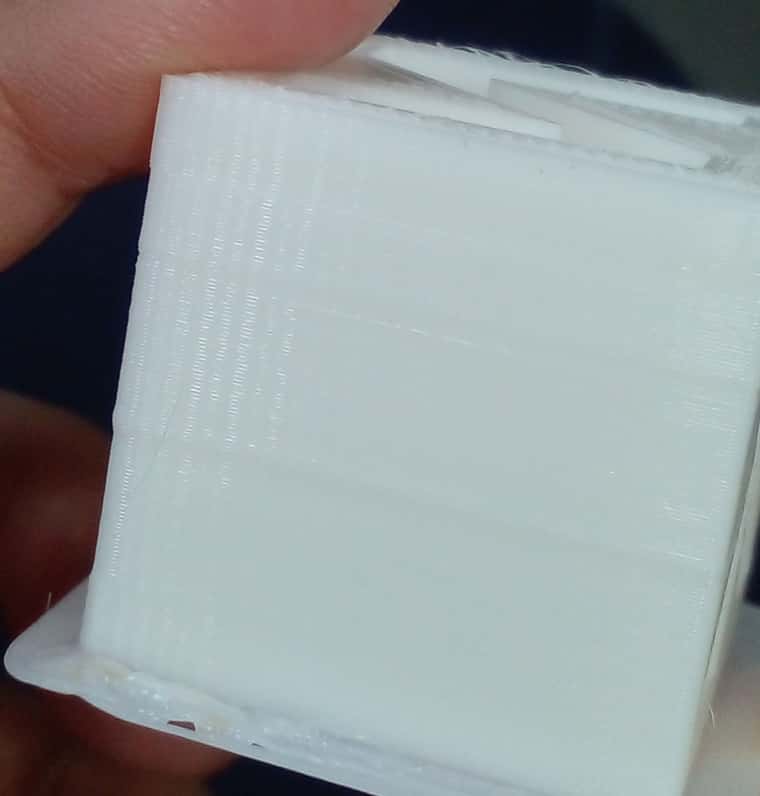

            • Based on suggestion, I tried latest firmware 3.6 RC3.
              NOTE: Tool head is Biqu. (not much heavy, with 3dpinted ducts for part cooling).
            • Attached is an image with the top one printed using DAA & bottom one is how base printing without DAA appears. There is absolutely no difference after input shaping. (I manually calculated distance between 2 lines using vernier (except the corner one) ).
            1. Jerk is 5.
            2. DAA: speed is 120mm/s, acceleration 800mm/s2, and distance is 2mm between 2 lines, so that 60Hz for DAA. We used ZVD mode.
            3. In the top cube, I also modified acceleration to 1500 mm/s2, but no difference.
            Can you suggest here further?

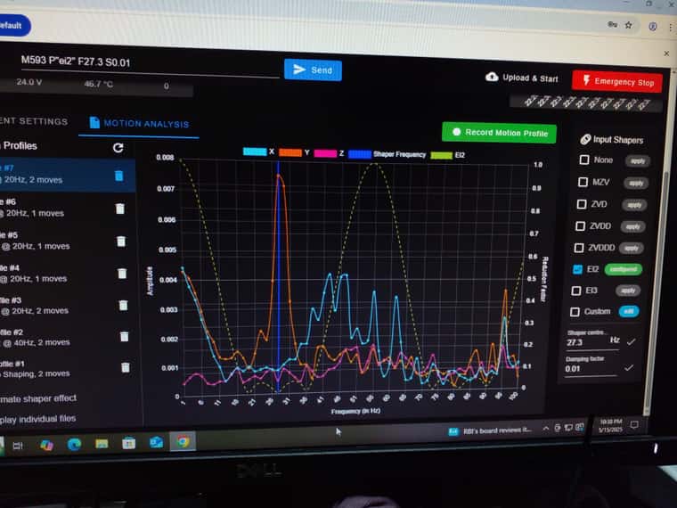

                    Hi Jay, I tried 20Hz, result was better. And I used following accelerometer curve to detect the exact frequency. as per this 27.4 shaper frequency, but that does not remove ringing for me like 20Hz. Can you suggest further on how to proceed here or how to analyze this graph?
                    Also What is the role of damping factor ? At 20Hz with 0.05 i get better result I feel. but I need to find proper frequency & damping factor to make its smooth.
                    Damping factor 0.01
                    EI2
                    Mounted above BLtouch mount.
                    JayTundefined 1 Reply Last reply Reply Quote 0

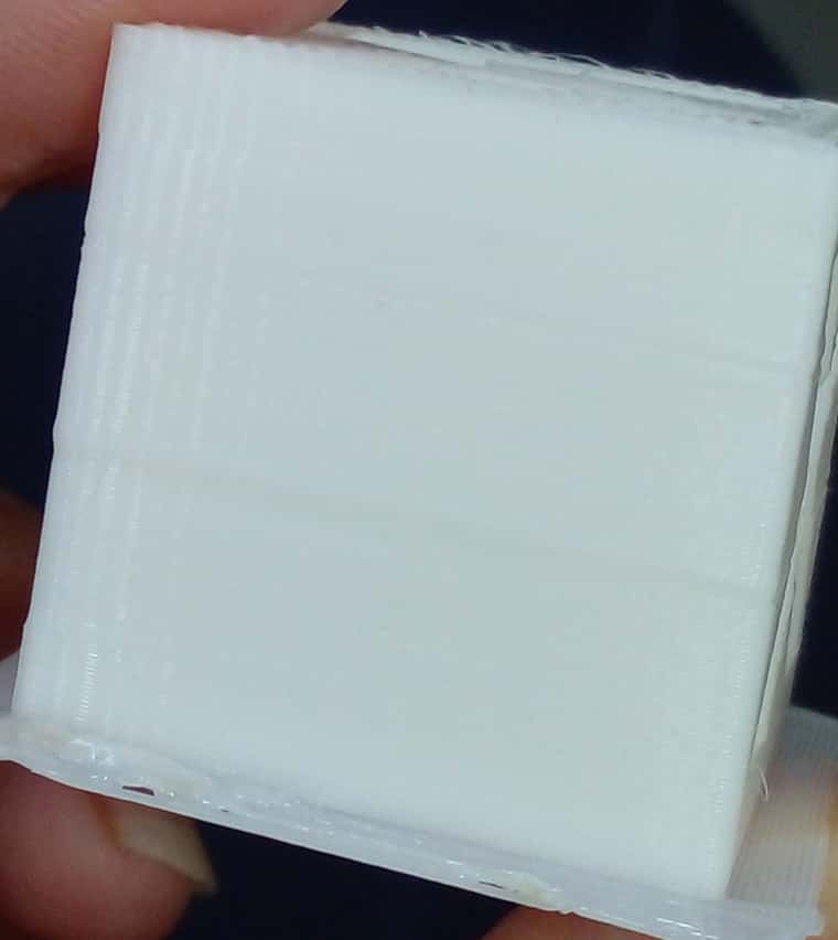

                      @jay_s_uk
                      @dc42 :
                      Below is result at 20-22Hz frequency, where many lines reduce, speed is 60mm/s, so the lines are closer. However, I am not able to remove these lines in the picture.
                      How do I capture this frequency in input shaping method?
                      This is with damping factor 0.05 though, with 0.01 lines are more prominent i felt.
                        dc42 administrators @JayT
                        @JayT as the ringing is so severe, you are unlikely to cancel it completely. You could try other input shapers such as ZVDD and ZVDDD.
