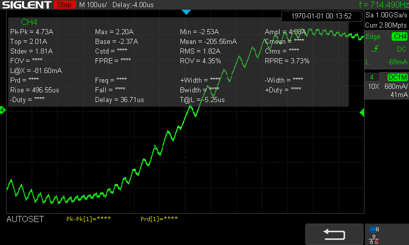

      The top image is 2x ms w/interpolation, 40 steps/mm. The bottom image is 16x I1, 320 steps. There may be subtle differences, but the motor sounds the same for each all the way up to 2400rpm.
      What's the advantage/disadvantage of running either ms'ing?

        @3DPMicro that's the benefit of interpolation: at a steady speed the driver will insert interpolated microsteps quite accurately, making the motor quiet as if you were using high microstepping.
        However, RRF rounds all axis positions to the nearest microstep. So higher microstepping provides higher resolution, up to the point at which the torque provided when commanding a single microstep of movement is too small to overcome the friction in the system.
        In practice, going higher than x16 microstepping rarely gives any improvement in resolution, except that for extruders with very low steps/mm (e.g. 100) it may be beneficial to use x32 or x64.
