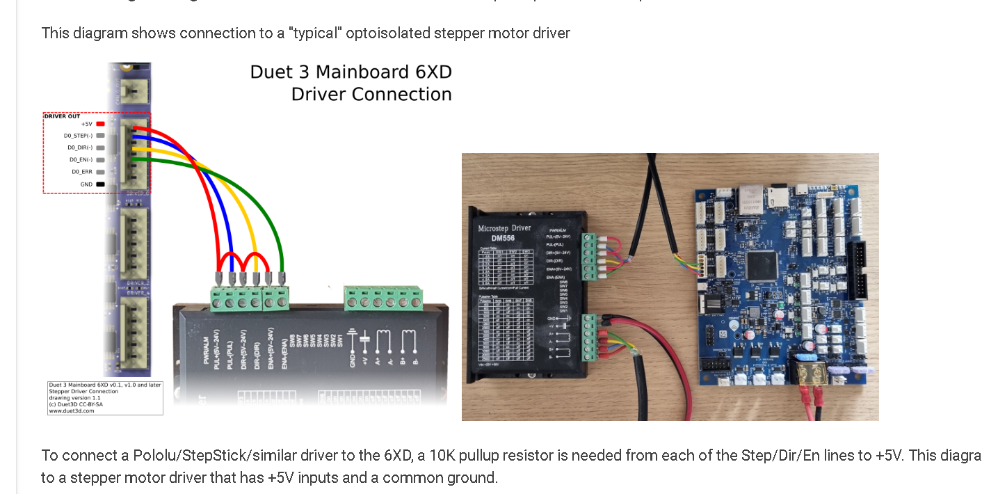

              I am comisoning at the moment machine with this set from stepper online
              https://www.omc-stepperonline.com/ts-series-3-axis-4-0nm-566-56oz-in-nema-24-closed-loop-stepper-kit-w-power-supply-3-clts40-v41
              It is with 6Xd, but should be similar with 1XD
              Conected exactly as described here , just note if you do not wire enable , the motors with enable with power on
              ![alt text](6c357cfd-b35f-418c-8fb5-c5a3bb3a1f84-image.png image URL)
              It is already working
              Here is a video
              0-02-05-5c4cb110ceef4127135b182affe5a9b9c3f0885c22c744779150e5b333aa7d2c_d98a630cc042b674_1.mp4
