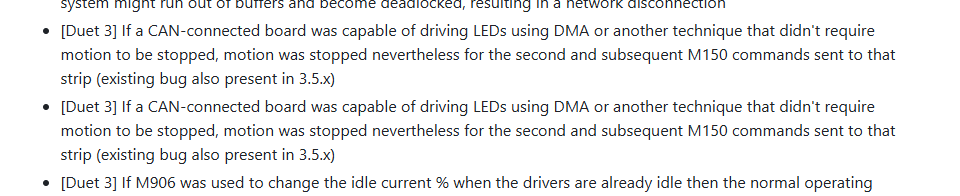

          Awesome news @dc42! We've been waiting with bated breath for this one!
          One quick note, in the changelog for Bug fixes since 3.5.4, there's a double-up on one comment:
          Yes, some of us read ALL of the release notes before blindly installing updates... 😉
          dc42undefined 1 Reply Last reply Reply Quote 2
            dc42 administrators @davidjryan
            @davidjryan thanks, it's nice to know that at least one person reads the release notes! I have removed the duplicate item.
