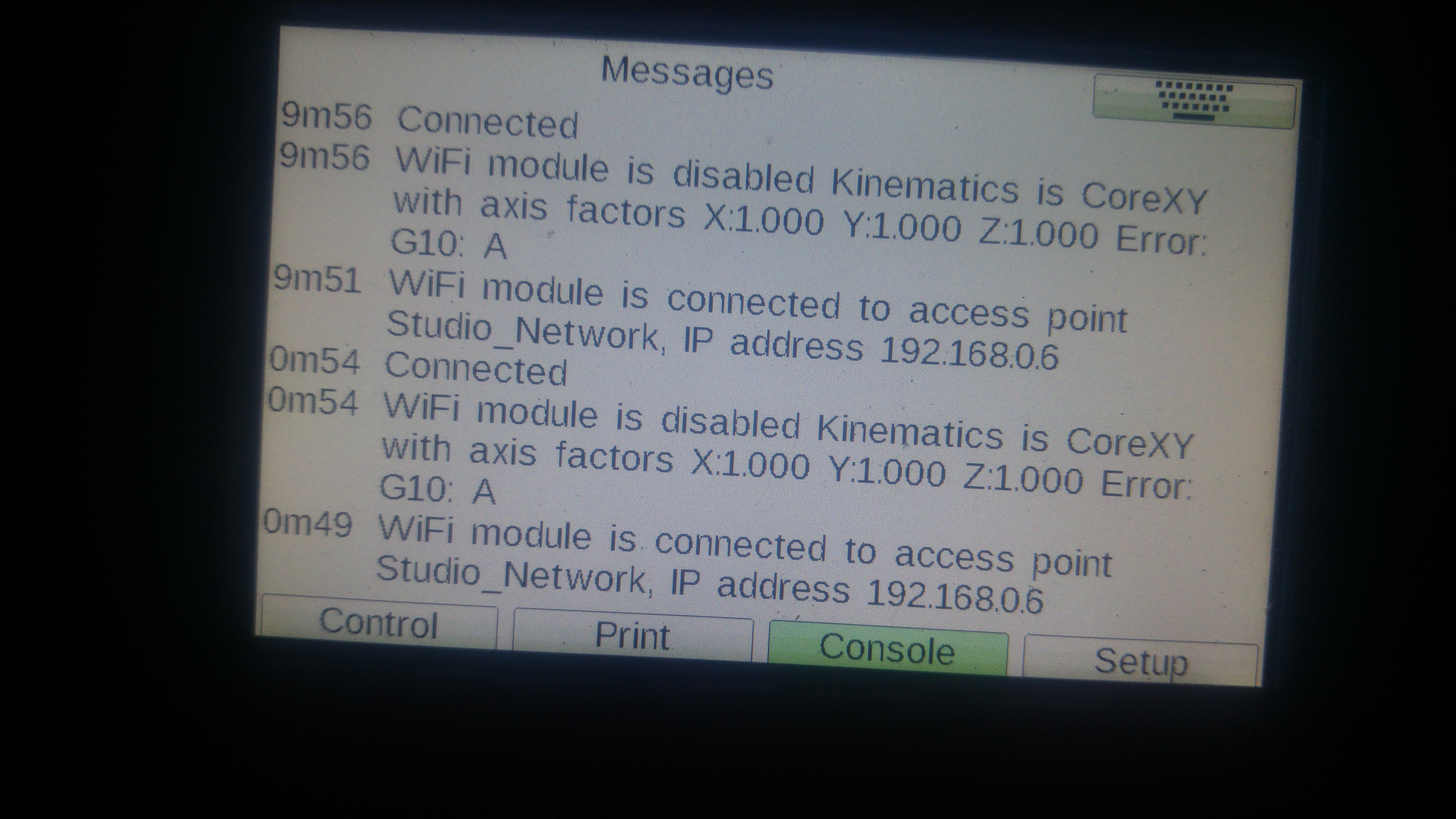

  • I'm getting the following errore when I start my printer:
    "Wifi module is disabled Kinematics is CoreXY with axis factors X:1.000
    Y:1.000 Z:1.000 Error G10 : A"
    before G10 it was G31 this error seems ramdom
    It will discconect then reconnect.
    I have looked through the confgi.g but can not find any thing strange.

    The newline characters in those messages are missing. There are actually 2 messages there:
    • "WiFi is disabled" means that in config.g you have a M552 command without an S parameter to change the WiFi state, so it is reporting the existing state
    • the kinematics message means you have an incomplete M667 or M669 command in config.g

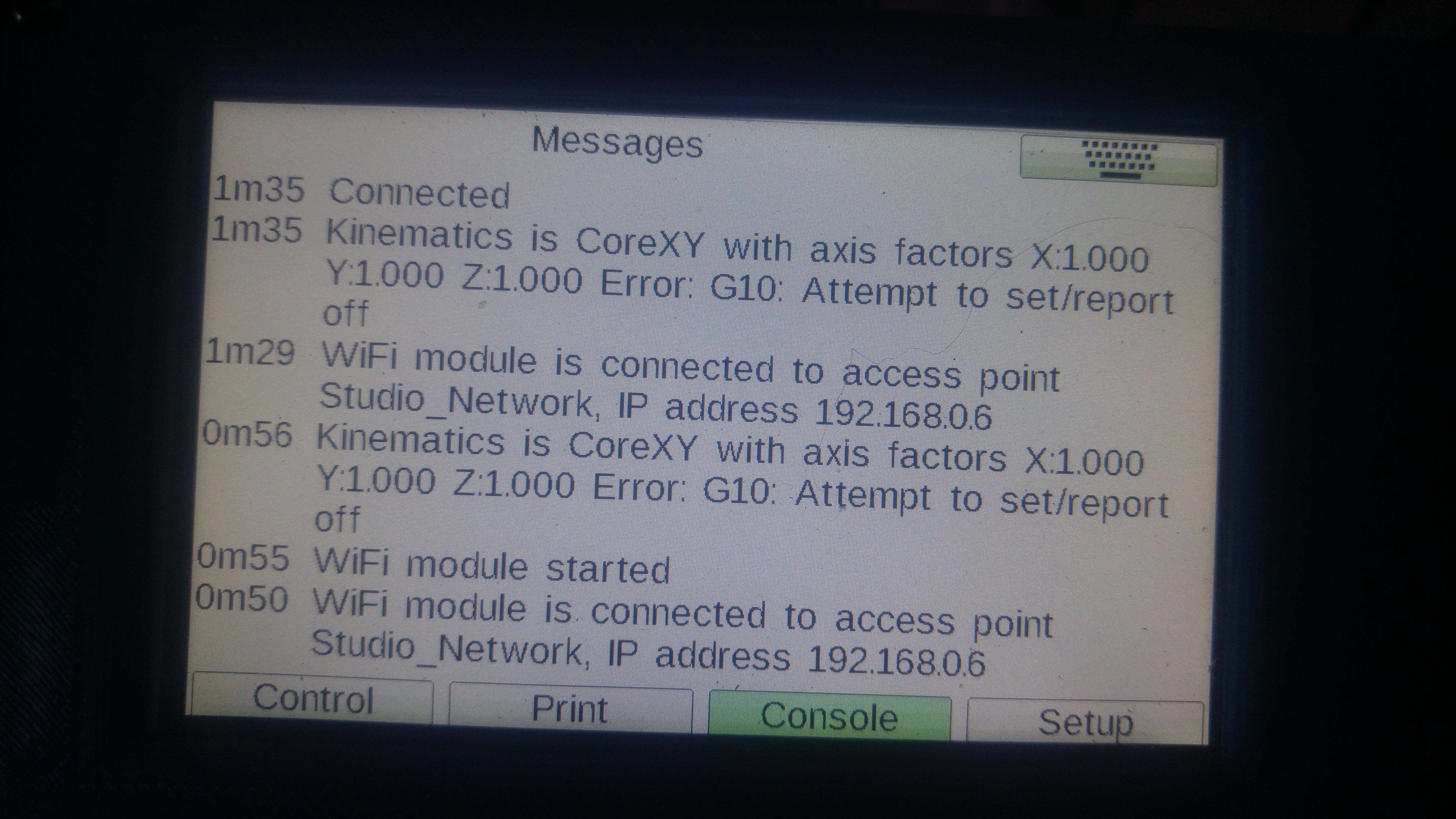

  • M667
    Kinematics is CoreXY with axis factors X:1.000 Y:1.000 Z:1.000

  • Ok if i comment the M667 S1 I do not get that message when it starts.
    So is that a normal message I do not remmeber seeing it before but to be honest never really looked at the console on start up.
  • So do I have to keep this error? To I have to change board as its a hardware problem?
  • administrators
    I think there may be a minor bug that is causing M667 to report the kinematics type when it wasn't intended to. I will check it tomorrow.
