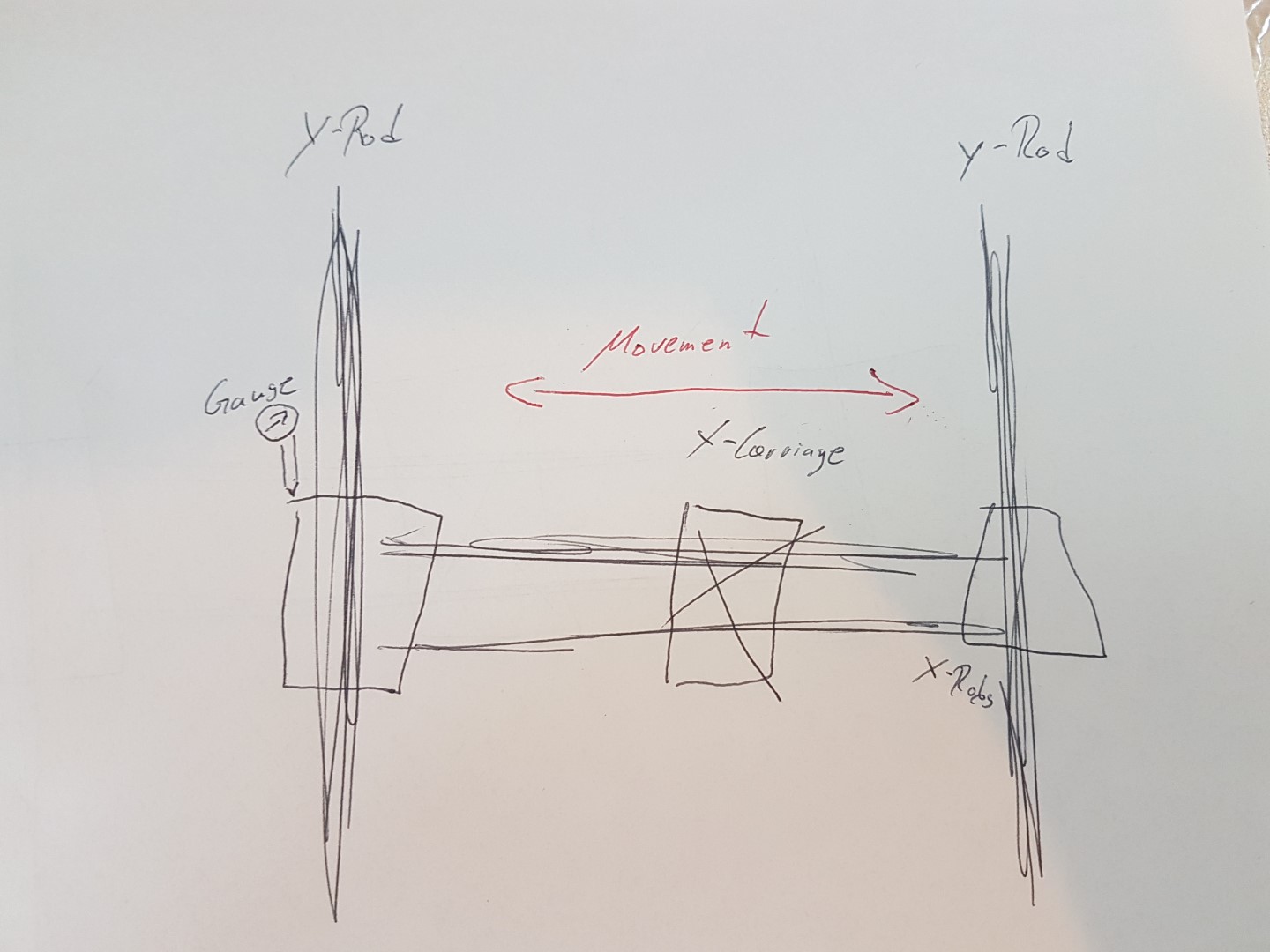

      On my coreXY (Hypercube Evolution) I have strange ringing on x and y. The distance is ~2 mm symmetric on all sides (x, y, 45° (so only 1 motor is rotating) and in vase mode (to eliminate the infill as cause))

      I now mounted a gauge and verified an oscillating vibration always on the axis that isn't supposed to do so (red is always the movement that was performed and the gauge measured the movement on the other axis):
      X-axis movement:
      http://www.visser.at/x-movement.mp4

      I now tested almost anything except of changing the Duet Board. The problem was always the same and didn't change at all.

      • printed in vase mode "cubes" (200 x 5 x 10 mm) and placed them in a distance of 5 cm all over the bed to test if the ringing increases somewhere. (also x, y and 45° rotated so only one motor spins) (It only increased a little bit as the x-axis was right in the middle of the y-rods. But I think this is just because the y-rods are mounted to the frame at the both ends and so the resonance increases in the middle of the rods as this is the biggest distance to the mounting)

              We (Jan, makerdise managing director) also did some analyzes with Denis, however there seems to be no mechanical influence as we already did test the most common/known cases.
              Especially we don't believe that the pulleys do influence the behaviour as they were changed, optimized by hand etc. without any visible changes in the pattern. Denis did measure on multiple points, the rods seems to be stable enough to handle the belt length. In conclusion, the stuttering can be caused by soft- or hardware issues related to the activation of the related drivers.
