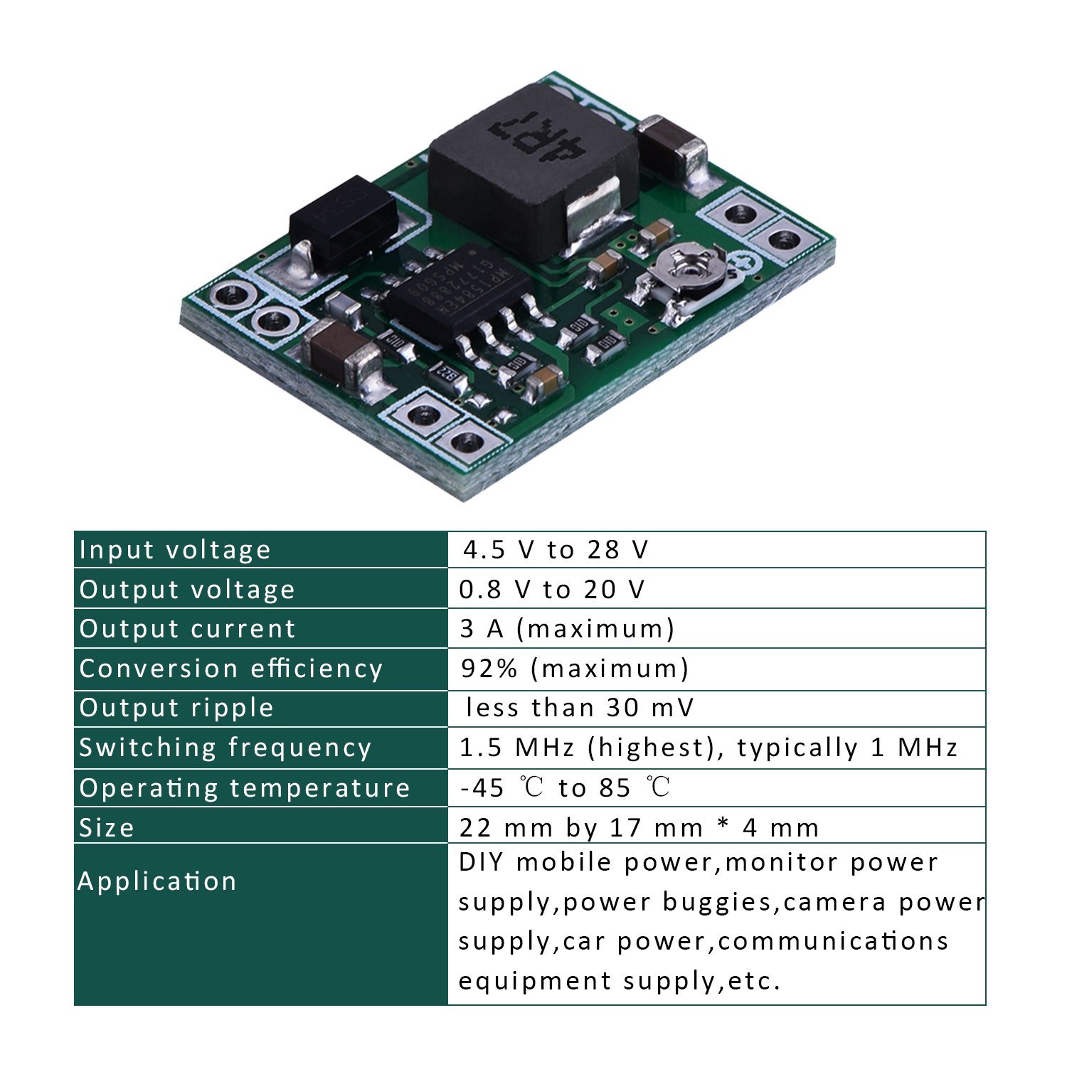

              • Hergonoway
                Hergonoway @Jacotheron last edited by Hergonoway
                @jacotheron & @t3p3tony thanks for your replies, I'll keep up with a DCDC step down at the Duet side then, I've got a bunch of these littles guys :
                Delta goes BrrrRRRRrrrrrRRRRrrr
