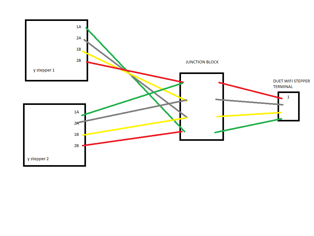

      Hi Everyone.
      I've been trying to get my printer running with Duet hardware for a while now and I need some help getting over the finish line.
      My printer is a cartesian style.
      I'm using DuetWif 2.0 board, PT100 temp sensor and paneldue.
      Fans work, endstops work, bed and extruder heaters work, temp sensors work. I have a BLTouch, but it is not wired up yet, so no bed level sensor in the mix at this point.
      Here are my issues.
      • On the paneldue in the upper left hand corner, it says "connecting" it always says this. Does that matter or is something not working right? I can control the board over the web interface, but when I try to send commands to the printer from the Paneldue, it doesnt do anything. Also, no temps are registering on it.
      • X stepper is stuttery. When I send a command for it to move, it just kind of vibrates and the shaft sorta goes back and forth real quickly, but it doesnt turn. I've tried playing with the acceleration speeds and the stepper voltages. Neither of those have helped.
      • Y steppers are stuttery. Same as what the X stepper is doing. However, there is another problem. I frequently get "Error: Short-to-ground on drivers 1" message on the web console. I've checked and double checked the wiring to these steppers and I cant find a problem. I've tried different steppers, tried only plugging 1 in and I cant find the problem. Sometimes I can get a few "stutters" out of the stepper before I get the error and sometimes it starts giving me that error message as soon as I try to get the Y steppers to move. I cant figure out how to fix this.
      • Z stepper is also stuttery. And...the Z stepper always move the bed away from the hot end, no matter which direction I tell it to go. I'm not sure what to do to fix this.
      Here is my config file. If some of the values look weird, it could be because I was changing them to try and trouble shoot.

        Have you seen this? https://duet3d.dozuki.com/
        Particularly this? https://duet3d.dozuki.com/Wiki/ConfiguringRepRapFirmwareCartesianPrinter
        It sounds like you have some wiring issues.
        How do you have the Paneldue connected?
        The motor behaviour you describe definitely sounds like either a bad crimp connection or wire pairs not correct.
        Are you sure that your Z steps per mm is 4000?
        Does your Z axis home to Z max or Z Min?
        Can you post your homing files as well?
        If you're currently not using a Z probe you should comment out the Z-Probe lines in the config for now by adding a semi-colon ( ; ) in front of them. M558, G31, M557

              Also, not sure if it matters or not, but I am running a 24v PSU on the board and steppers.
                Phaedrux Moderator @cyoung
                @cyoung said in I need some help!:
                I was hoping not to have to get that far down in the weeds.
                Far from it. Following the setup guide will save you a great deal of trouble.
                For the stepper wiring I just followed the color coding of the stepper wires and the wiring diagram of Duet. But you can manually verify the pairs by checking for continuity with a multimeter.
                You can also use the continuity testing function to verify if your crimps are good.
                For the paneldue cable make sure it's connected the right way round. https://duet3d.dozuki.com/Wiki/Connecting_an_LCD_control_panel#Section_Option_2_4_way_cable
                  Your Z home file is setup to work as though you have a Z Probe.
                  Comment out the G30 probe bed command and replace it with
                  G91 ; relative movement
                  G1 S1 Z-400 F600 ; Move Z axis to endstop
                  Again, all of these details are in the cartesian printer setup guide.
                  cyoungundefined 1 Reply Last reply Reply Quote 0

                        No worries, I don't mind helping to solve problems, but a lot of the basic setup is covered in the documentation far better than I can describe.
                        After you've made the motors stutter, run an M122 command in the console and paste the contents here.

                          1. Panel Due running but not connecting. The usual causes are:
                          • bad connection in the Din or Dout wire of the 4-pin cable
                          • Din and Dout wires swapped
                          • mismatched baud rates. Both default to 57600 but both can be changed.
                          1. Stepper motors not moving. Usual causes:
                          • Bad crimp connection between the cable and the connector.
                          • unsuitable current setting. Please provide a link to the datasheet for your stepper motors.
                          • trying to move the motor too fast or accelerate it too fast. Use low M201 and M203 parameters until your printer is working.
                          • Wires not paired correctly into phases. In this case the motor will vibrate loudly.
                          • blown driver.

                            • cyoungundefined
                              cyoung @dc42
                              @dc42 said in I need some help!:
                              I dont have a data sheet handy. The steppers came with a folgertech printer kit. I've looked at their website but cant find any technical info on the steppers. There is a no part number on the motor. I could try to email them and get a data sheet.
                                My understanding is that Folgertech used 12V 0.4A motors on their early kits. That was a terrible choice and if you have those motors, your best bet is to replace them. You could try reducing the motor current to 400mA in case that improves things.
                                In later kits, I understand they supplied more suitable motors for 3D printer use.
                                • cyoungundefined
                                  cyoung
                                  I have 2 steppers motors for the y axis, they are wired to each other and plugged into the y driver on the board.
                                  I'm not sure this wire is assembled correctly. On y stepper 1, paired wires 1a and 1b dont connect to 1a and 1b on y stepper 2.
                                  This is what the wiring looks like for the y steppers.
                                  Before I added the duet hardware, I was running an MKS board with Marlin on it and the printer worked correctly. All of the wiring and other components that arent Duet are reused from the MKS setup. I had to swap some pins on the e-stop connectors but everything else (wiring wise) is unchanged.

                                            So worked on the printer some more yesterday. I took one of the legs off the 2 stepper motor wiring harnesss for the y axis. Used this harness (with a junction block in the middle) and the motor works correctly! I can plug any stepper into any axis on the board and, as long as i use this specific wiring harness, the stepper works as expected. I tried a few other things and I am now under the impression that I need to rewire the steppers. We tested the "bad wires" every way we could with a multi-meter. Conductivty, resistance, cross-talk/shorts....we couldnt find anything wrong with the bad wires. Not sure what that means but Im thinking Ill try rewiring and see how that turns out.
                                            Even the Y axis works in this setup so I'm hopeful that I dont have a blown driver.
