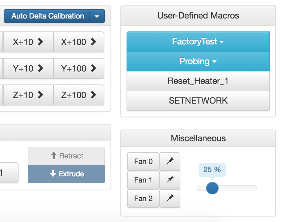

Another issue - which I don't know if related to the above - is that FAN2's name as defined in the M106 command (i.e. 'Duet_Fan'), doesn't show in the 'misc' section of DWG:
I deleted all the browsing history, cookies, etc., and reloaded DWG, but the name still doesn't appear.
I've attached the complete config.g and config-overdrive.g files below.
Help please?
@snowcrash Let's start at the end: naming fans is currently only possible in @chrishamm's fork of RRF. In the regular version this will only be available from version 2.02 (note that 2.01 is next to come).
About the fans not spinning: I just tested the same command (except the
I1
part) on my machine and can confirm that it is not working this way - but if you lower the start value of the temperature to -1°C, i.e.T-1:100
it will work.
I thought I had a theory why that is but in the middle of writing it here I realized it doesn't make sense. So: no clue why it has to be like that but it works.And the last part: never be sorry to doubt me! I mean it. I'd rather have you doubt me all the time than expecting I know everything. When I got the email notification of your post I was also thinking about the possibility that in this case out of some reason the heater channel would have been required instead of the virtual heater, so I also doubted myself here.
The name (like many other string parameters in RRF) probably needs to be enclosed in double quotes.
@SnowCrash
@wilriker said in Help Configuring PWM Fan in Thermostatic Mode for Duet Drivers:@snowcrash Let's start at the end: naming fans is currently only possible in @chrishamm's fork of RRF. In the regular version this will only be available from version 2.02 (note that 2.01 is next to come).
This is true, however, @chrishamm released a version of the firmware with the fan name change included. You can find it here. And I can confirm as @dc42 says that you will need to enclose the name in double quotes. Ex: C"Duet_Fan". Once that's done it works as advertised.
@phaedrux said in Help Configuring PWM Fan in Thermostatic Mode for Duet Drivers:
@SnowCrash
And I can confirm as @dc42 says that you will need to enclose the name in double quotes. Ex: C"Duet_Fan". Once that's done it works as advertised.I just updated the wiki accordingly to reflect this as well.
P.S.: I have not tried it but when enclosed in double-quotes I at least guess this can then also contain whitespace.

p.s. this has been nagging at me for a while now so have to ask: what do the little pin buttons next to each fan name in DWC actually do?
@snowcrash The pins let you lock the fan speed. Useful for gcode controlled fans if you set the speed too high or too low in the slicer.
