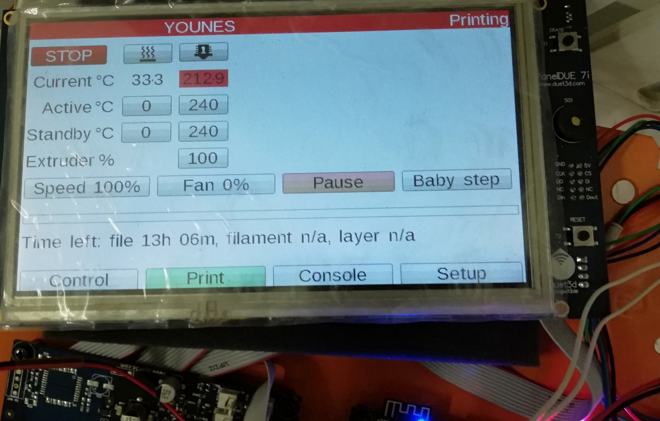

T0 ; Select first toolwhen i try to print everything looks ok
x y and z home but after that driver 3 which i dedicated to Z2 moving up and other 3 x z not moving and print not starting
i have warning message that driver 3 is hotwhat is the solution please??? I am trying to print for more than 3 weeks and no result so far
is there any special configuration i have to do in the slicer software this is the file i am trying to print this fileG90
