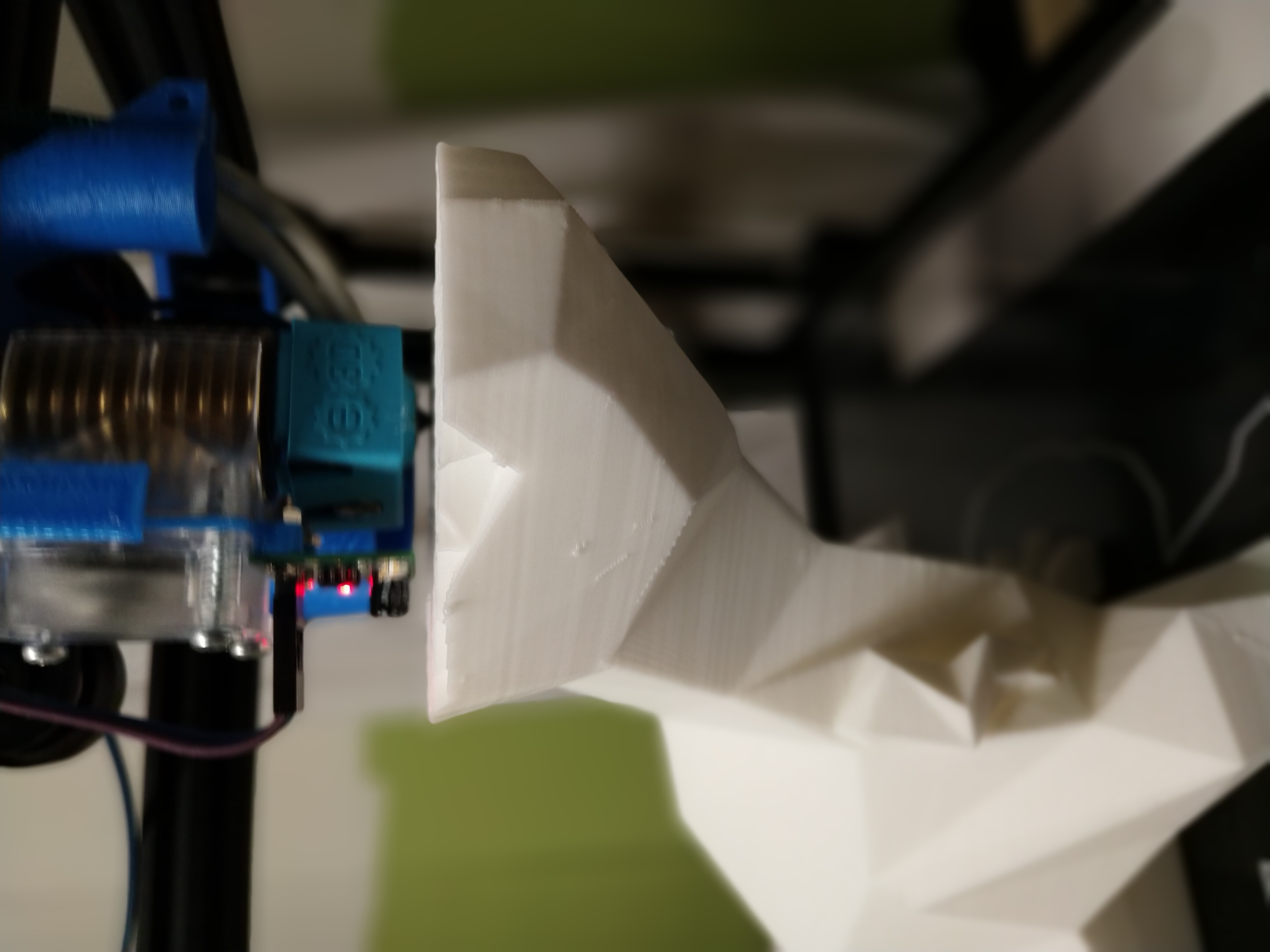

I think I have Bowden problems
I am getting zits and blobs not in my prints. If I work to get rid if them, then plastic isn't at the ready for the areas of the print that may change layers often. The blobs occur at every layer change as the extruder takes long pauses before starting the next layer. These blobs, when they show up on the surface if the prints look like zits. Here is an example. Print starts out perfect, but does have blobs/zite and hits a lot of layer chages and then retractions either can't or just not able to refill the hot end quick enough. i think I am just screwing up the many different settings and even if I am on the right track to fix, just creating a bad combination to mislead me on a bad troubleshooting path.

Have you tried any other slicers? I find it handy to be familiar with Cura and slic3r PE to help identify issues. If it happens in one slicer but not the other with similar settings it might give you a clue where to look.
There's also the option of using firmware retraction which may behave in a more simple and straightforward manor compared to simplify 3d.
My experience, based almost entirely on printing PLA:
- Zits that occur just before travel moves indicate insufficient retraction.
- Stringing indicates that the print temperature is too high.
- I retract as fast as my extruder can. Typically the retraction speed is acceleration-limited. For a Titan I use M201 E1000 and M203 E3600. I specify 60mm/sec retraction in the slicer.
- Bowden systems need a retraction distance of around
8%0.8% of the Bowden tube length plus 1mm. A little less using Capricorn tubing; a little more if you don't have clips under the collets. Tune the retraction by increasing it until the zits disappear. - On a delta I use a little Z lift during retraction, on other printers I don't because it is slow and wears the Z leadscrew.
- I don't use wipe while retraction, or coast to end.
- Pressure advance helps, but tune retraction first. When using large amounts of pressure advance you must reduce retraction distance.
HTH David

I have to measure out my Capricorn to get that .8 +1mm number, but I changed the rest of the settings to match yours. And yes it's much improved. Still have issues, but they are not the same blobs I was getting. They are more so shapped then a blob and now also some scarring.
If I tighten down my titan extruder it eats away and or flattens out the filament making it unable to go through the Capricorn tube. Usually it stops right after it pushes out a few mm of plastic out the nozzle. If I losen it, it stops shortly after the filament hits the nozzle and chews up whats in the titan. If its in the middle, it seems to click randomly (takes bites out if the filament each time) and over time causes the filament to cause too much drag again in the tube.
What do I do when it's clicking? Tighten the screw in the Titan, or losen it more? I didn't have this problem when I used the standard white bowden tube but had a lot of thick thin extrusion layers in prints and had to print faster to keep the pressure up to reduce the effect...

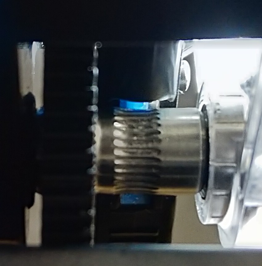

A free opinion and worth every penny:
I am not a big fan of Titan extruders. I've slowly gotten rid of all my Titans in favor of Bondtech BMG.
I do agree that E3D has fantastic service. That makes it doubly weird that they ignore the fundamental design flaw in the Titan (misalignment). It has been posted to their forums many times, and they always suggest the same fix (that doesn't actually fix it) and refuse to consider changing the design.
See how the filament is not "in the valley" of the hob? Despite the metal piece being forced to the left of the plastic gear to the point you can see splines sticking out? That "move the metal in relation to the gear" is the suggested fix that doesn't really work. The misalignment was much worse prior to the suggested fix... but it is still not right.
Also, if the filament DOES "move into the sweet spot", the diameter of the drive effectively changes, and extruder calibration goes out the window... unless it stays there while you calibrate... which it doesn't.
Anyway, enough of that... Try a Bondtech BMG.
P.S. The BMG handles flex filaments just fine (the Titan doesn't claim to handle flex, and definitely doesn't in actual use). So even if you don't care about any of the stuff in my rant above...
