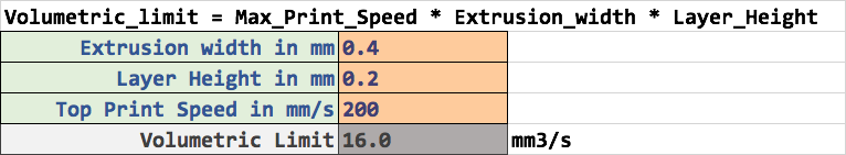

          An E3D V6 has a melt rate of around 15mm^3/s. Maybe higher if you increase the temperature to the limit of your material.

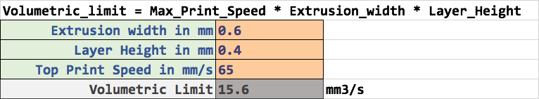

          A little simplistic, but it's ball park. And it's doable. I have printed PLA at 210c solid infill at 200mm/s with a 0.4 nozzle and 0.2 layer height on my CoreXY. I use lower acceleration (900mm/min) and more modest jerk (900mm/min) so that on short segments it never hits the top speed, but on longer sections it does hit the top speed. I usually do infill every other layer or some multiple of the perimeter layer height so it's thicker at 0.4mm or more, so half as fast, but it's printing it on fewer layers for an overall speed gain.
          So if moving faster isn't really going to shave off print time, you can also adjust the other variables in the equation. Wider nozzles move more plastic and allow for larger layer heights. A 0.6 nozzle and a V6 block are probably the sweet spot for layer height flexibility, extrusion width, and melt rate. Anything wider and you'd want a volcano block. I've seen from 30-40mm^3/s mentioned for the volcano. Which gives you a lot more headroom for speed, but it also comes with its own drawbacks. Increased ooze and stringing, bulges at corners, loss of XY resolution when using wide nozzles.
