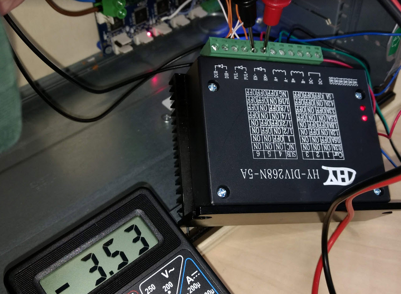

I'm trying to drive an External stepper driver using the breakout board on a new Duet Ethernet. I assuming the signals from the board will be boost up from 3.3 to 5v but I'm afraid I misunderstood. When I measure with a multimeter there's 3.3v DC on the dir+ and dir- and en+ and en- when idle. When I try to move the y-axes there appears hardly no voltage on the pul+ and pul- signal. I want to drive a Nema 23 but for testing purposes I hooked up an Nema17. No movement at all. My external driver is a TB6600 see picture below and hier a piece of my config:

@leonknook do you have a link to the datasheet for that external driver. most allow you to switch the -ve line of the pair and connect the +'ve line to 5V+ on the expansion board.
@leonknook said in Breakout board produces no 5v signals:
M569 P1 R1 T3
Did you mean to use P5 instead of P1 in that command? I think that is the real problem. Most external drivers work with the voltage levels provided by the expansion breakout board, but few if any work with the fast step pulse timing that the Duet uses by default.
M569 P5 R1 T2 ;does not work
The breakout board handles the inversion of the enable signal, so you need R0 in that command, not R1. If it still doesn't work, try T4 instead of T2.

Which is the "second LED" you refer to?
After you send the command to move Y, do you get +3.3V or greater on ENA+ relative to ENA- ? It should be the other way round after you reset the Duet and before you send the first command to move Y.
After a reset off everything I measure this -3.53v
After pushing the y move button the voltage change to plus +3.53vThe led down under is bright all the time
The led above is pulsing when pushing the move button.Same measurement on the breakout board self without stepper driver connected.
My problem is still not solved. If there are no options left over please let me know.
I will trow this well developed board out of the window and never look at it again. -
The LEDs suggest that your driver module is receiving the signals from the Duet. Are you certain that you have connected the stepper motor correctly, and set an appropriate microstepping and motor current on the switches? Does the motor spindle lock when the ENA voltage changes from negative to positive?
You can increase the drive voltage to 5V by connecting +ENA, +PUL and +DIR to +5V (which is available on the servo connector of the breakout board) instead of to the individual + outputs; but I really don't think that drive voltage is the problem.
The TB6600 stepper driver seems to be not a suitable driver for the duet.
This week arrived the DM556 drivers and they work without any problems.Thanks for all the help!
Kind regards,
Leon. -
To complete this thread for others. I had to use the 5v connection from the breakout board to make the DM556 to work properly. For some reason the 3.3v voltage from the +signals ENA PUL and DIR does not do the job for this driver.
