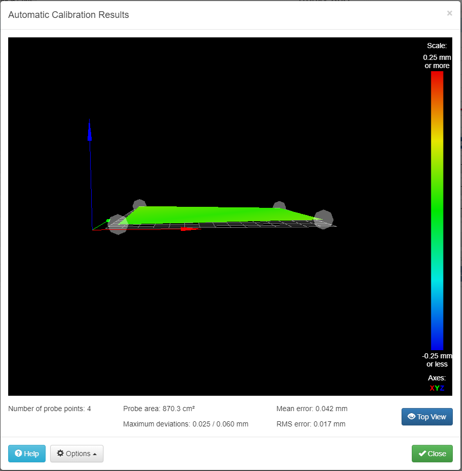

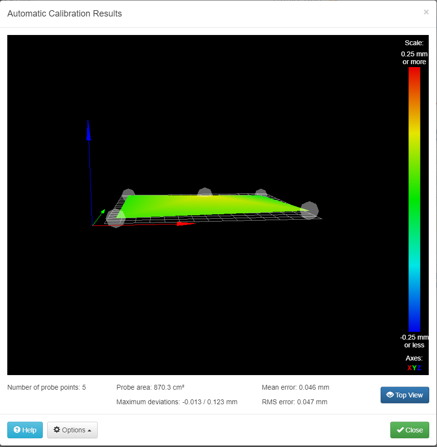

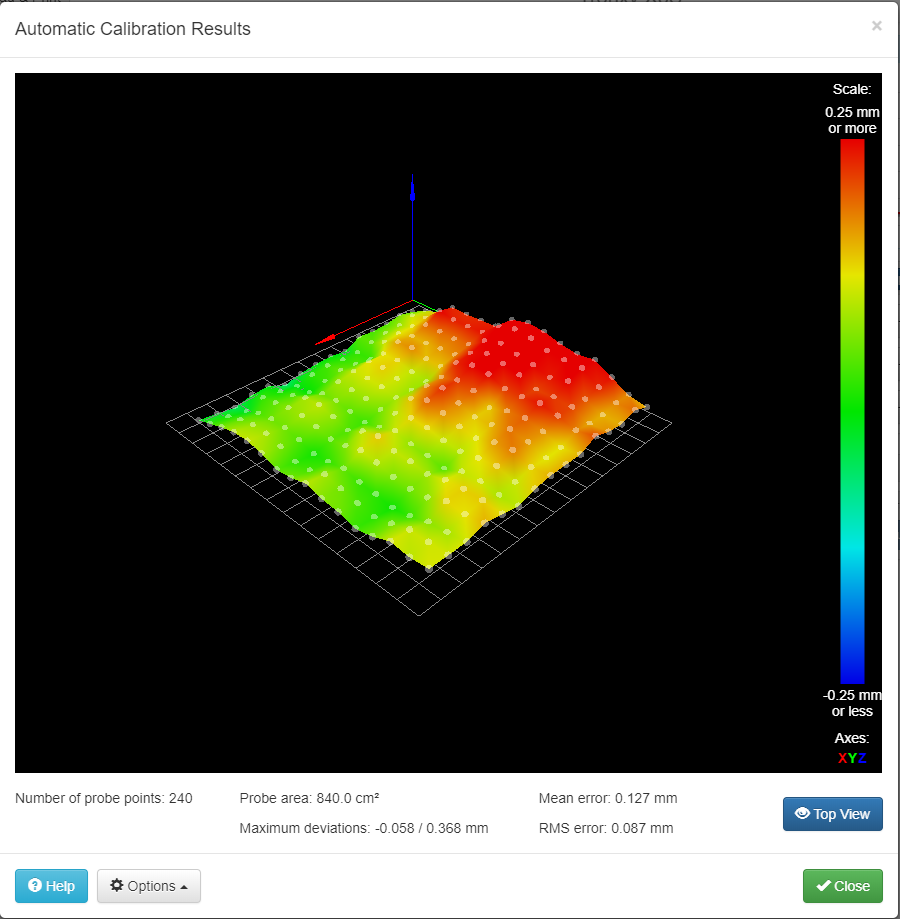

Hello all! So I've got the printer up and running and got my SN04-N sensor hooked up and working. I am looking for opinions on the results of the automatic bed compensation and the mesh grid compensation. Should I be concerned and if so what can I do the resolve the issue which should be apparent from the images.
Thanks in advance!
4 point calibration:
5 point calibration:
240 point mesh calibration:
Is this a Cartesian style printer? It looks like you may have some sag on the x axis rods.
If you do a test print with that 240 point mesh does the compensation effectively counter act the bow and print a good first layer?
Thanks for the reply, I should have mentioned it's a CoreXY (Tronxy X5S). I am running a Benchy test print right now, I had adhesion issues but the layers looked correct and the Z axis was moving while printing the layer. I'll know in a while, I used Simplify3D with high settings so it's taking a bit. It's also printing support material because I forgot to deselect that option.
Regardless, it looks like sag on the X axis. That's what mesh compensation is for, taking an imperfect mechanical situation and compensating for it.
Well this is a bit better:
4 point:
5 point:
240 point mesh:

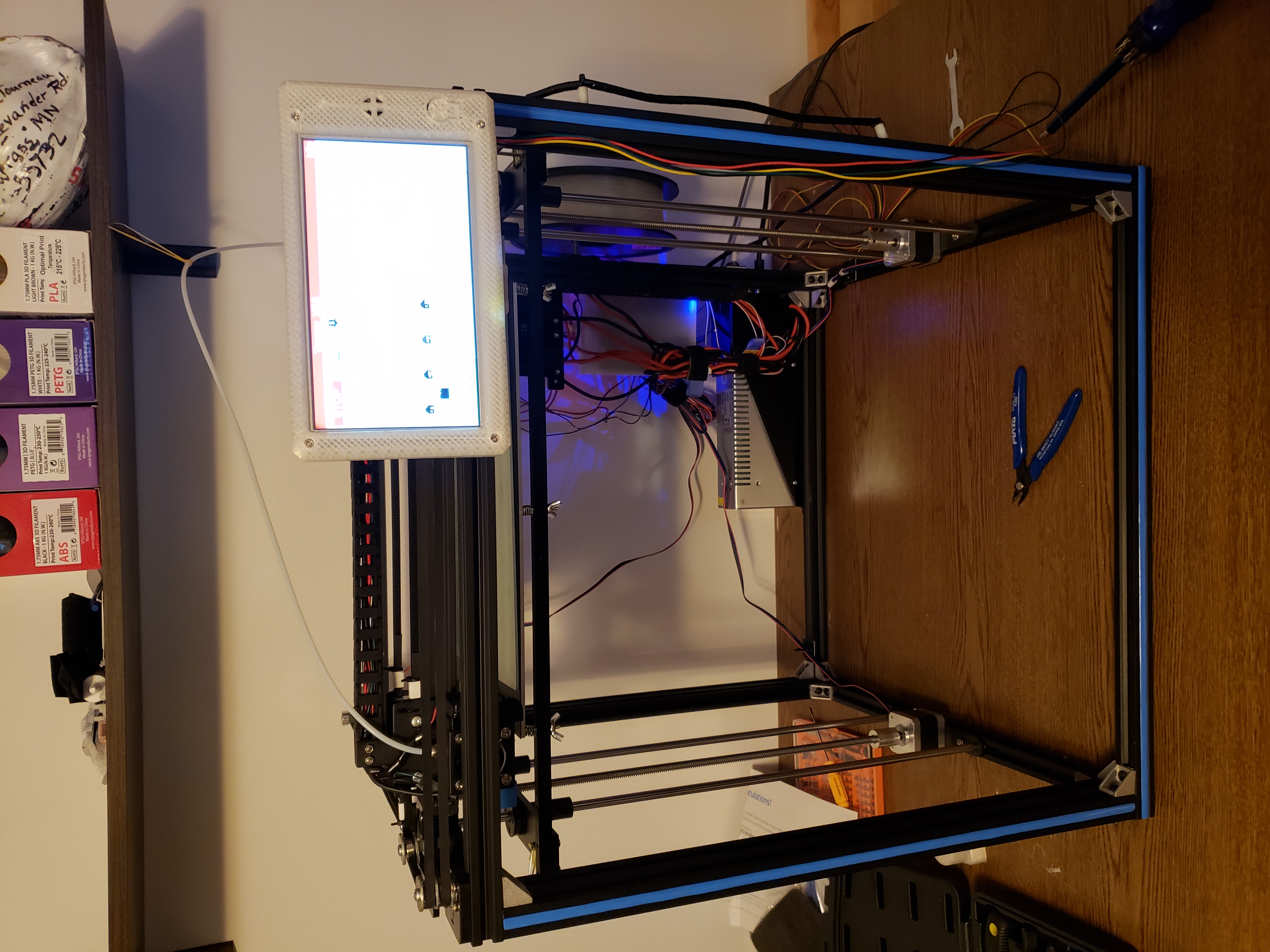

The printer (still needs some cleanup):
I received some advice from a Tronxy reseller in a Tronxy Facebook group. The screws that hold the linear rods in the top of the frame were overtightened. I loosened them and the bed became much more level.
What is the bed made of and how is it mounted? I seem to recall seeing some other posts about the Tronxy bed being mounted with many bolts which make it difficult to get level. Ideally, you'd only have 3 screws.

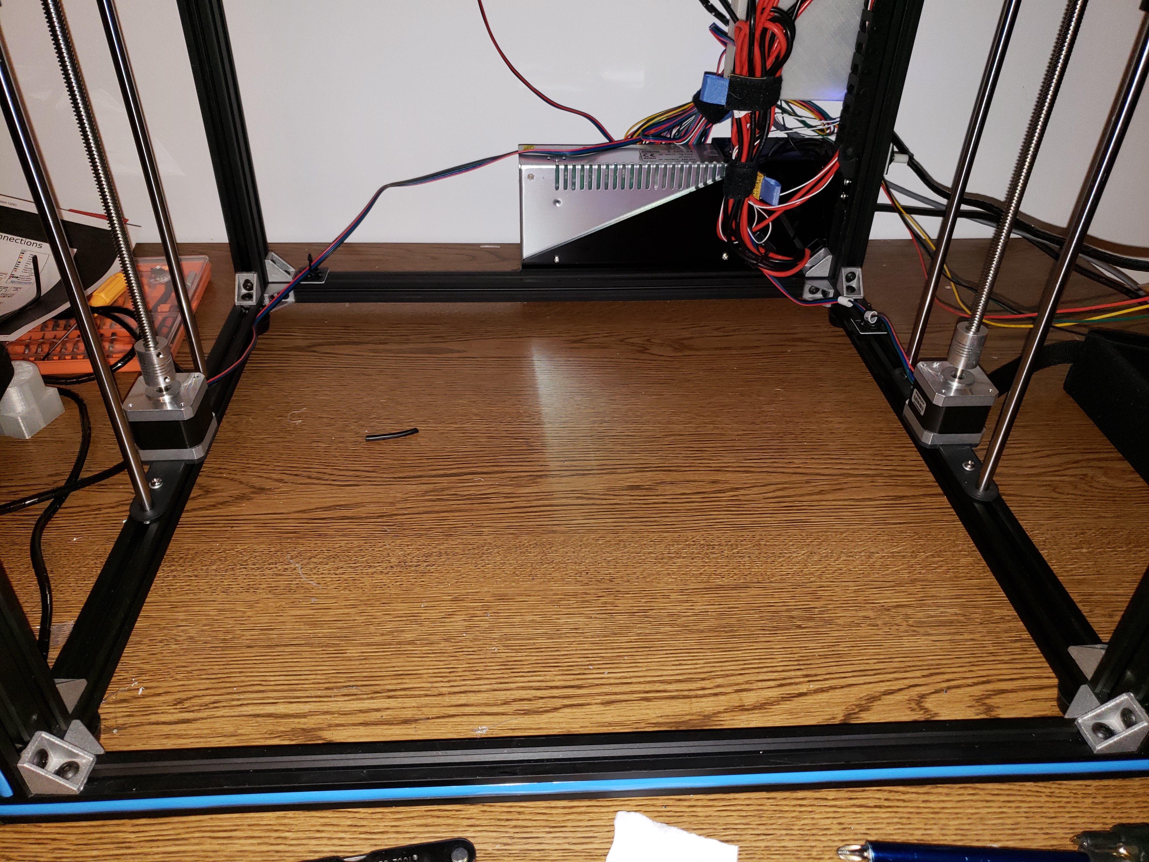

The bed is a MK3a heated aluminum type with a 0.5mm build mat a adhered to it. Here are some pictures of how it's mounted, a picture being worth a thousand words.
Yes that bed will be a challenge to level. It's not very thick or stiff, and it has 6 screws trying to tame it.
From your detailed probe it would seem that the front middle screw needs to be tightened a bit.

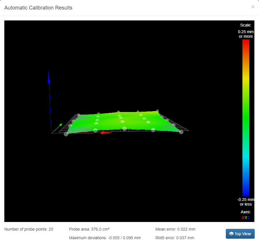

Thanks, I've been using automatic bed compensation to dial it in as it is faster and then running the 240 point mesh when I got it close. I still want the 240 point mesh compensation but for dialing it in it would be helpful if I could add the center of each run as well, so nine points around the perimeter and the center.
I've changed to a BLTouch sensor (and an E3D V6 clone but that probably doesn't impact this
), the difference in the results are interesting. I think I'll pick up a piece of borosilicate glass and see what kind of results I get.

With such a constrained bed with 6 leveling screws it will be difficult to prevent some warping. Have you tried removing 3 of the screws to allow for a 3 point leveling system?
