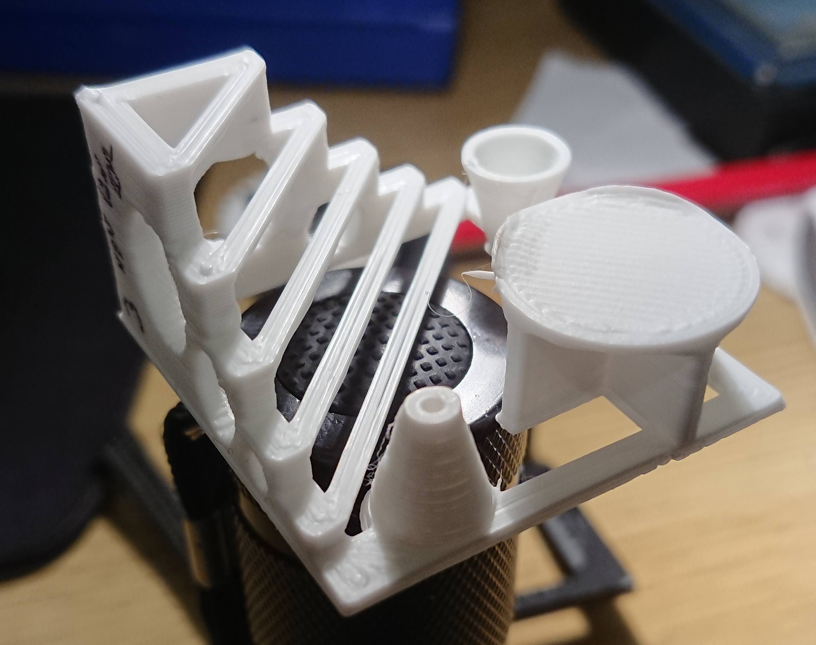

      White 3DFilaprint 1.75mm PLA @195/190C, bed 50, Duet v0.6, Ormerod with standard reprap hotend (pre-quickset), 0.3mm layer, 0.5mm nozzle, 0.5mm extrusion width, 50mm/sec speed. Recent if not current firmware. Non-linear extrusion tuned and verified with averaged 100mm extrusion lengths into free space. 50mm radial part cooling fan running at 100% after layer 3.
      Symptoms started off looking like overmelting. A part consisted of a case for a 12mm smooth rod with a ~5x5mm pillar on top. The y-axis bearing case with the tag that hits the limit switch for those who know the Ormerod. The small pillar was deformed and appeared overheated. I have tried:
      • Using a sacrificial part to increase the layer time,
      • Dropping temp to 170.
      • Disabling retracts that don't cross perimeter.
      • Disabling pressure advance (was set to 0.1).
      • Reducing retracts from 4 to 2mm.
      I'm just about to test a few ideas on another build but thought I may as well raise questions to the hive mind in parrallel!
      I've got a non-linear extrusion correction in place but I have thought that calibrating against 100mm fixed lengths (allows hot end to stabalise during exttusion) may have little relivance to a build with a mix of long (30mm) and short (1-3mm) infill print vectors.
      Is this a recognised symptom of trying to push volumetric extrusion rates too high?

          I don't think you can build a 5x5mm PLA pillar without massive layer cooling.
          Doing a sacrificial tower just removes the layer cooling from the just deposited melted PLA.
          Print slow (5-10mm/sec) and make yourself a present in form of a Berd-Air like thing. I've got a pump (Aliexpress, search for "555 pump"), some hose and a 4mm thin wall tube. Squish the tube at the end and make sure that the stream is hitting the top of the nozzle (and below, it is fine).
          Also add a sock on the heater block.
          This way you have much less radiated heat from the heater block and massive pointed layer cooling. Filament will almost freeze right after the extrusion.
          I can easily make thin features now, even in PLA.
          To understand how important is the layer cooling, especially for PLA and small features, picture that in my setup air comes from the right. You can easily see the difference between directly cooled part (right side) and indirectly cooled one (left side). Both are fine, but right one is "finer" 🙂
          PS. Do not bother with the "official" method of doing a holed ring around the extruder. The tube is so hot that the "cooling" air is hot too. My 12V printer with 24V pump has more cooling power than my "official" implementation with holed ring that runs 24V pump on 24V. And it is also more silent, of course.

              Post some pics, but I bet there is also some over-extrusion going, which adds to the pressure build-up (btw, did you try pressure advance?).
              Some time ago, I've attended a machining exhibition and noticed something at Stratasys stand: in all their demo prints you can clearly see the infill lines in top/bottom. They are not squashed trying to generate a smooth top layer. Then is when I've realised that I was overextruding all the time, trying to get rid of that small spacing between the tops of the oval beads of the infill.
              Since then, I've adjusted my extrusion factor to always see the top spacing, but they still touch in the middle and the quality of my prints improved a lot.
              Phaedruxundefined DocTruckerundefined 2 Replies Last reply Reply Quote 1

                              • DocTruckerundefined
                                DocTrucker
                                Here's a picture of a recent test. Much improved. Dropping 0.025 on the extrusion multiplier leaves gaps on the large circular flat (away from the curl) but the flats near the bridges are still over stuffed.
                                Edit: Part is approximately 40 x 40 x 20mm. Extrusion width is 0.5mm. Layer thickness is 0.3mm. Nozzle is still 0.5mm. Volumetric extrusion rates are currently around 5mm3/sec. Accelerations are 1000 for infill, 800 for perimeter. I've a little ghosting on the perimeter so may drop the perimeter acceleration or jerk a little.
                                Running 3 P3Steel with Duet 2. Duet 3 on the shelf looking for a suitable machine. One first generation Duet in a Logo/Turtle style robot!
                                • sigxcpuundefined
                                  sigxcpu
                                  To me those "gaps" are still overextruded.
                                    DocTrucker
                                    There are no gaps on that one, the clear and complete gaps appear when I drop a further 0.025 on the extrusion multiplier. It's better but there is still clearly a difference in the density of the short vector fills and long.
                                    I understand that air in the part is acceptable but i think the model should still be water tight?
