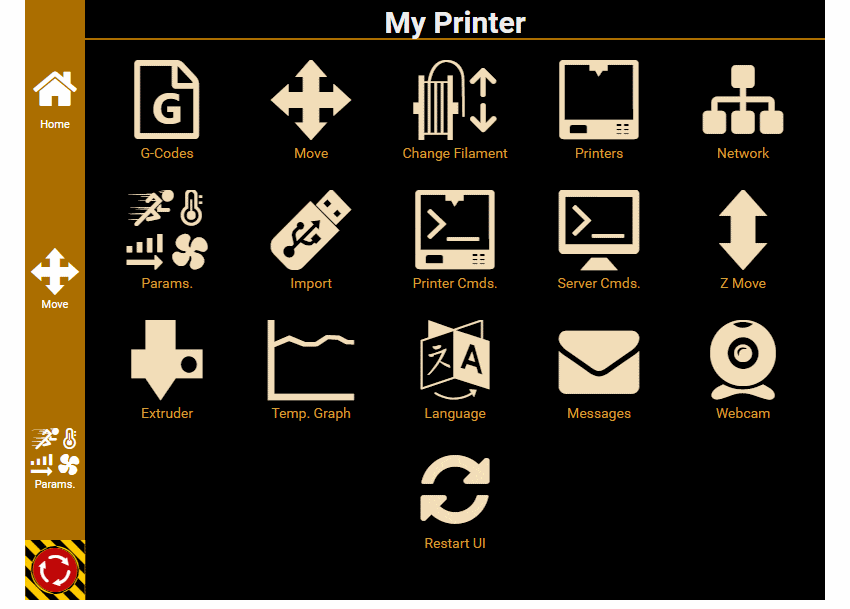

      You connect it over usb. And then send the Gcodes
      • T3P3Tonyundefined
        T3P3Tony administrators
        Then I assume it would work as RepRapFirmware can give the responses over USB that Marlin or Repetier expect, see:
        https://duet3d.com/wiki/G-code#M555:_Set_compatibility
        However does the server expect any special G-Codes that only Repetier uses?

          I mean i got a Repetier System a Marlin System and a Smoothieware System runing on it
            I don't know Repetier Server either. What function does it perform?
            • Danteundefined
              Dante
              Ever heared of Octoprint?
              Basicly it's a Standalone Printserver.
              You can slice over it. Manage the printer ( Settings etc. ) make Timelapse or Videos with a cam connected and so on.

                  I know that the Duet Wifi has a Webinterface etc.
                  But I muss the Cam Support.
                  That's why i would like to use Repetier Server. And a 17" Touch Screen.
                  I like the Touch Interface from Repetier and that you can controle more then one printer at once

                    From what you describe it will work with the DuetWifi and well 🙂
                    I know that for some people this is doubling up, but having a built in camera is nice.
