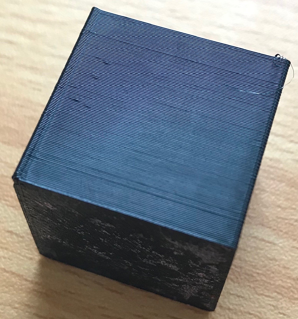

So today I have made the first print with Simplify3D old settings at 50mm/s , PETG, printing temp 230C, heated bed 70C, print fan is off(have a problem with it...) (except changed retract distance from 1.6 to 0.8 and switched off coasting and wiping). I have made just an initial setup of Duet3D and tuned up PID settings, set exact(measured at 1mm/s) steps for extruders.
I need your opinion about quality of that print(25mm cube) and what do I need to do next to improve printer quality please! And maybe some insights about acceleration/jerk settings..
My worst nightmare was to see Z-banding
And I don't see it at all!! )
Problems that I see and how I could :- retraction on layer change
- pressure advance
So what are my next steps ? non-linear extrusion and after that pressure advance? Or something before that is needed?

Anybody?
I suggest you try reducing the extrusion factor a little and enabling pressure advance.
So I need to lower extrusion factor by M221?

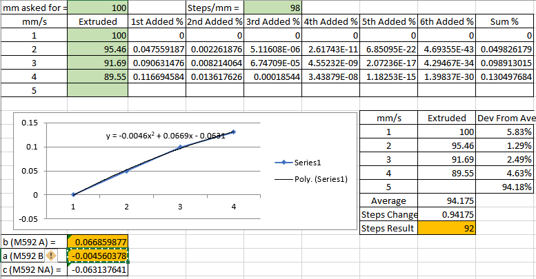

Right now I am calibrating non-linear extrusion and getting strange results on my MK10 extruder:
changed steps/mm to 98
so 1mm/s = 100mm of filament
2mm/s = 95.46
3mm/s = 91.69
4mm/s = 89.55
5mm/s = 54 ...
6mm/s = 44.4...But at 5 and 6 I don't hear skipping steps, but seems that I am skipping them.
So I've calculated A and B by 1 to 4 range and getting: A = 0.066859877 B = -0.004560378Is it ok to have B as negative?
It would be unusual for B to be negative, but as your B coefficient is so small anyway, you could use a straight line fit instead (B=0).
Remeasured:
1mm/s = 100
2mm/s = 98
3mm/s = 95
4mm/s = 90and recalculated : M592 D0 A0.000185 B0.00688
Strange again...
1mm/s = 100
2mm/s = 98
3mm/s = 108Very bad extruder gears?
@briskspirit said in First print after upgrading to Duet3d WiFi:
2mm/s = 95.46
3mm/s = 91.69
4mm/s = 89.55and then:
Remeasured:
1mm/s = 100
2mm/s = 98
3mm/s = 95
4mm/s = 90So not very consistent.
