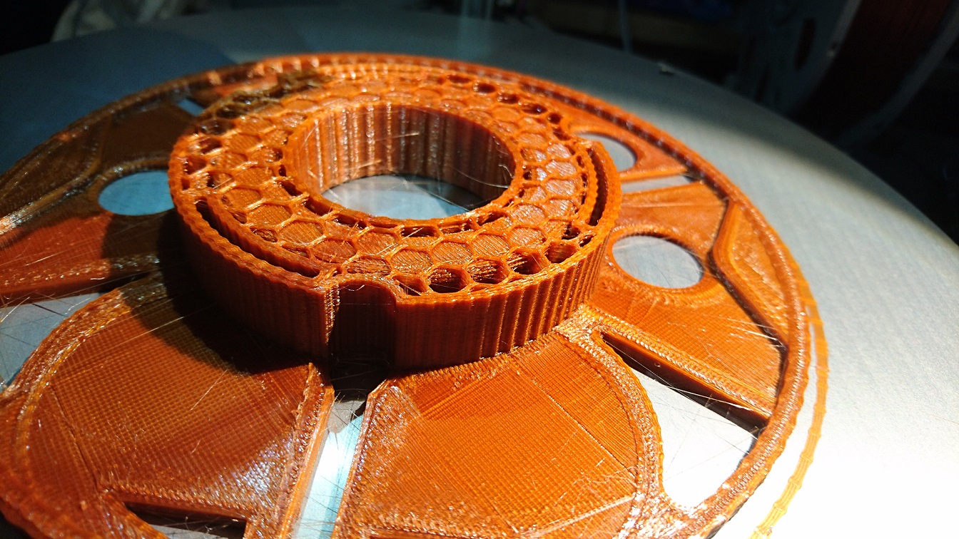

I've run into strange problems on my newly upgraded Kossel XL. Namely, arc movements come out very segmented. The files themselves are round, the gcode seems to follow the file (and it's all perfectly round when printed on another printer), but what comes out of the nozzle ends up like what you see in the picture. I've tried replacing extruder motors with 0.9 steppers, that alleviated the problem somewhat. But unfortunately 0.9 degree doesn't seem feasible with my switching extruders since I need to retract and unretract the filament very quickly.
Would appreciate any suggestions how to fix that. I'm running RRF 2.02RC4, here's the relevant bit from config.g

The STL files are the same for the parts printed with both printer? To me the segments look too large. That can be made finer when converting the file to an STL file.
Also which slicer are you using?
@timcurtis67 Yep, the stl files are the same. It's sliced with S3D, but the same problem persists with slic3r and Cura, with different models (like a circle with >200 segments). And Gcode files don't show the segmentation in the preview. So I think it has something to do with my settings or hardware.
Try increasing your XYZE jerk.

M566 X900 Y900 Z900 E900:900
Aren't they high enough? I use the same settings and I don't have cornered circles.
@phaedrux Tried to, even at 4000 mm/min it's still the segmented movement pattern.
I'm leaning towards mechanical issue. Is something loose or worn?
@phaedrux I assumed that as well at first since it manifested itself right after a hardware upgrade. As far as I was able to tell - no, all the linear rails move smoothly, I replaced the steppers with new ones and tightened all of the motor pulleys.
I've got no problems with sharp corners or straight lines, regardless of the orientation, which led me to assume it's a firmware/config problem - could have messed something up adjusting the machine for new dimensions and better rigidity.
Is it printing the circles smoothly, or jerkily? What speed are you printing them at?
@dc42 Jerkily. On the 1st layer I can see that instead of moving in smooth arks the print head makes jerky linear motions, with each corner ending up with a blob. The speed ranges from 20mm/s on the first layer to around 90 mm/s on subsequent ones.
Please post the GCode file you are trying to print on a file sharing site and post a link to it here.
Note, when printing GCode files generated by S3D it's normal to see jerky movements when the skirt is printed. This is because of a bug in S3D that generates short non-printing moves between printing moves. Fortunately it seems to do this only when generating the skirt.
@dc42 https://www.dropbox.com/s/t1fg19ojh7vo4d8/MasterSpool_V4_002_Export3_PARTA_RTP.gcode?dl=0 Here's the file that was being printed in the picture above. Unfortunately the behavior also persists when slicing with slic3r and Cura.
I'm printing your gcode file on my Kossel XL now. It's printing smoothly, but I can see that the model has been exported to STL with a large segment size, about 5mm.
What I suspect is happening is that it's not printing smoothly because of your acceleration or jerk settings. Because you are using a Bowden extruder with no pressure advance, this is causing over- and under-extrusion at different places in each segment.
So the first thing to do is to check your speed, acceleration, jerk and pressure advance settings. To verify them, send the following commands without parameters through the GCode Console:

@dc42 Thanks a lot for the help - I replaced the config file with the one you provided and switched to a Zesty Nimble to eliminate extruder issues, but the problem still persists.
Which I guess means it's probably something to do with my kinematic hardware, so at least now I get a vague idea where to look.
