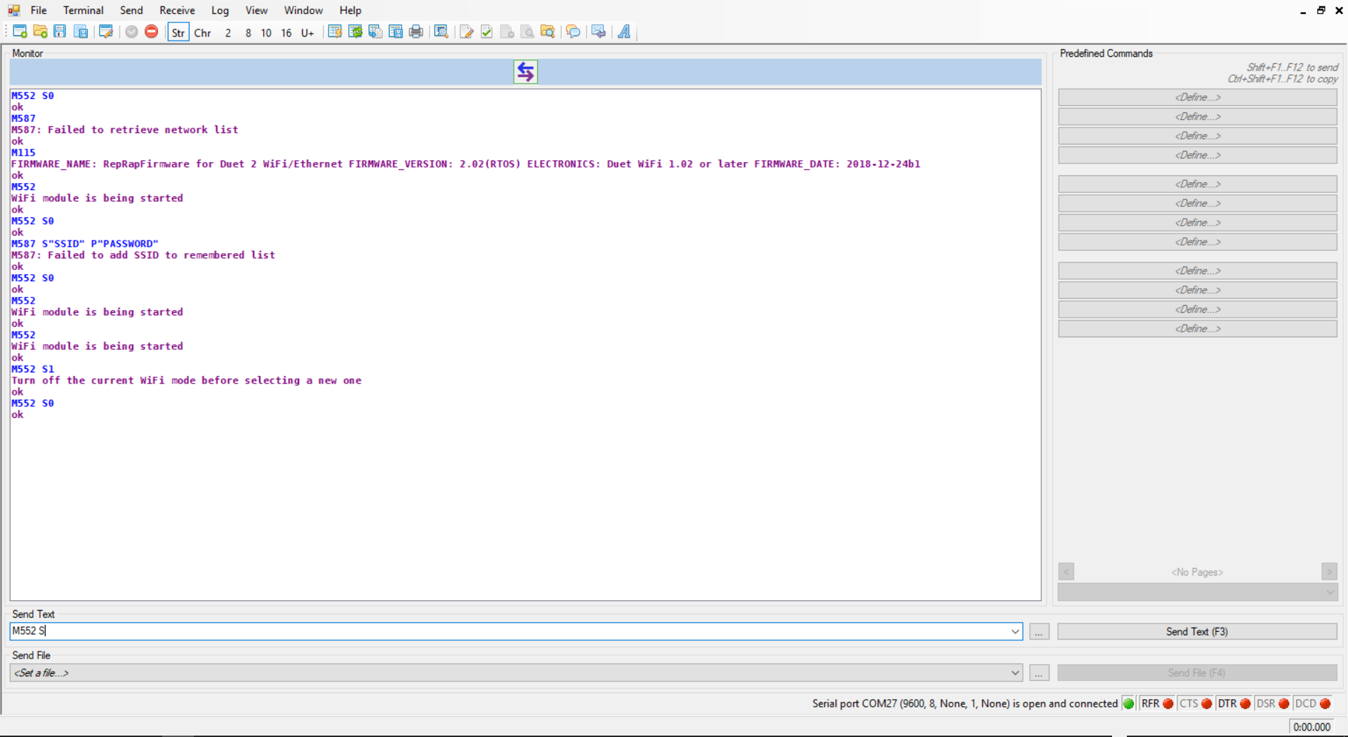

              Having the same problem. M552 says Module is being started. Have switch to different firmwares, updated wifi firmware, and still fails to start. It will not store ssid information, and an M552 S1 says Turn off the current WiFi mode before selecting a new one
              M552 S0 says ok, Been at this for days and cannot get it to connect. I only get a single blue flash on WIFI led on power up. I get blue lights flashing when uploading WIFI firmware.

                  I am back to trying the 2.02 (RTOS) I put these on a blank sd card along with the WIfiServer-1.22bin. Extracted Webcontrol to WWW folder. I sent a M997 S0, then a M997 S1. Said upload complete.

                      0_1553098284978_YAT - [[Terminal1] - COM27 - Open - Connected] 3_20_2019 10_10_43 AM.png
                      This is after Uploading Wifiserver-1.22.bin
                        dc42 administrators @S_Mabe
                        @s_mabe said in Duet WiFi always starting and will not connect to WiFi:
                        By "Uploading", I presume you mean that you copied it to the SD card in a PC, because WiFi is not working. After you copied it to the SD card, did you rename it to exactly DuetWiFiServer.bin, deleting the existing file of the same name first?

                          Yes I took off the -1.22 from the file so it was identical to the one I removed, and uploaded, I guess I mean flashed with an M997 S1 command using Yat.

                            The date it displays for the wifi firm is identical to the WifiServer-1.22.bin file when sending an M115 command.

                              0_1553100539075_YAT - [[Terminal1] - COM27 - Open - Connected] 3_20_2019 10_48_40 AM.png
                              And still just get this

                                Would it be better to erase the board and try it all over? I have tried original sd for stock, to updating the the wifi firm, to trying a fresh sd card with different firmwares from 2.0-2.03 betas and it always returns the same on these commands. I never get an idle message.
                                  I don't think that will help. It looks like either there is a communication failure between the WiFi module and the Duet main processor, or the wifi firmware failed to upload, or the wifi firmware you are installing is corrupt. Please try downloading and installing the wifi firmware here https://www.dropbox.com/s/gkb6rulcayiqjcm/DuetWiFiServer.bin?dl=0.
                                  Is your Duet still under warranty?

                                    I just bought it from Filastruder. Finally got the rest of the stuff needed and have begun to set it up. I bought it Febuary 28th, so I think I am still in the return window. Seems everything else works. I have not connected any heaters yet, but the motors are running properly, and controllable from the Panel due. Config changes are working. Had to reverse some motors. Just no wifi.
                                    I have checked it after putting the different firms and it returns as 2.03 or whatever I flash to it. The wifi module lights up when flashing firm.
                                    • S_Mabeundefined
                                      S_Mabe
                                      Tried that firmware and does the same thing.
                                        It's time to ask Filastruder to replace your Duet then.
