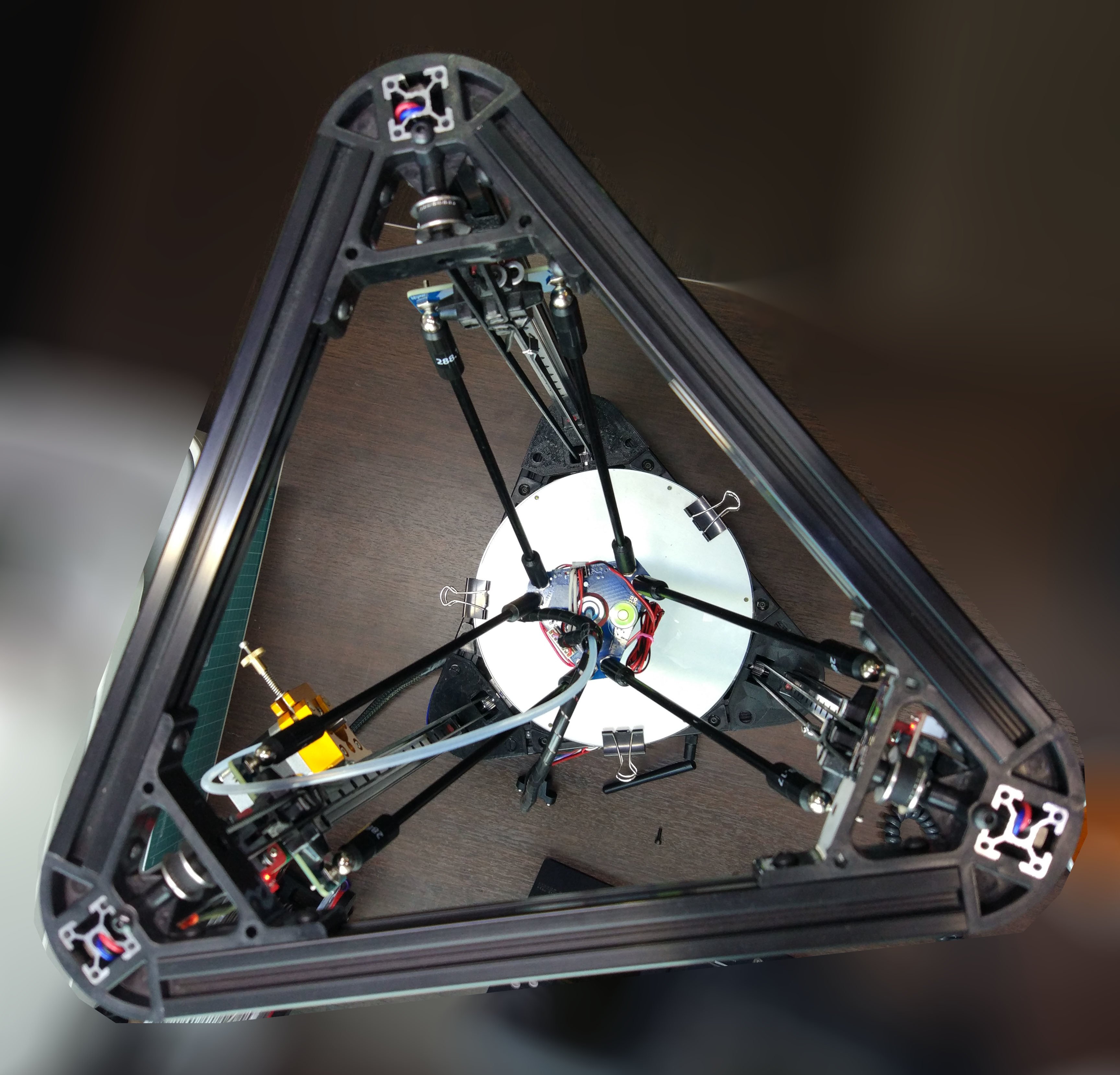

      Hello!
      Recently i bought a geetech 301 with a bad control board. after my wonderful experiences with the duet on my Tronxy X5S i decided to get another one.
      turns out i dont know squat about how to wire or program a delta. i have also purchased the smart effector and carbon rods and mag ball set.
      My first question is how are the motors to be wired? what denotes X, Y, and Z?
      ive got it to the point where i can zero it to the end stops. but moving the print head seems to be opposite the way its supposed to work. when moving x or Y, on carriage moves while the others stay stationary. that seems reverse from the way ive seen them move.

          The convention for delta is that top tower is Z, left is X and right is Y. That should save you time from getting mirrored prints.

                X -> front left
                Y -> front right
                Z -> center back
                If you do so, the X/Y (cartesian)plane is right. X0 Y0 in the center of the bed. +X to the right and +Y to the back. If you wire another way, you get rotation of the plane or mirrored prints.

                    @AndreS welp, as it zeros a little smoother i still cant move in any real direction with out the effector twisting and popping the rods off the towers.
                    • B3N
                      B3N last edited by
                      Ok, im an idiot..... after reading the Smart effector install guide for the 5th time. it occurred to me in a photo that i had the rods installed wrong. i had connected the rods to each point in the triangle. i.e. right next to each other instead of spaced equally each rod next to its neighbor rod. like in this picture....
                      right, it travels smooth now. all directions travel as expected. thanks for all your help and suggestions. as always this is an excellent forum and the duet is a great piece of hardware!
