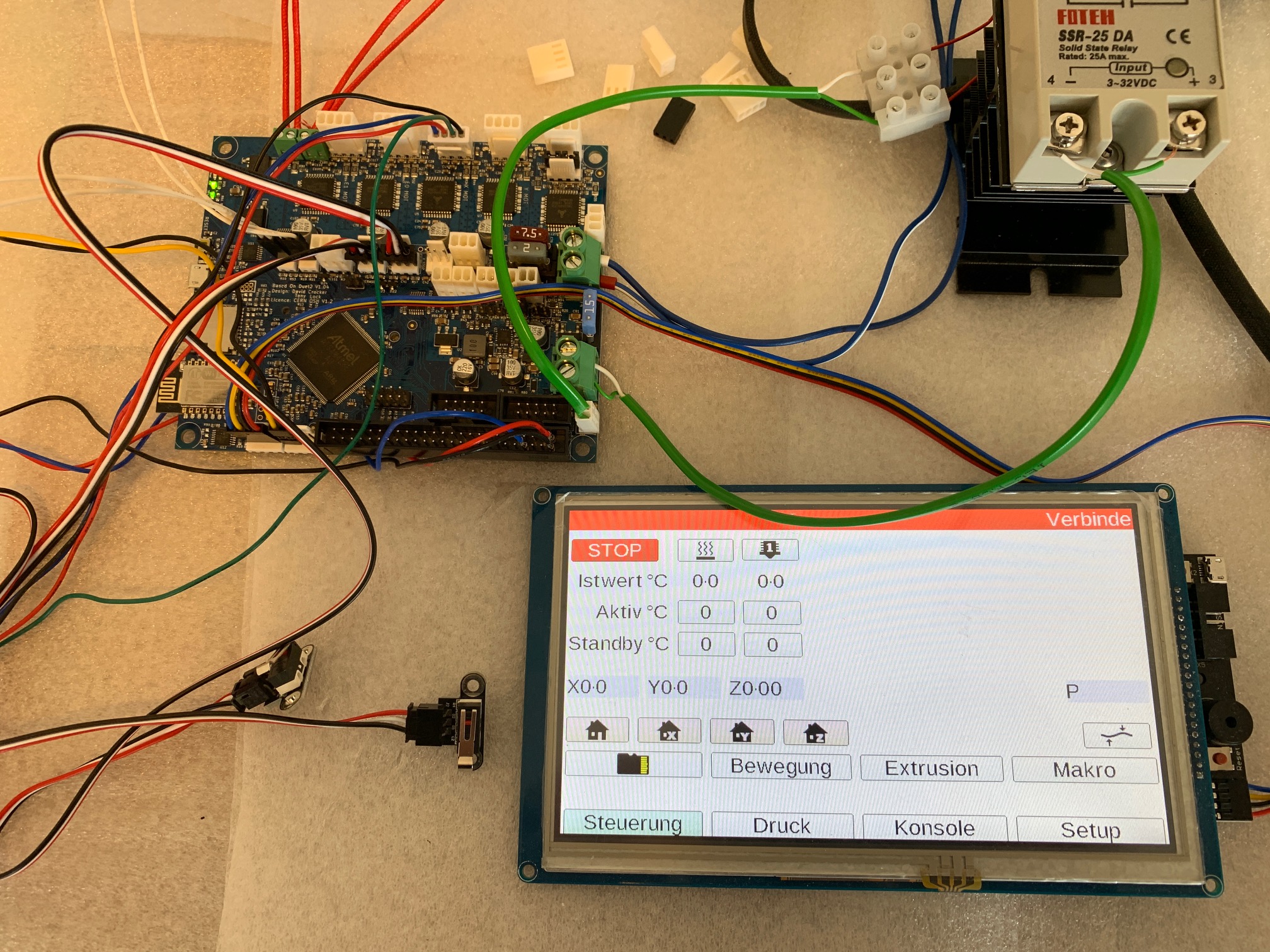

    hello,
    now i have a small prob. with the wirering of those mechanikal Endstop.
    i have read the "https://duet3d.dozuki.com/Wiki/Connecting_endstop_switches#Section_Duet_endstop_inputs"
    but i´m not sure which one are the right.
    if i conect the endstop like on the picture the Duet Bord don´t boot and the paneldue has no config.
    If i press both endstops at the same time, the board boot and connect to wifi and works

      update !!!
      i think i can see a LED
      it´s now wirering like a Makerbot Mechanical Endstop
        Try connecting the red wire to the centre pin on the Duet endstop connector, the white wire to the STP pin, and the black wire to the GND pin.
